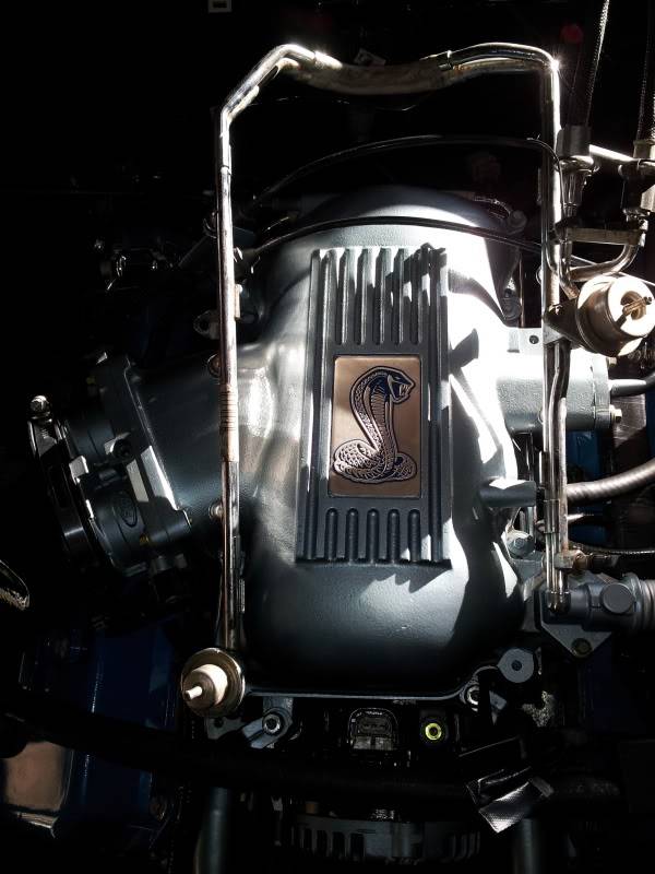

Out with the old...

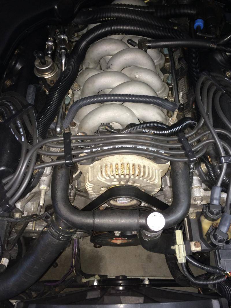

Out with the old...

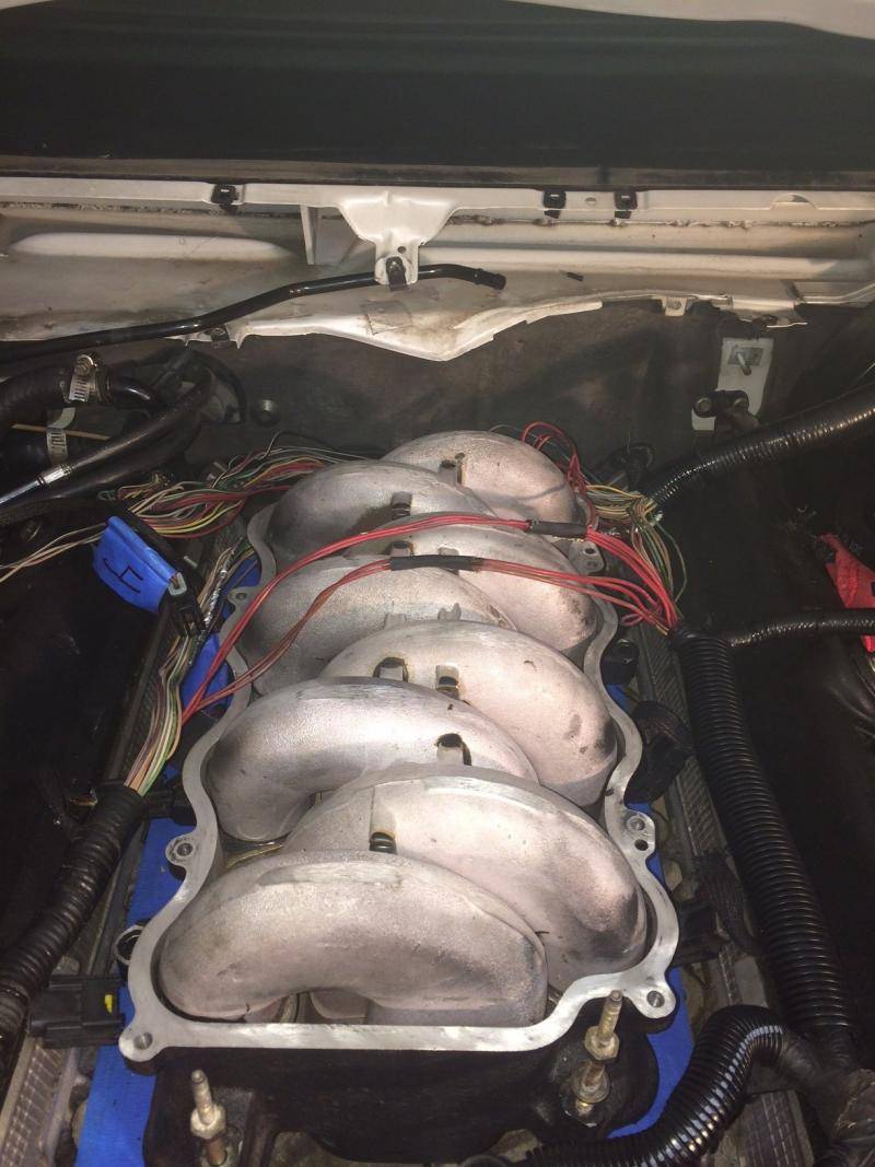

... and in with the new...
Think it'll work? :confused:

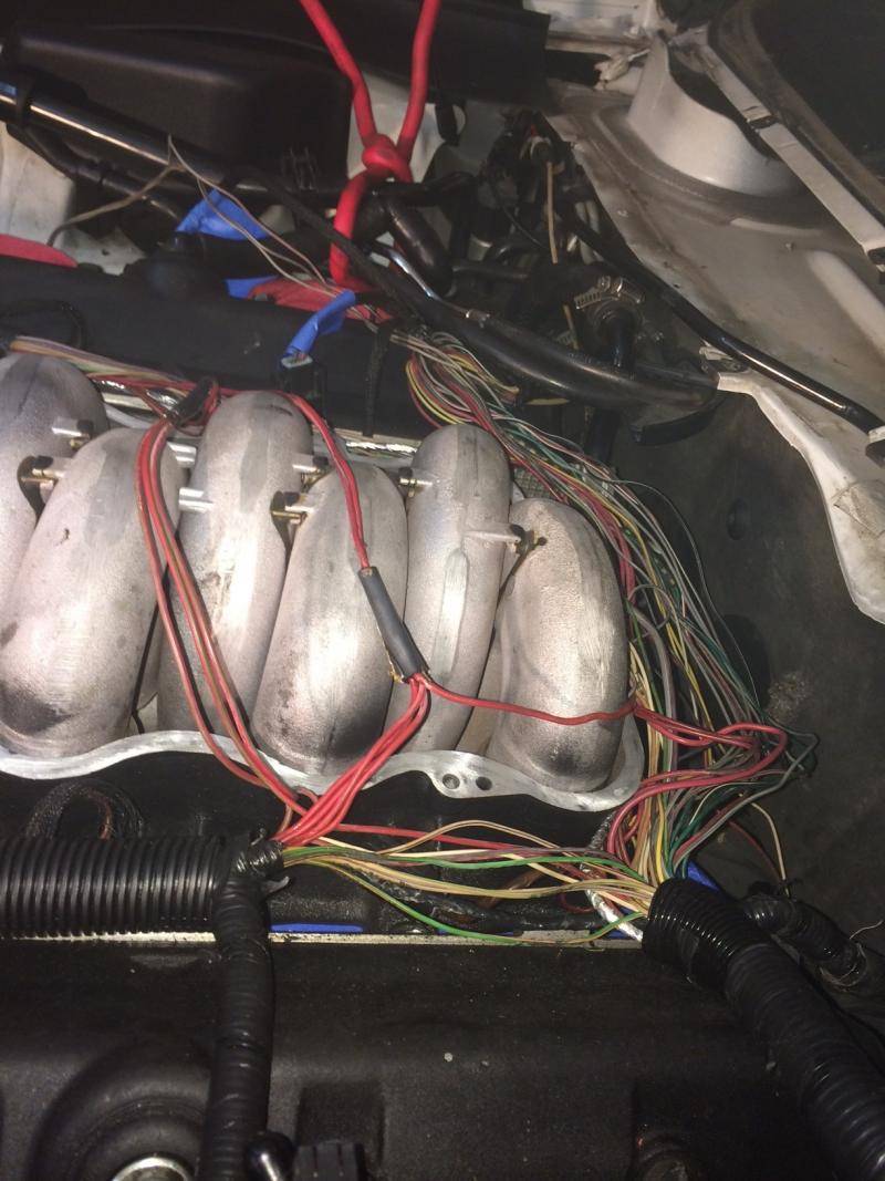

That old white-ish loom needs to go too :)
Sure it'll work.. What ya gonna do about the hood clearance?
I assume you've got the Cobra Fuel Rails.. You'll also need the Cobra IAC

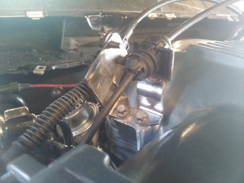

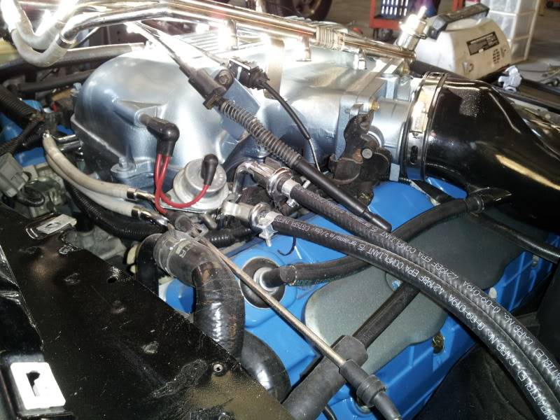

Relocate the C.C.Module to behind the LF wheel and make a wiring extension if you plan on having Cruise. and fab up a bracket for both cables. I made my bracket from pieces of the Mark VIII bracket and 2 of the bolt downs from the stock MarkVIII fuel rail. So mine have little Ford stamps on it
Made this for where the EGR should be (I deleted mine) for the Booster Vac feed
Also, now is the perfect time to replace that annoying little coolant hose thats under the Intake
It should work just fine. That is a B Head Cobra intake so my understanding of it all is that it is a "simple" swap of components. Perhaps a little relocating here & there of some items as well.
I'm looking to do the same later in Spring as I recently purchased a '97 intake "kit" myself for the BA. I kind of want to toss it in the K4 but that one has too many toys in it already that maybe I oughta spoil the BA.
I've been lurking here & other related websites for insight on the swap and have came across various ways to go about it and am not certain which route to go.
What are you employing for the intake tube? I'm not certain if I should go with the OEM '97 tube or an aftermarket like BBK or JLT from AmericanMuscle.
Are you planning on modifying or upgrading anything else(injectors, tune, EGR delete etc.)?
Yes, besides rerouting the IACV, TPS and IAT, the wiring will be behind the intake.
This car has the cowl hood, no problems there.

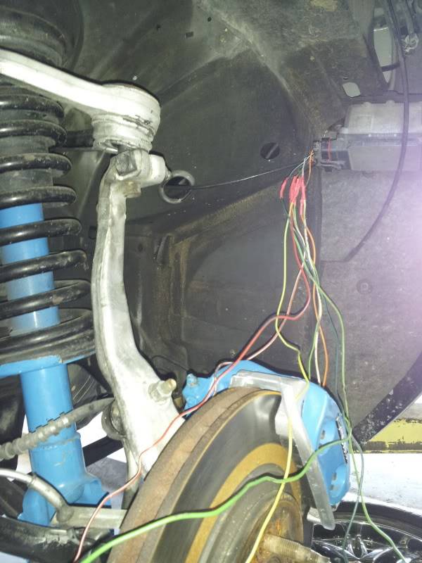

Not sure what direction I'll go on the fuel rails just yet. I think I have a set of Cobra fuel rails in storage. I also have a pair of Aeromotive aftermarket fuel rails and FPR if I want to get creative.

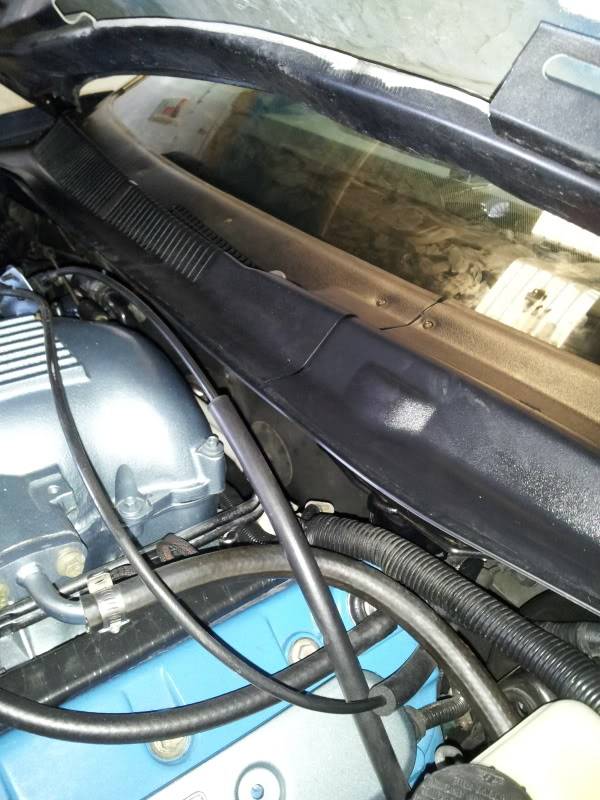

I was thinking of modifying the stock bracket vs. overpaying for a Cobra throttle cable/bracket.
You can't use the Mark VIII IACV? I wonder if anyone has used a remote IACV?
The cruise control relocation is on the list, just not the short list.
Just for preventative measures or is there something I'm missing?
I plan to use the Cobra throttle body and intake tube adapted to the stock MAF.
The EGR is already gone. I'll probably stay with the stock injectors for now. I'm on the fence about using IMRC deletes since it may have mild boost in the future. I plan to stay with the stock ignition for now at least but may do a COP conversion in the future.
It will definitely be tuned. I have the SCT PRP tuning package to work with.
Coolant hose is a prevention measure because you'll have to remove the intake to replace later.
If you've got a welder, making the cable bracket is a snap and you'll use the existing cables.
The stock Mark fuel rails FPR would sit directly under the Cobra EGR placement, so that's a no-go.
Here's one of the CC relocation
Had a scrap Mark, so I cut all of its wiring to have the same colors.. I'm anal like that
As far as the IACV, I can't remember why the MarkVIII wouldn't work, but I never tried, my Cobra intake came with one

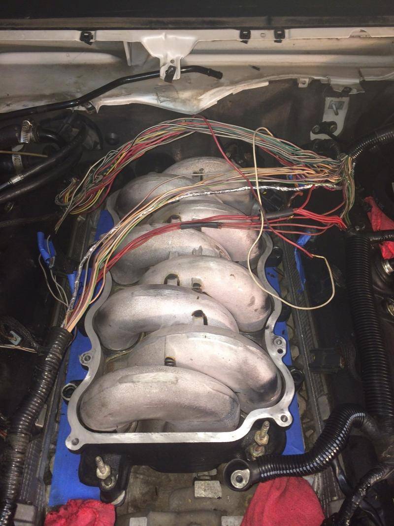

Looks like it'll be sweet after you re-route the harness. Love the powder coating on the intake.
If you are changing the harness around for those other sensors, now would be the time to do the COP swap, it's pretty simple really!

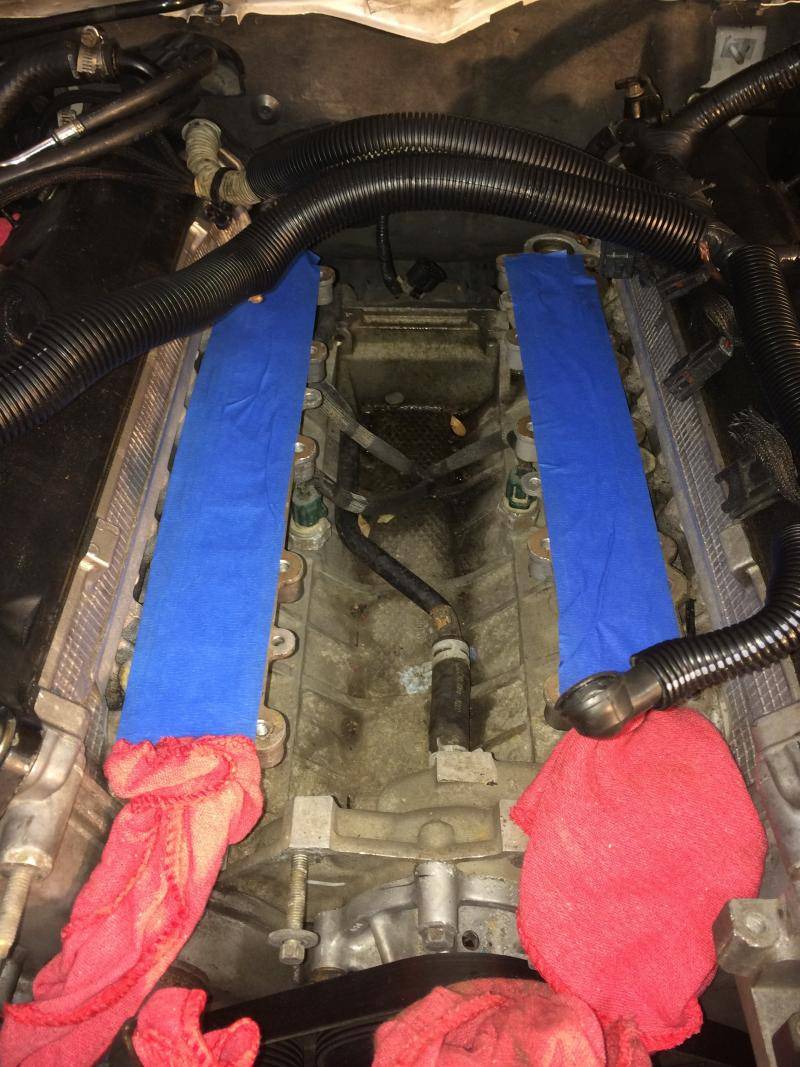

yep im doing the same thing except Im using orange masking tape to cover my heads. lol
