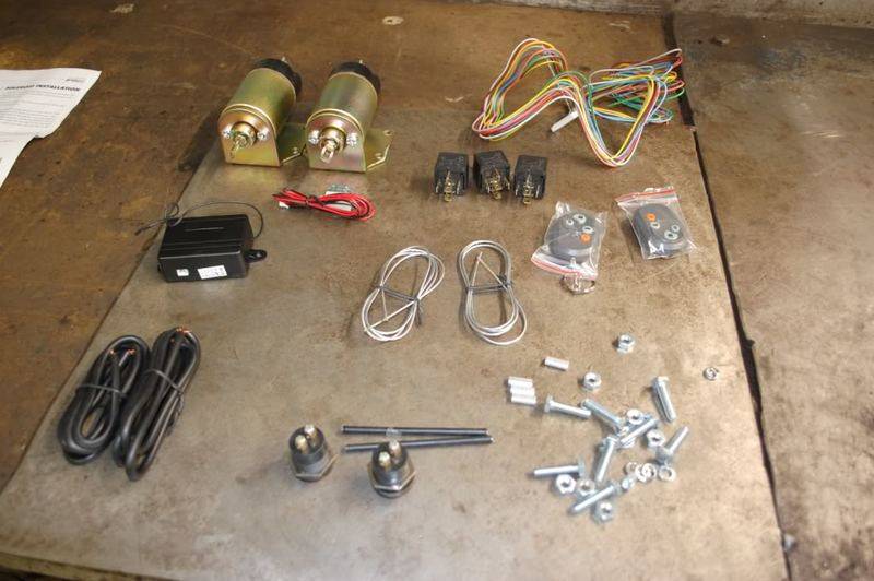

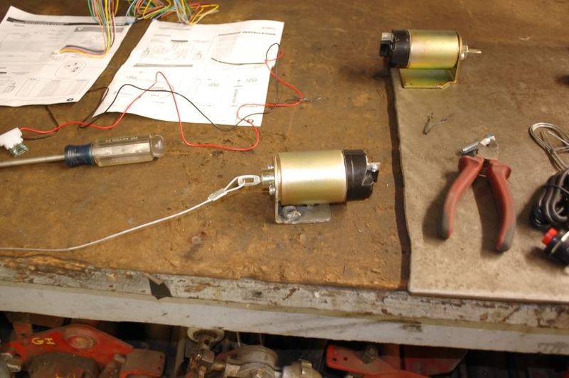

So I open the box to this..

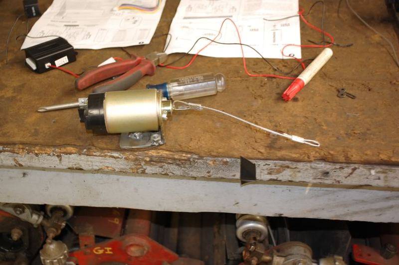

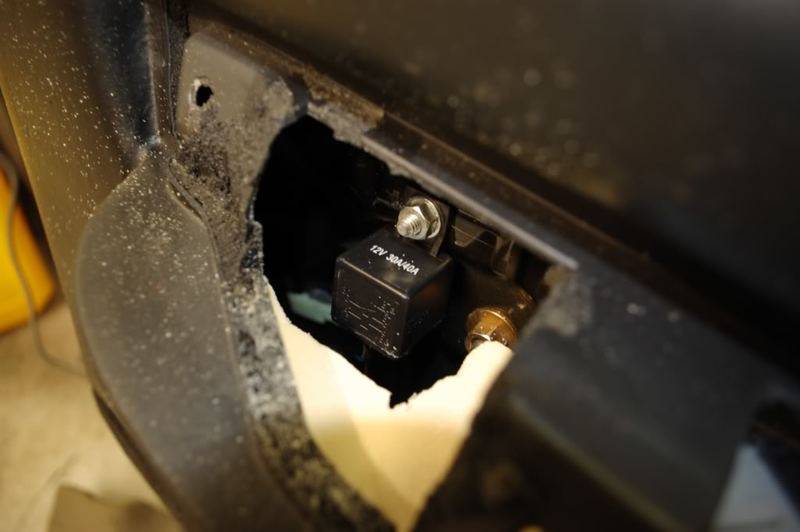

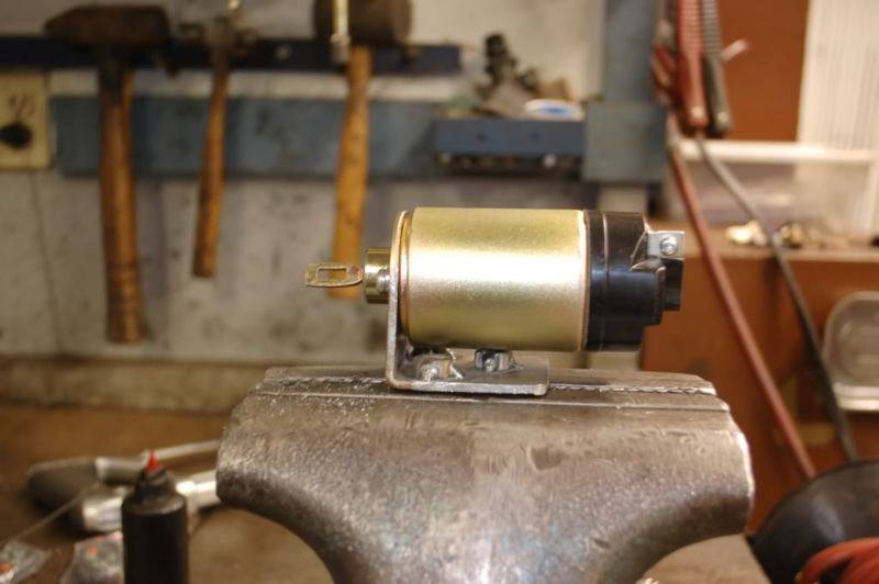

Just jam the solenoid down here...

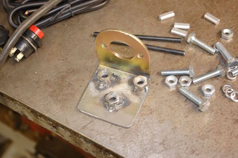

Welded some nuts on the bracket.

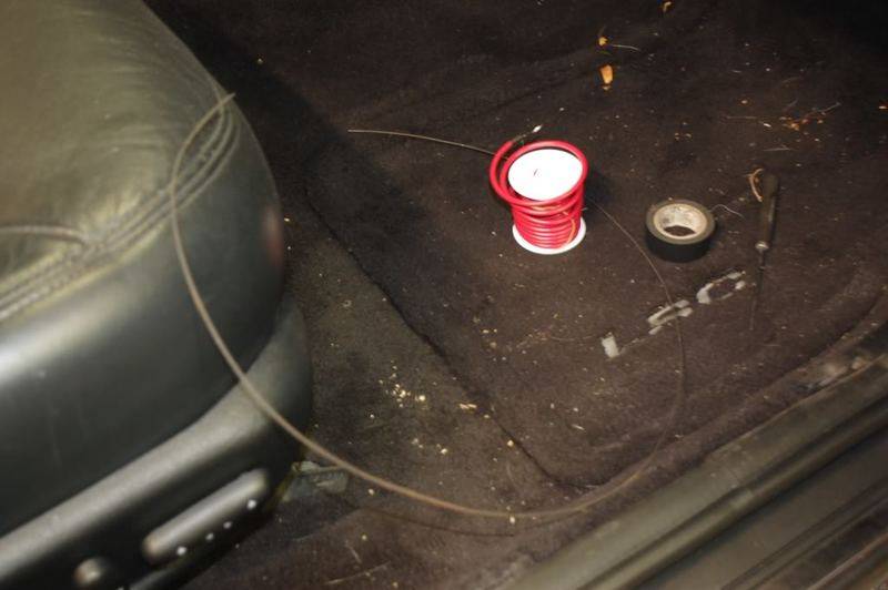

Then I hooked the cable to one end so I and see how it will pull.

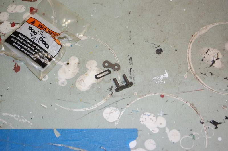

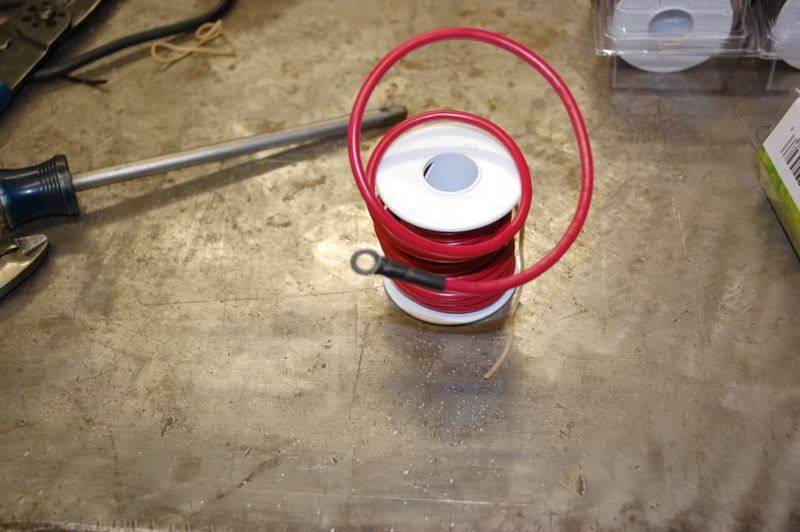

Measure it out and crimp the other end, I used a chain link to hook it up to the door latch.

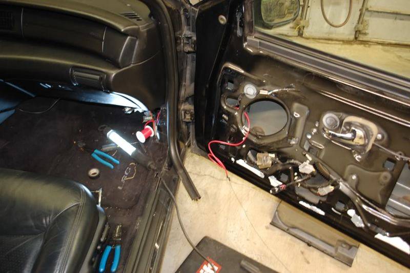

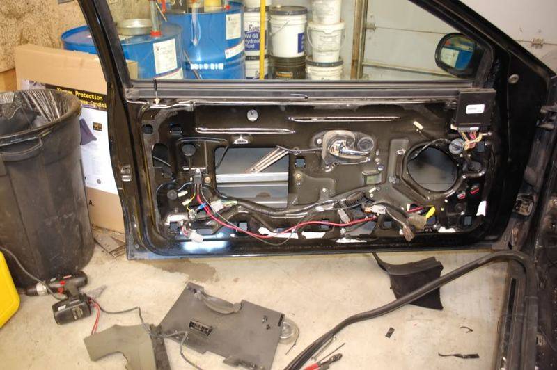

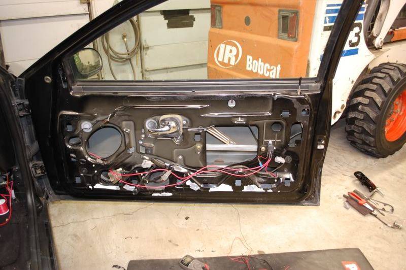

Well that was the easy part... the wiring, that was fun!

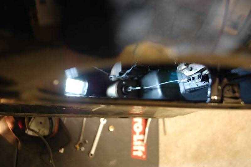

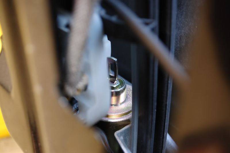

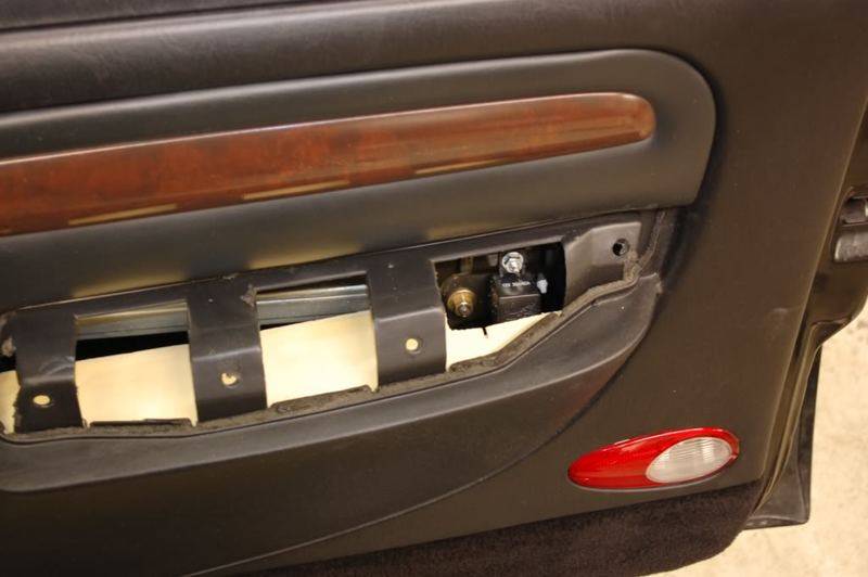

After all the wires are pulled through the door the next step is to mount the solenoid. Just had to shave away a little foam to make room for it.

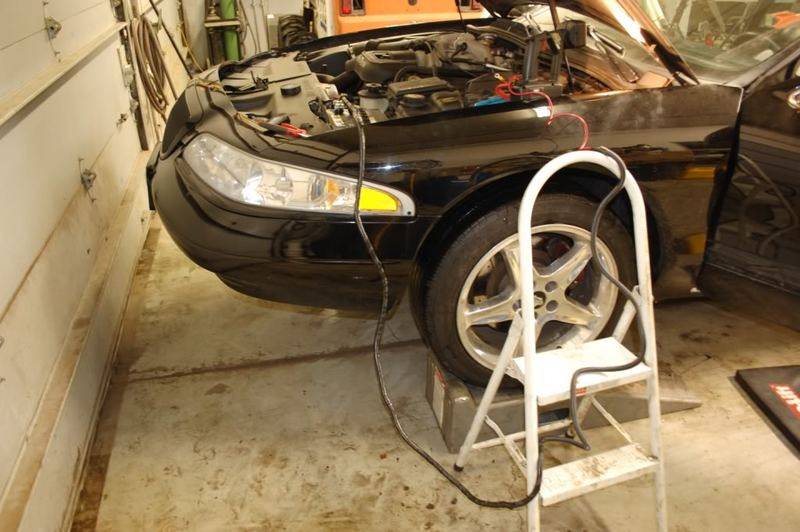

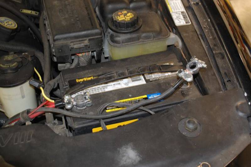

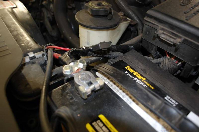

I cut off the :q:q:q:qty stock battery clamps for some better ones and I attached a new power to the positive side for the door handles.

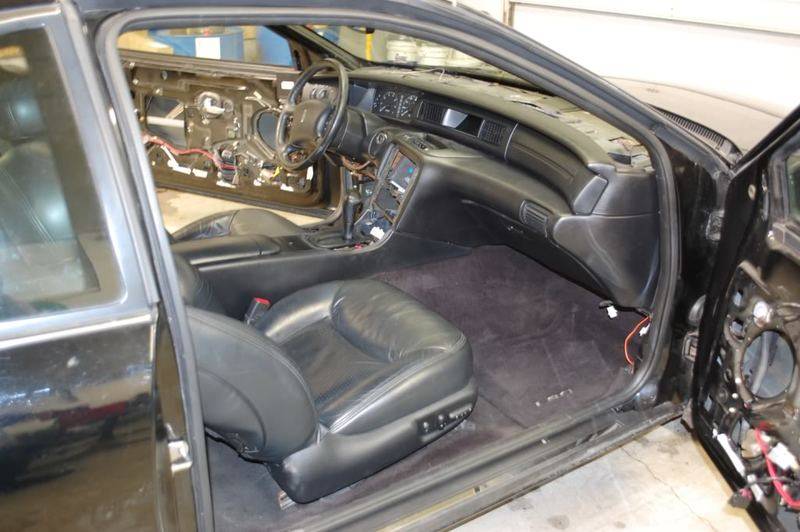

Wire up both doors.

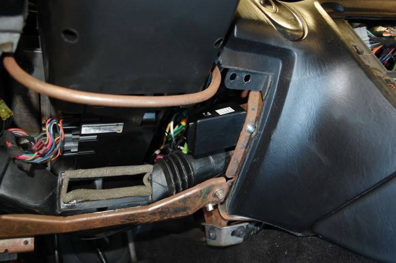

Mount the receiver and finish up the last few wires and its all done!

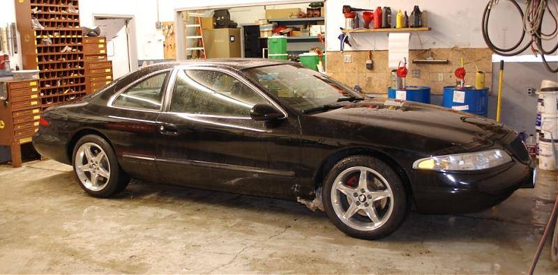

I vacuumed out the car as it was getting pretty dirty from all the work...
