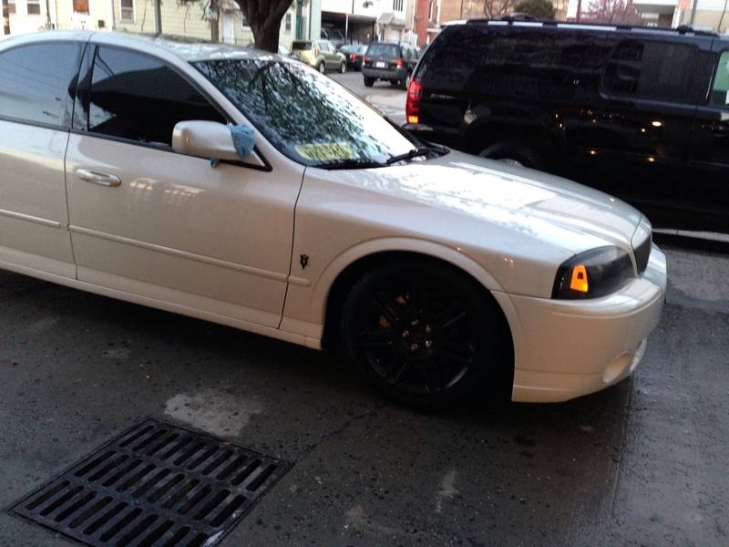

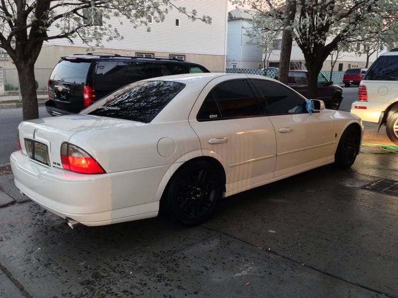

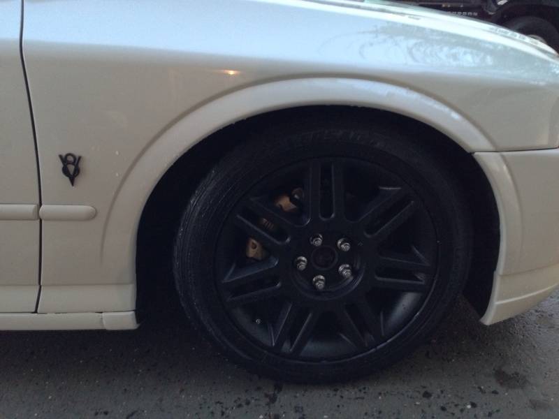

This is the 2nd time I dipped my winter wheels. My first attempt lasted the entire winter with only a tiny amount of peeling around some spoke edges (due to washing technique and thin application - user error). The T-Bird wheels have 21 spokes so they are tough to paint evenly in between each and every spoke.
My second time painting them (pic is top of this page), I did a much better job, plus added glossifier. Zero peeling and epic durability in winter, and it's been very cold for a few weeks. I am even debating doing my summer wheels as the blacked-out look is starting to grow on me :cool:

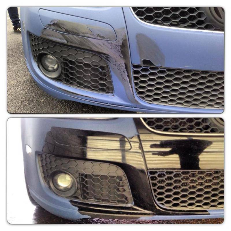

Do we all realize that vinyl wrapping was critizised just as much when it was first catching on? I also think glossifier would possibly make a good bra on the car and on the mirrors. Here is a shot that shows protection of the paint after a fender bender.

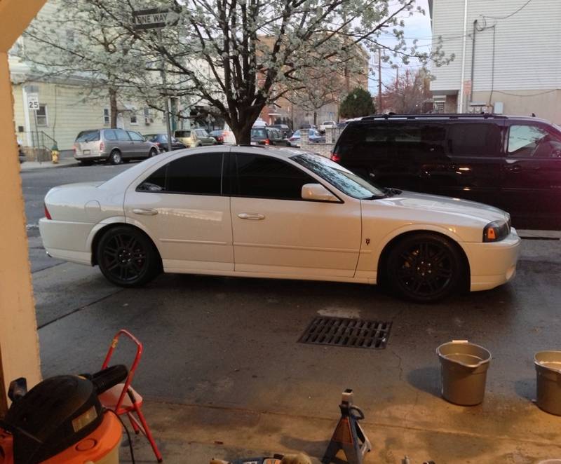

Cop look (winter mode) FTW. The looks I get are funny at times.
But I much prefer Plasti-Dip w/ Glossifier. Easier to clean and looks better.
