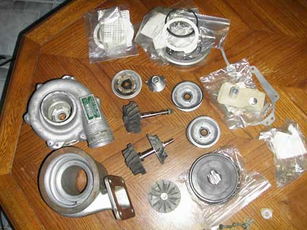

im going 4.30 gears most likely (thats what we put in newer mustangs and they work really well) but mines a manual tranny. gonna stuff a new diff in the rear. you can buy an sts universal turbo kit on thier website. main problems are going to be extending the mass air because its a blow through setup. extend the fuel delivery(boost a pump, injectors). the kits are exspensive, i have an old school rayjay turbo that we recently got all new pieces for. once my car has seen some road time the way it is now(and is finally tuned) and we get the rearend done, and hopefully i can get rid of one of my other cars we can start with fabbing on my turbo kit. shooting for about 6-8 psi right now i finally got my emissions done but we havent started tuning. the tune it had sucked and threw tons of codes. my ported heads outflowed the stocks by almost 30%. im gonna try tuning it without the intake runner control also and see what happens if anything. the tuning will be done on the street so it will be a bit before i post any numbers
