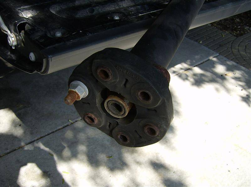

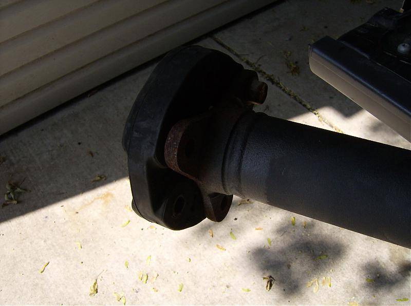

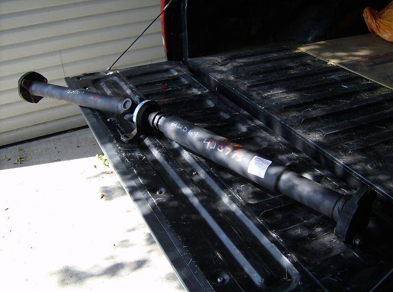

The driveshaft was the hold up. The LS driveshaft is a little different than the norm. But as I researched I found it to have similar pilot bushing style flange design and flex couplers as the new GTOs, BMWs, Supras... A average shaft shop doesn't have the equipment to work on it, balance it etc. A shop around here said they could at first and then chickened out when they saw it. Just as well as I wouldn't want to be their first. I had to send it to NC where "The Driveshaft Shop" is to get the needed modification done. This wasted some time but its done balanced and went out today so I'll have it some time next week. Then ILLS and I have to match schedules to do the install as hes gonna do the welding for me on the pinion brace. That and hes doing his next so we will likely fab 2 pinion braces up right away.
:rolleyes: silly LS driveshaft :rolleyes:
