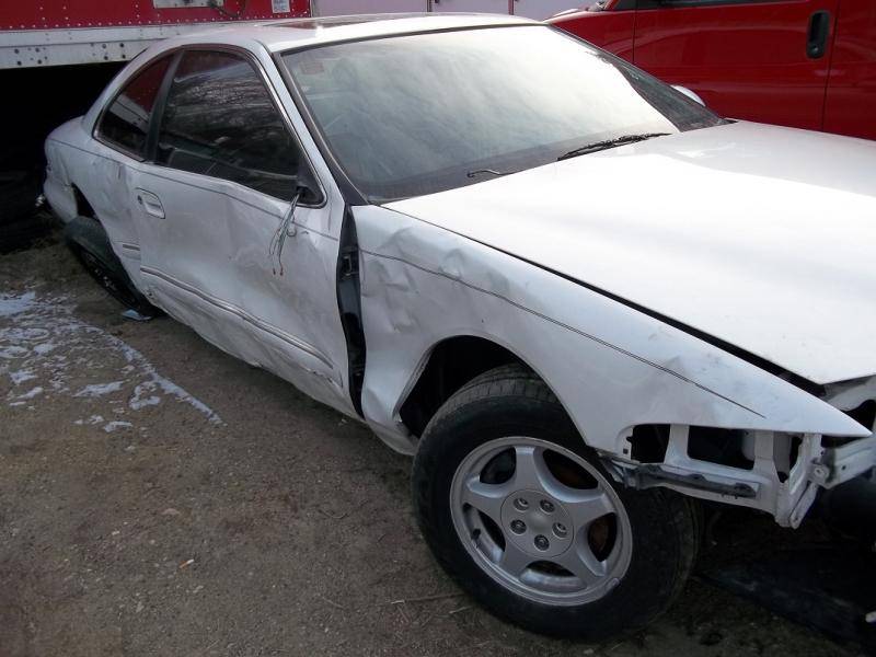

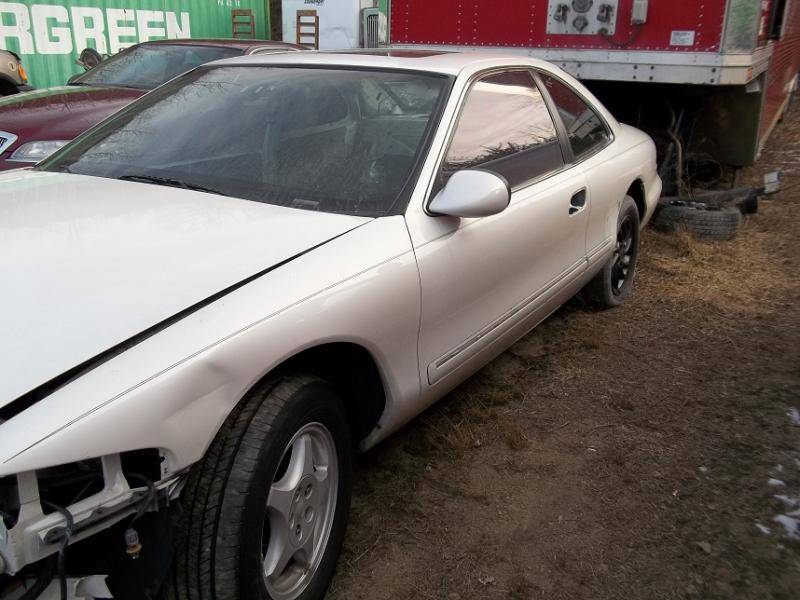

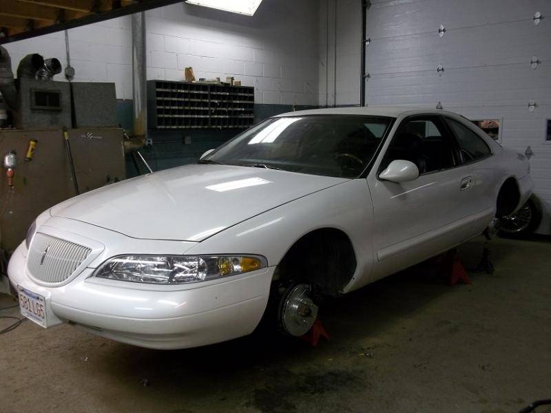

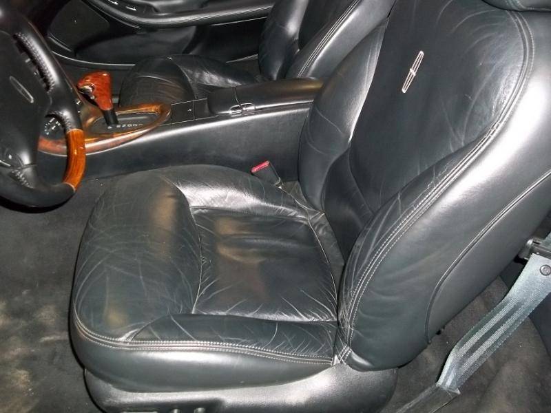

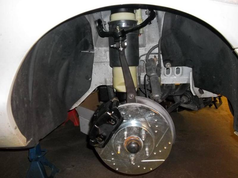

    I know how you people enjoy picture progress threads, so I figured I would give it a try. A customer of mine has a 97 LSC, Opalescent with a Light Graphite interior. He loves the car, but hated the interior color. He wanted an Ebony interior and asked me to find one and change it over for him. A little looking and found a wrecked 97 in NJ with a nice interior, so off we go and 600 miles later we have a donor car. Here is also a picture of his car. It came from Texas with 43,000 miles and is completely rust free. Quite a difference compared to the New England cars I am used to.

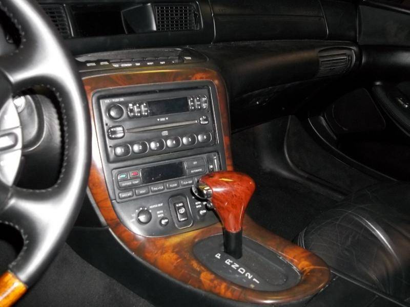

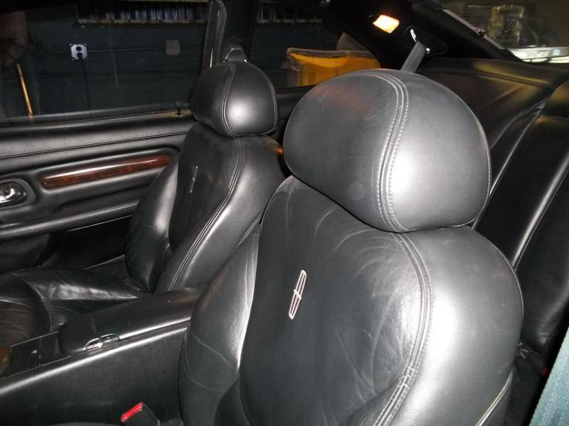

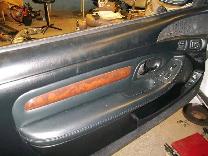

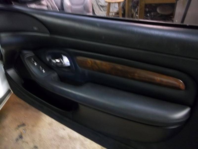

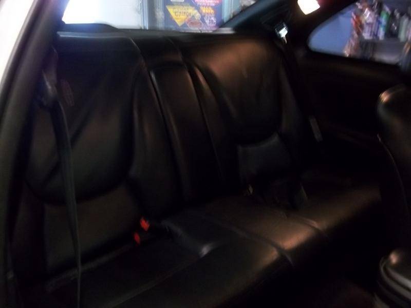

    After stripping the donor and then his car, installed the interior in his car piece by piece. Over a year ago I scrapped a CE and sold him the steering wheel and shift knob. It was now a perfect time to install them. I have a guy that repairs and dyes leather for me, so he came down and dyed the steering wheel Black. It was also a good time to put John Temples white face gauges in. What a quality product, about the fifth I have done.

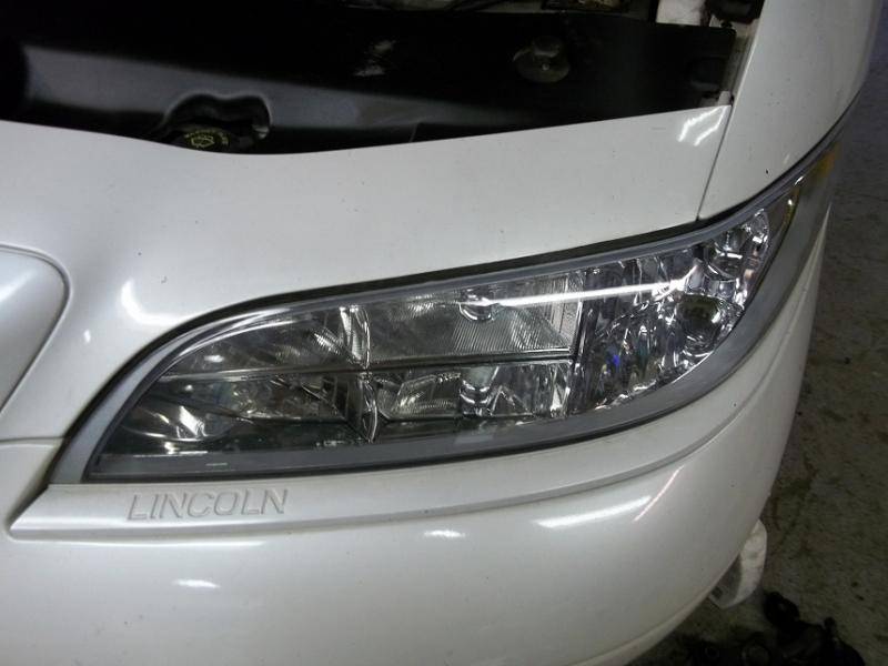

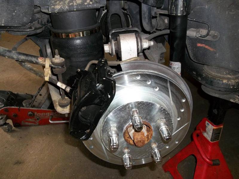

    When my customer saw his car he was so happy he let me loose to attack the rest of the car. I replaced all 4 airbags with new, drilled and slotted rotors with ceramic pads, complete new Moog/TRW frontend pieces and powdercoated evap tray. Also removed, resealed and polished the headlights so she looks like a Mark should.

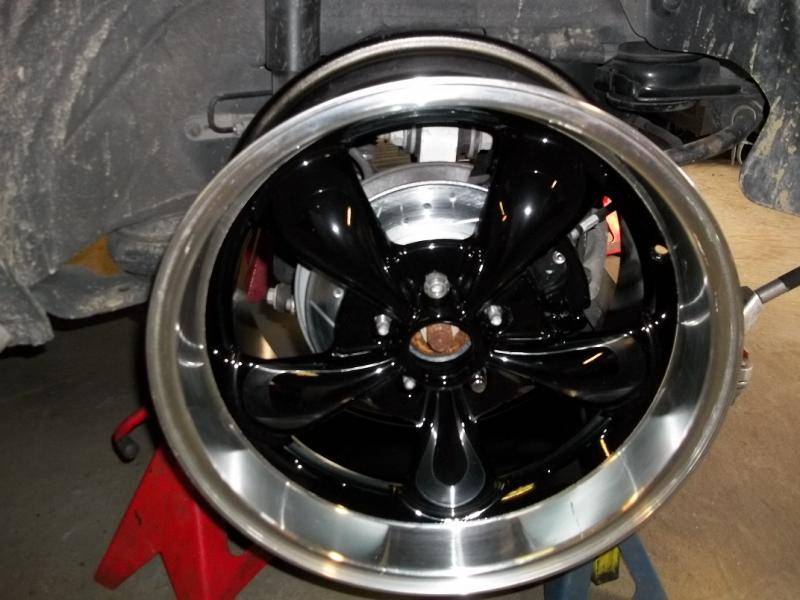

    Next time the owner showed he had a new challenge for me. He had a complete set of Bullet wheels he had purchased with 275 rears and 245 fronts. The only problem was he did not like the gunmetal gray spokes so here we go again. Dismounted the tires and took the wheels to my powdercoat guy to color the spokes black. He was right, they do look better. Now due to the size of the 275's I had to cut the rear quarter lips away about half an inch and put a thinner piece of trim moulding at the seams.

    Next up is just maintainence items. Plugs, filters, Mobil I, belt tensioner and idler pulley. After that I am installing a Mandrell Bend exhaust with x-pipe and 2 Magnaflows. Will have more pictures at that point if you are still interested. Thanx Bruce

    I take it that Mark is already hub swapped? Those wheels look lik 5 X4.5 bolt pattern.

    I got the shocks from Amazon, best deal on the net. And no Greg, the wheels are 4.25 bc, direct fit. Thanx Bruce

    What brand are the wheels?

    Bruce I know you told me you 'd be working on something nice but I didn't know it was this nice. By the way, where did you find those wheels in our lug pattern?

    Not sure where he got them Alex, will ask next time he shows up. He showed up with them in the back of his Range Rover with a set of Cooper zeon (I think) tires and some of the strangest flush mount (recessed) valve stems I have ever seen ! There was a script R on the hubcaps if that means anything to anybody. Covered those with Temples speedstar covers. Thanx Bruce

    I think they were the ones from Custom Wheel Shop. I was looking at those in the grey last year for my green Mark. The hidden valve stem kit is strange looking.
