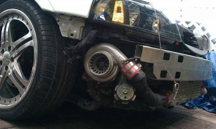

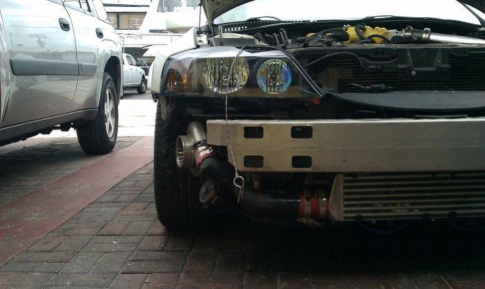

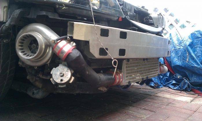

Or atleast buy a filter and rig something up
at a bare minimum, i would get some material to go over the inlet, any small particles will wear the hell out of the turb and will carve the sh!t out of the cylinder walls and rings, that ten thousand you've got into her wont take too long to double.
You can even just get a knn rectangular filters, cut it up slightly larger than the inlet and wrap it around. Whats 25 bucks when you already have 10k into the turbo alone.
Yeah thats what i would do better safe than sorry.
Showed Brett, the guy making the turbo kit, your turbo build, says it's similar to his design, he wanted me to tell you good job on it.
If you were to go on the turbo forum and do some searching regarding mesh and filters you'll do yourself some good. Mesh done improperly is terribly restrictive, and the right filter much less so.

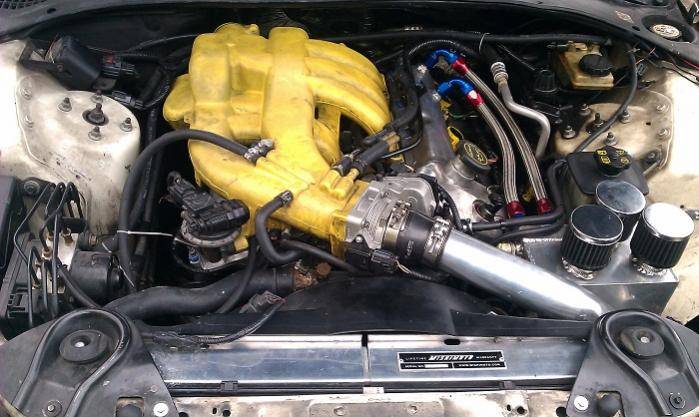

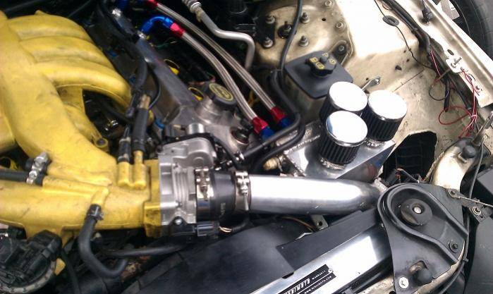

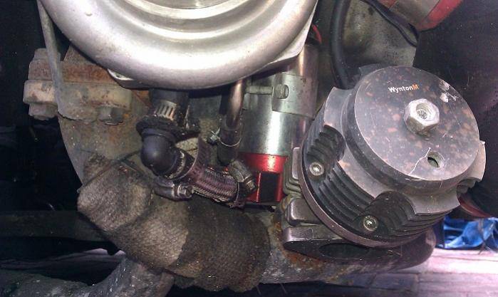

some more piks and yea i got the ideal from the guy with the gen 1 v6 manual trany turbo ls BIG thanks to him
holy triple stack Batman, that is one crazy catch can!
so....um...................
what kind of pressure are ya seeing with her
