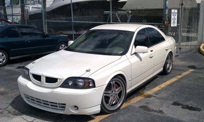

Nice work, build it yourself? 10k! wow, that's a lot of cash, but dropping money into the is addicting, trying to turn it into a beast. When are you getting a tune for it? Dyno it yet?

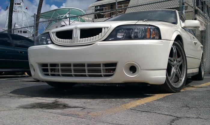

No offense, but it look like your ls got it's 2 front teeth knocked out with that grille. :lol:
well im getting tuned from sct try to get money for that now and yea my grill is staying like that till i get my hands on the mclaren grill

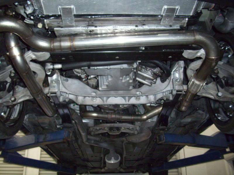

how did you route the exhaust pipe from the manifold to the snail?

yea dont spent your time on those ebay turbos they suck i frist started with a t3/t4 and like 3 months later the seals when out and i started smoking out the exhaust ,and plus those ebay kit are universal you still have to get everything custom made , this is how i did my pipe route .......
this is how
That picture looks familiar....
If I did a turbo I wouldn't want to put it in the fender like that, where's your air filter? I'd go rear mount but then you're getting all the dirt off the road in your filter because the tire's are stirring it up. I'd want to go with twin tiny turbos that would fit where the cats are so I'd have quick spool up. If I went turbo than money wouldn't be an issue because I'd go all out. This is why I'll probably never turbo my LS, but the thought is always there.
The filter is behind the wheel well guard, not expose right in front of the tire
