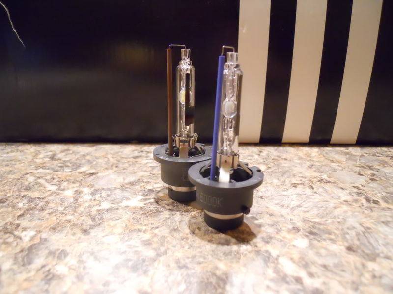

How about a couple shots comparing the bulbs. It's hard for me to get this camera to focus correctly to include both of them, I've got a lot to learn if I ever get a good one but this one will suffice.
Morimoto 6000k D2R
Philips 85126 OEM D2R. I believe this may be a factory bulb.
A couple side-by-sides. Philips in rearmost bulb, Morimot frontmost bulb.

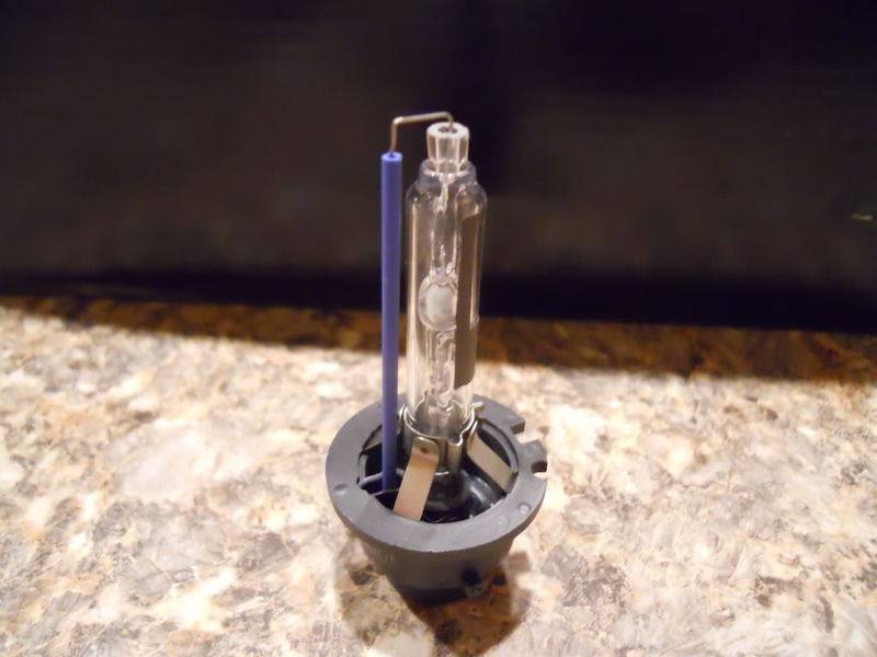

If I didn't know any better, both bulbs were new, both bulbs had the same color insulator, and both bulbs were unmarked, it would be hard to tell which one's which. Wish I had a mew Philips D2R bulb to compare. The yellow coating the inside of the globe of the Philips bulb is the salt deposit from use. I've read that all HID bulbs will have this after they've been used. Either after you use them or when you pull them outta the box from testing, this deposit will be there.
Overall I think this is a pretty solid bulb so far when compared side by side. The only physical difference, which I don't think is a big deal, is that wire/insulator was not almost perfectly straight on the Morimoto, where the Philips was almost dead nuts upright. Also, the material used on the alignment clips, at least that's what I'll call them, seems to be of higher quality on the Philips bulb; they shine more.

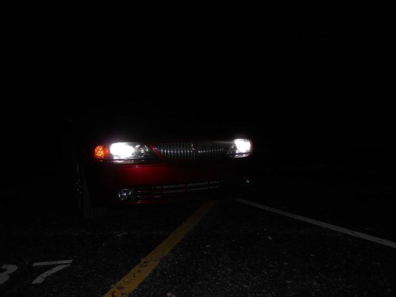

To start, I started this at 10pm and finished around 11:30 with pics and what not. I had minimal amount of tools and I'm not thrilled to find out that in two places the plastic broke off where the threaded clips for the housings attach. Should have been plastic clip on metal not metal clip on plastic. Anywho, I got one side buttoned up and took some side by side comparisons.

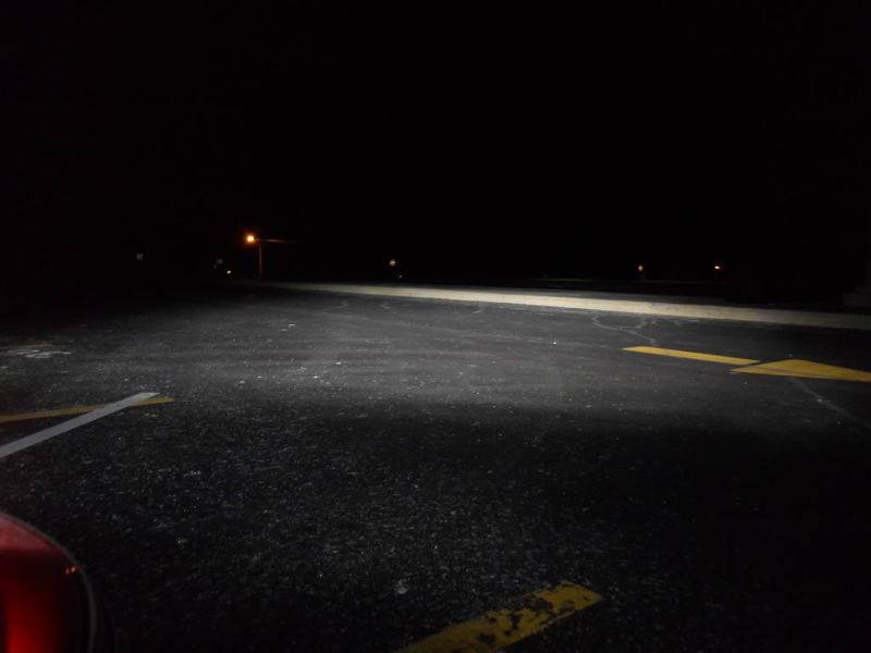

The driver's side is the Morimoto 6000k D2R, the passenger side is the Philips 4300K D2R (Assuming it's an 85126 bulb like the one I removed) with almost a year of use under it's belt so it's more than likely color shifted closer to 5000k. I'm no expert but I'm thinking that because these are reflector housings rather than projectors, that a desirable solid cut-off line is almost impossible. I'm not that picky but the crisp look of a solid cut-off line would be uber cool!
From the center of the dash in my lovely garage. I have to hold my breath to squeeze in there sometimes to get in my car.

I need to tinker with some settings to see if I can pick up just the light without the glaring affect.
With the light against the wall it's easy to decipher between the color temp, 4300k vs. 6000k. I drove it around the block, which is lighted, and it's hard to distinguish on the road from driving the car; oncoming cars might say otherwise. There's a difference but with all the other lights interfering it's difficult to see the night and day difference but it is there.
After this I'm convinced that these bulbs so far are legitimate. I don't have a flicker in the bulb, although I think that's more of a ballast issue, and it fired right up with the Philips replacement. I'm excited to have the whiter light with the a blue hue to it and I don't expect any problems with the other bulbs. With that said the only thing that I think would be left to compare between these D2R bulbs would be the longevity, most important, and color shift after prolonged use. Hoping when I put the other one in tomorrow that I can salvage the plastic that the clips attach to.

I like the color of the light but looks like you had to sacrifice quite a bit of output.

I definitely noticed the decrease in light output. It was more noticeable sitting in the car facing out of my garage. 6000k side was considerably more dim than the stock side. I'll sacrifice a little performance to sport this look. If I would have run a modified D2S at 6000k I could have got a skosche more output without the shield at the expense of oncoming drivers and headlight glare. They also off the bulb in 4300k and 5000k as well.

Besides the apparent decrease in light output, it looks like the Morimotos have a cutoff that isn't as good as on the OEMs. IIRC, they should burn in after a few hours of use and get brighter, will need side by side comparisons again.
The cut-off is not perfect on either of them but I noticed, and you can definitely see it in the pic the cut off is not the same across the wall. The Morimoto is close, but no cigarello.

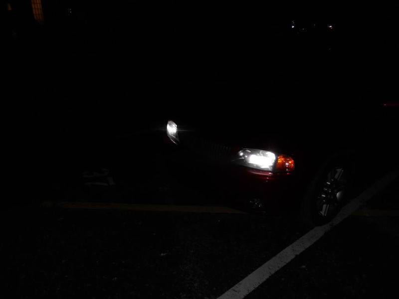

Got the other side in today and I'm really digging the whiter light. Still scouting places to mount ballasts and relays. I think these are the best pics I can get without picking up the glare from the lights. So far everything is going good. I hope the rest of this can go as smoothly as replacing a couple bulbs.
