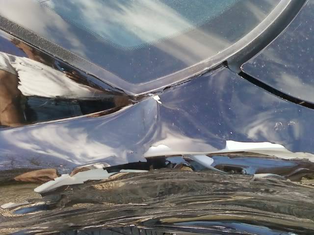

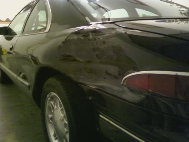

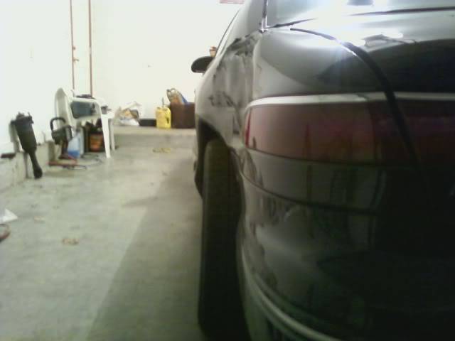

I should have went to Pizza Hut, but no, I wanted a steak for dinner! Almost took the 57. That SOB would be dead right now if I had! Almost hit him in his cock sucker when he said, "The damage aint so bad"! Hell, most his teeth were gone already, I'll take out the rest for him. Looked like a meth head. At least he had insurance.
My guess is it will get totaled. Back glass has to come out to fix the quarter and the seal is toast on it. Just missed the wheel/tire but the rear is making a growling noise.
I'll post better pics tomorrow when there is daylight.

You'll get the money to get it fixed. From what I'm seeing, it doesn't look like a total, depending on that grinding noise you're hearing which might just be something just got pushed in and rubbing. If you have the glass swapped out, they'll do it right there in your yard and only charge you for labor. Mine was done in the driveway last year on the 94. You have black and you seen all my painting threads with the black one. I'd try to get a big check without totaling it. Strike that deal with the body man.
Have the glass, removed, have both towed to the body shop, swap out quarter panels, paint and blend, have the other glass put in and go home and put the rear bumper cover on, unless it needs to be painted too.
Thats the plan I'm hoping for. Bumper cover has color on it just needs clear.

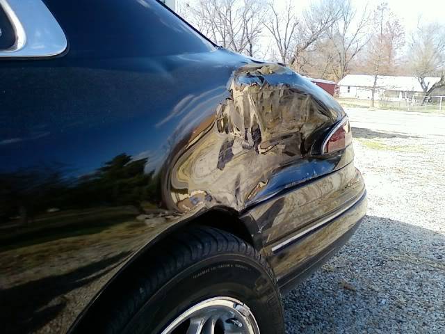

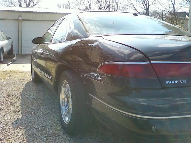

Got a better look at things today. The growl I hear is the muffler rubbing against the lower part of inner rear quarter. No damage to suspension! Got lucky with idiot missing tire/wheel. Hit me so hard it poped the air ride switch out of the mount and unplugged it. Here are a few better pics.
Have you looked underneath the car? From a front vew, that rear frame has got to be pushed over some.
