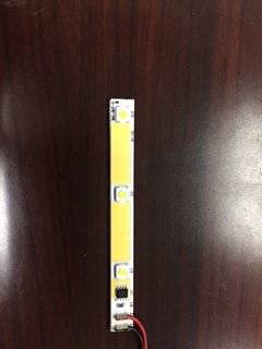

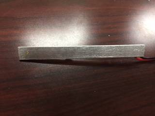

The work you are involved with on these Light Emitting Diodes ... they run hot enough to require aluminum radiators? Just wondering the capacity of it.

...The work you are involved with on these Light Emitting Diodes ... they run hot enough to require aluminum radiators? ...
Some do, like the ones shown below, even though they are fairly low power (1/4 W). The back of the PCB is aluminum. I have recently designed some replacements to work with copper radiator (cheaper than aluminum).
