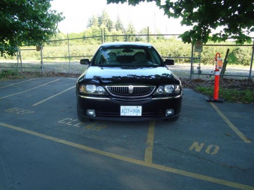

Long time lurker on here and have owned a 05 LS for about a year and a half now. Purchased it with about 170,000 km's off for $2,900 canadian dollars... Heres a picture of it the day I bought it.

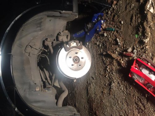

First on the list was the brakes. I did them at night in my back alley.

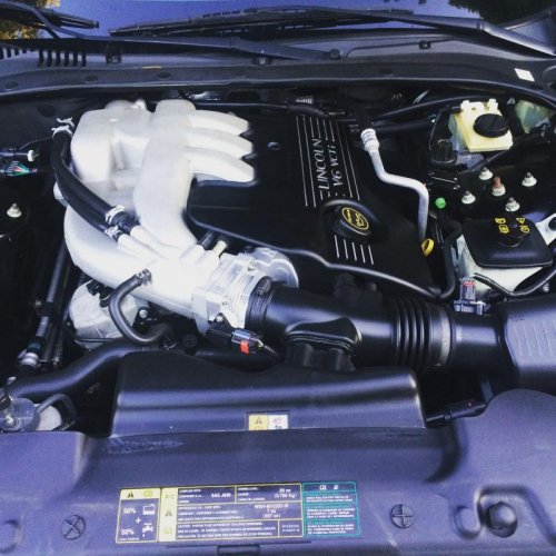

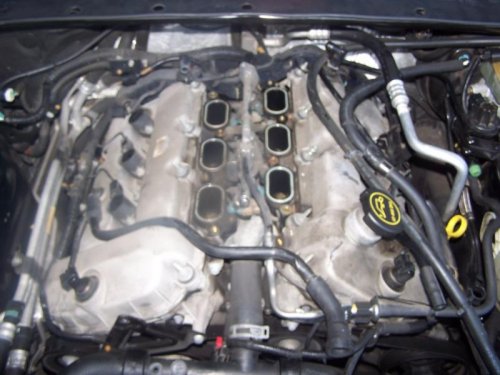

Not too long after I did the brakes I noticed some misfires so I went and purchased 6 new coils,plugs,valve cover gaskets(felpro),pcv, air filter,fuel filter,cabin air filter, all Motorcraft of course. This was going to be the first time doing any major work on my LS. Poor design makes the coil and plug job a bit harder than the v8. I needed to remove the intake to get at the passenger side coil bank.
Got it all back together with in a couple days. It wasnt nearly as hard as I thought it would be. Heres a shot of everything back together and after I washed the engine and cleaned it up.

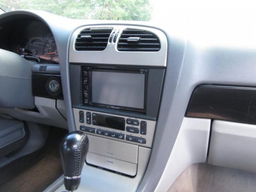

After doing all that work the car felt great to drive so I rewarded my self with a double din dvd player

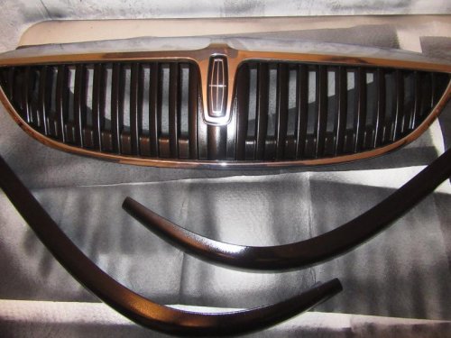

I wanted to somewhat "colormatch" my grill and chrome trim on the bumpers. Turned out great.

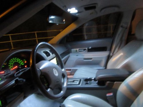

I ordered some LEDs from ebay and swapped out the interior lights and license plate lights as well. They look amazing.

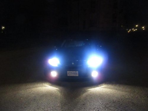

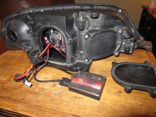

I ordered some HIDs off ebay until I get some nice stock HIDs.

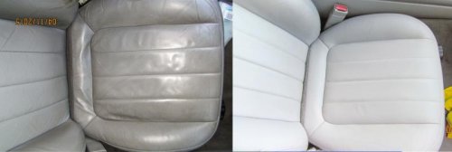

I steamed and super cleaned my interior. Looks like a completely different color now.

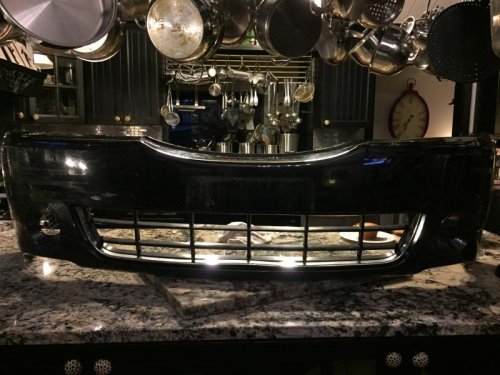

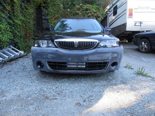

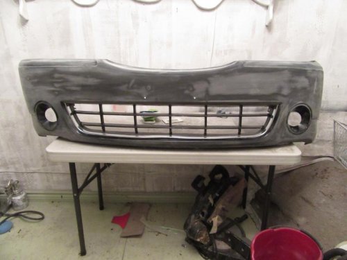

I prefer the LSE/06 bumper over the one i have so when one came up for sale I bought it with minor damage. Still need to prime and paint/gloss.
Heres me pretending to have a 06

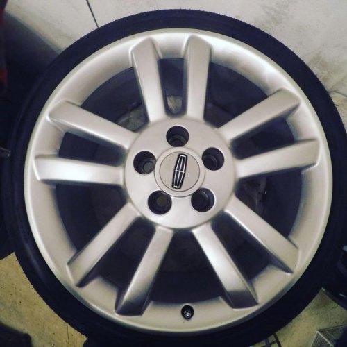

This brings me to about a week and a half ago when I came across these 19 inch Jaguar Performance Wheels off craigslist.
Paid $300 canadian for them. Waiting for the snow to go away before I throw them on. REALLY happy wth these.

Why do you call the intake a poor design? Where else are the dual-intake runners supposed to go? To get the proper length there would need to be a bulge in the hood. The V6 is based on the V6 used in the Taurus/Sable since 1996. The runners have been "over" one bank of Ford's V6's since at least 1986; I'm not sure of how any other manufacturer does it.
its a poor design because you need to remove the intake off the car to get at the 3 coils... i dont care how long its been lkle that. its a terrible design and one reason why eventually I will be buying a 06 and putting everything from this car on it.
Just curious, how would you have done it better (on this V6, with the runner control, and such that it fits the LS and the FWD cars it goes in)?
im not a engineer. Just sick of removing the intake everytime.. one of the main reasons i will be getting a 06. Im sure its the best design they could come up with but being the owner of 3.0 and being the one working on my car I think its a ****ty design.
Again... In order to contain the UNEQUAL LENGTH RUNNERS you would need a bulge in the hood to contain the vertical runners. You would then probably not be able to see over the bulge.
I dont want this to turn into an argument lol. I have a feeling I would prefer changing coils on the 3.9 over the 3.0. I have to remove the intake again once the snow goes away. Have a leaky wiper cowl gasket and its leaking water on my coils. Its not that hard but it's just a pain to get at the plugs and coils.

Looks great!! I really like the look of the interior, might try that for myself... But, what harness did you use for that pioneer radio and did it give you any trouble?
