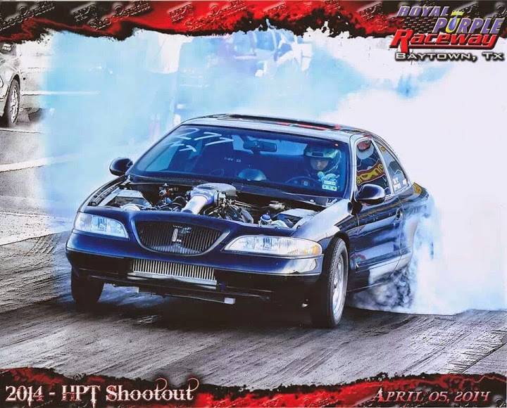

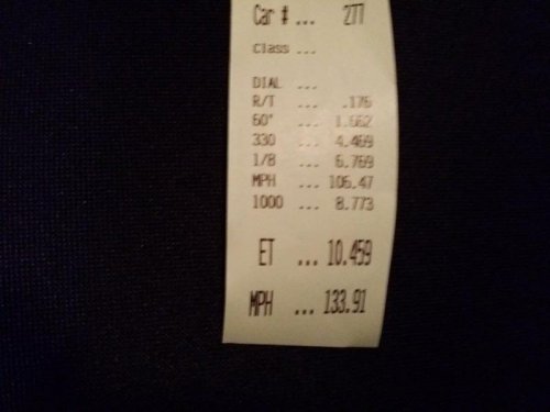

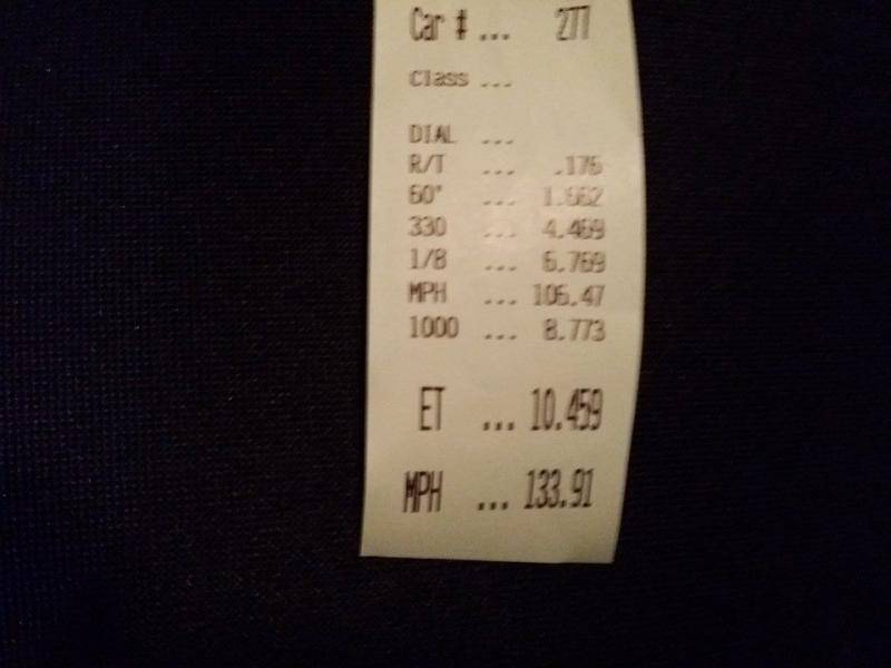

      1st quarter mile shake down pass.jpg IMG_93967898136871.jpg Tune is still way safe and not complete and we are only running 7psi and 11.6 degrees of timing on these passes Fri. night..

        What a beast! Do you have to do anything other than fuel pump, injectors and tune to run E-85 on these cars? What is your full setup for your fuel system?

        Looking mean! Nice times for sure. Good to see other MK8's out there on the strip. What trans you running again? I forgot.
