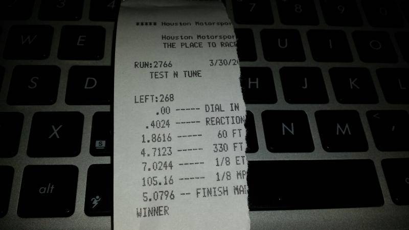

I'm still trying to understand what you are eluding to olddavid about my imagination on 1/4 mile types? I run both 8th and 1/4 mile tracks down here..only 8th mile test/shake down passes so far this past sunday @ Houston Motorsports Park..
We are only running 14 deg. of timing right now and very fat on the E85 till we get the MAF lined out but she did make a very promising pass considering the 60' is very low but 105 is only 6 mph off my buddies 1/8 mile passes that has the same setup in a 13 Coyote TT on 12lbs of boost and we are only running 7..lol 20140330_220425[1].jpg

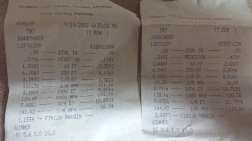

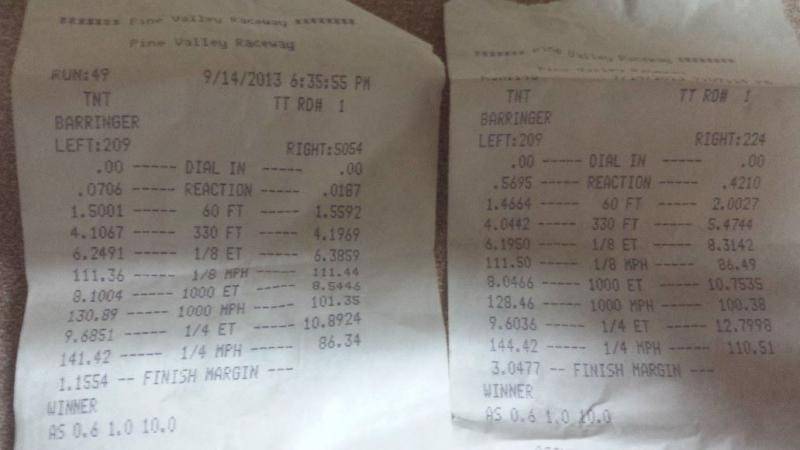

these slips are my friends TT runs1239193_553943341337419_1052892043_o[1].jpg

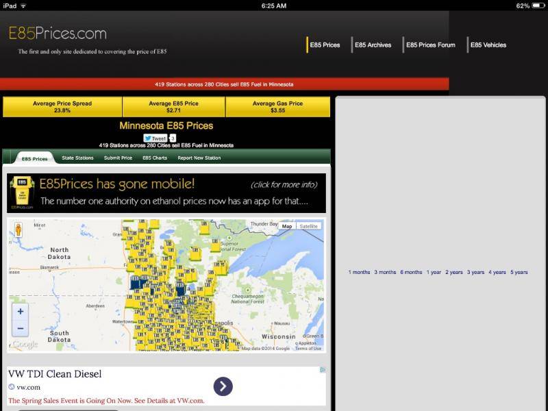

I don't know what it's like to get E85 in TX but here in MN it's pretty common and cheap. The price has stayed consistent and we haven't seen a increase. I would be interested if people have other places, I know they were introducing E15 at a few station as well as select-a-pumps that had preset mixtures.
****,it's always been cheap here in Houston,around 2.65-2.80 until I started using it..lol 1st time i got it for start up it was like 2.79 and regular was 3.25ish something like that,a week later i went to the same station and it was 3.15 i think and regular was 3.30..WTF? it's really a rip off if you use it in a daily driver but a beast in a race car..lol I don't even think we have that many stations in all of tx,on both apps i have to locate it there are only like 8 or 10 stations in houston most of which are on the ritzy sides of Houston..
