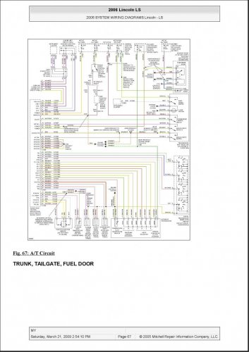

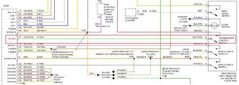

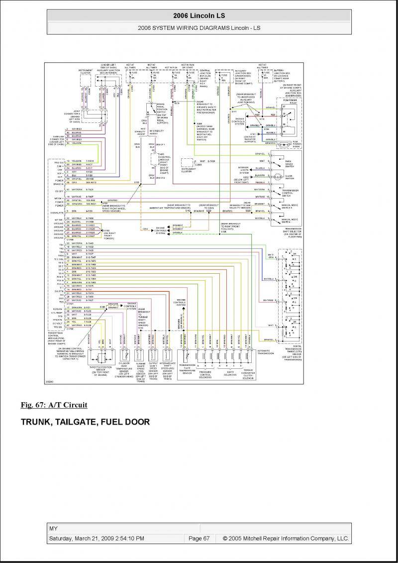

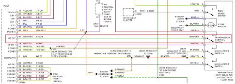

While going through the 2006 wiring diagram in researching adding heated and cooled seats I think I found the answer to the question of how the PCM reads D4 and SST selections. I've highlighted the D4 wire but right below it you can see the SST enable switch.
There is still the sport vs. non-sport calibrations....... That's too small for me to read.....
You still have access to all the gears without the SST shifter. You just lack the ability to hold 4th and 5th.
