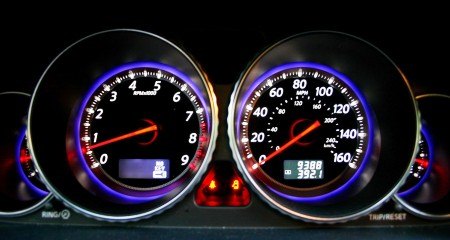

A few months ago I drove a friend's 2008 Infiniti M35 at night, and I really enjoyed the blue-on-white LED gauges:
Are you able to do white in the gauge cluster? Maybe with blue needles?
The gauges yes. Needless would be a problem

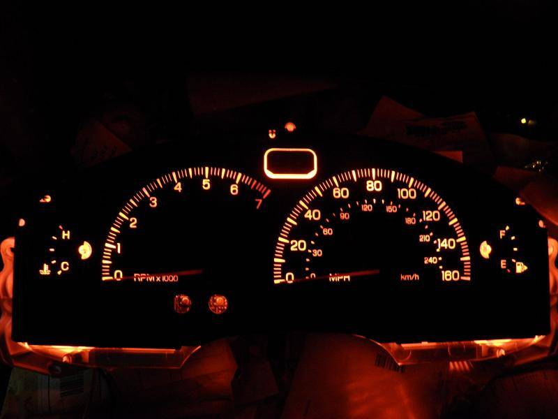

I think the needles are going to need 1 or 2 leftover PLCC2s behind them... The current LEDs don't line up correctly with the overcomplicated optics behind the gaugeface. What makes it worse is that LED orange and needle orange are two different oranges. I guess it's better than blue LEDs, but still...
It's too bad that the needles are orange plastic with white paint on the back. I was oping it was clear needles with orange paint. Electric-blue needles would have really set off the gaugeface (blue like the LEDs in my profile pic)
If I was still at my old school, I could have tried drawing them on CAD and cutting plexiglass with the CNC laser cutter
Actually, a red 5050 might do the trick. They respond better to red LEDs than orange.

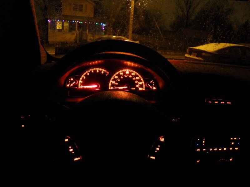

Done. I widened the needle-pin hole in the clear plastic layer and put in red 5050s (1 per small needle, 2 per large). I made the circuit out of 30ga wire glued to the clear plastic. Now all that's left is the doors. The orange is definitely richer in real life. The camera adjusting for the darkness washes out the light. I'll try to put of pictures of the 5050 circuits if I can find my camera cable (saved to the internal memory)
