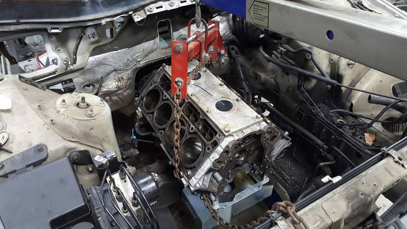

Got my oil pan, and t56. Mated them together and dropped them in to check fitment. Waiting on heads and headers before I make mounts.

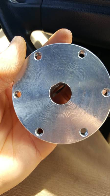

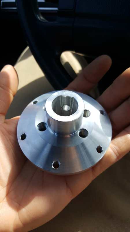

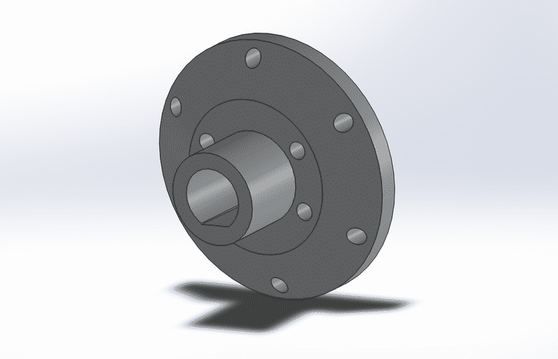

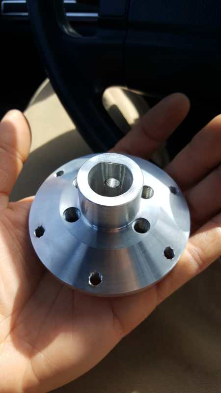

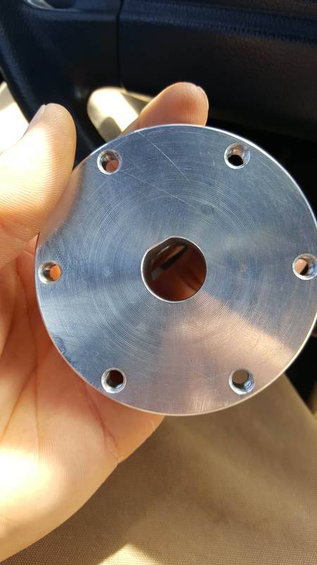

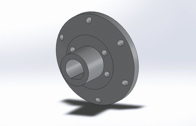

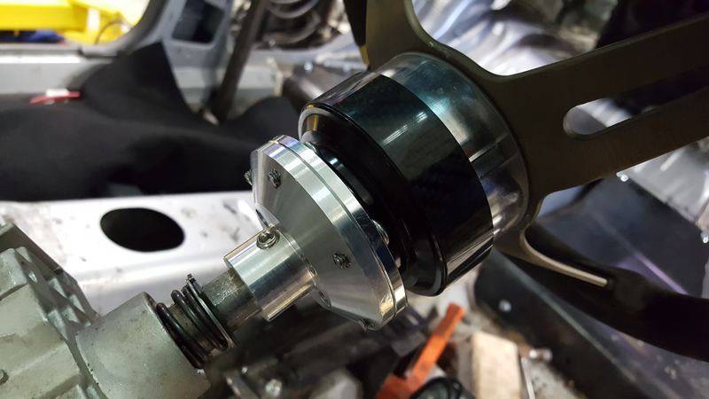

Do you have 1 for sell?
No sorry. Maybe in the future but for now manufacturing costs aren't effective. One hub is around the $400 range.
Just ordered some shorty tight tuck headers. Well see how they look.

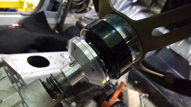

Is there an nrg quick release that would fit the LS?

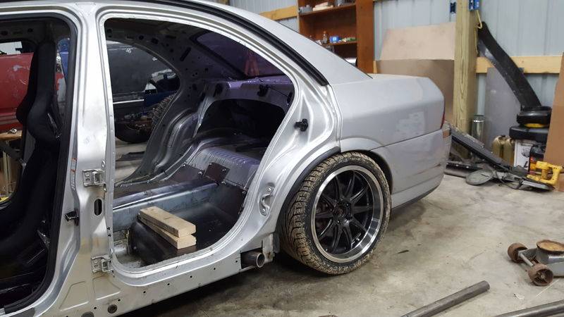

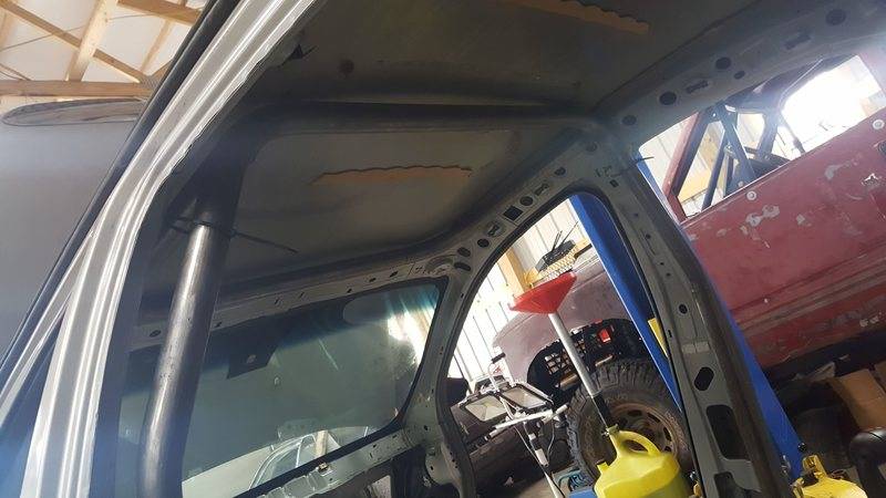

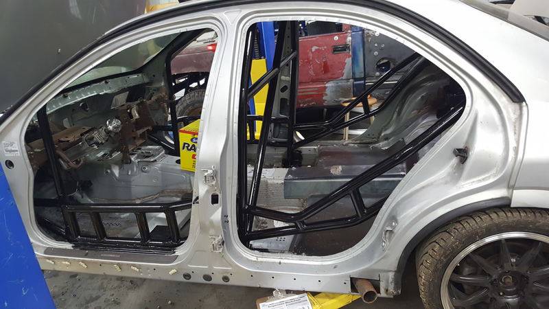

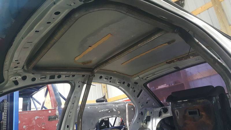

After my brief hiatus. My cage is complete (almost). Hope to never have to do a full cage again. This was hell. Have ordered a fuel cell and headers. My motor will be done at the machine shop soon aswell.
Glad to see progress on this thread! Roll cage looks like it would have taken some work
Why the complications of the truss-type build across the back door openings? My own cage is somewhat simpler, but certed for up to 175 MPH by ECTA and SCTA. (See Land Speed LS in the performance section.)
KS
KS
Point of this car is to give rides at drift events. The rear bars are to make sure passengers seated in the rear will have adequate side crash protection while making it easy to get in and out.

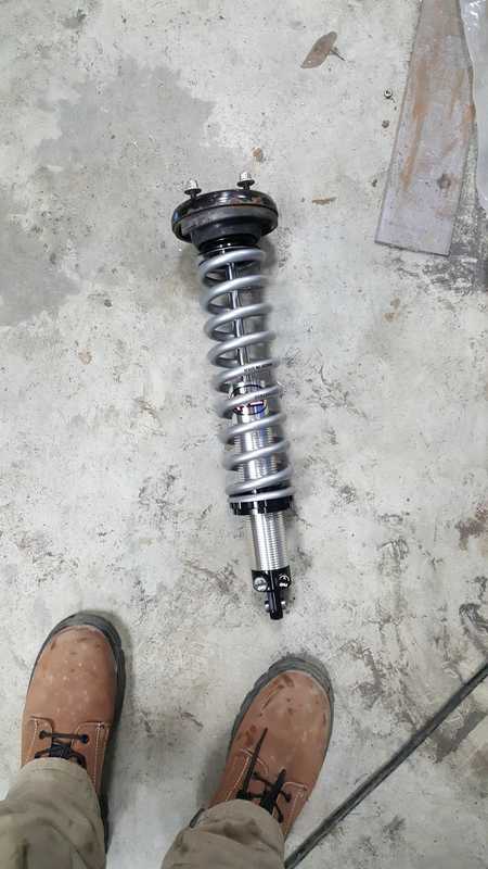

Worked some more on suspension and got the fuel cell installed
iSAdPcg
iSAdPcg
iSAdPcg
Rear springrate 600lbs
Front springrate (not sure yet maybe 750)
Qa1 Prom Star Coilovers.
