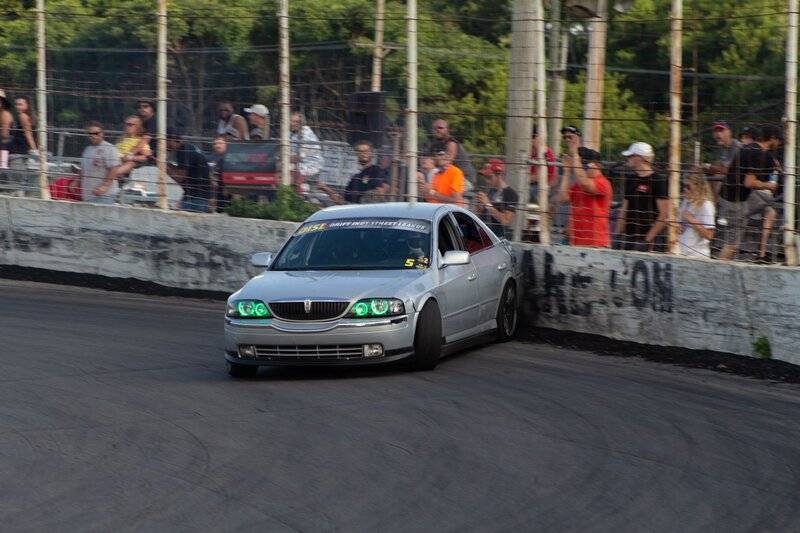

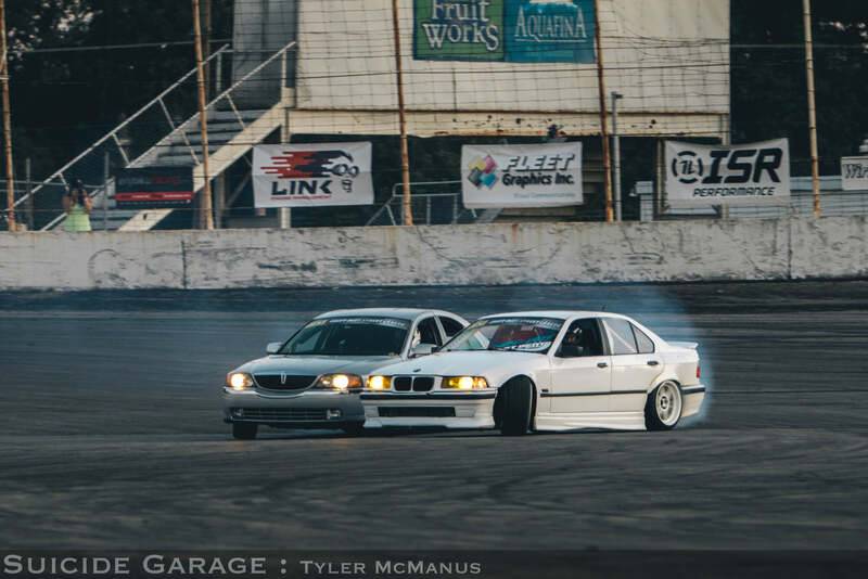

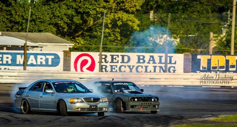

Had my first official event, Drift Indy No Star Bash. Learned a ton about myself as a driver and also found a few weak spots within the build, mostly power steering and suspension. A few good videos and pictures, and the first ever lincoln lincoln tandem.
Will post more vids later. There are way better ones.

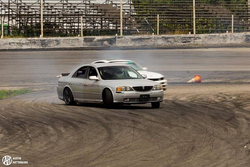

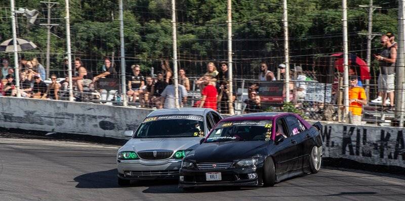

Went on to the tandem competition and ended up qualifying 8th!
After qualifying I won the next 3 battles and went on to battle for second against my friend and pro licensed driver Mike Feiock who was actually driving a friends car due to his having engine failure earlier in the day.
He ended up beating me but it was a hell of a ride, I gave her all shes got! Still ended up with 2nd and a killer trophy.
So this Lincoln LS beat about 22 other proven drift chassis!

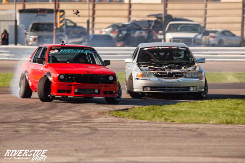

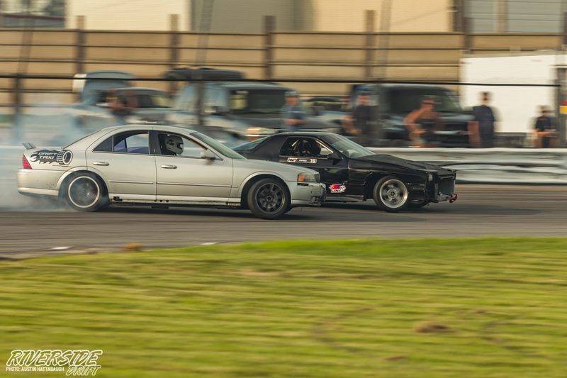

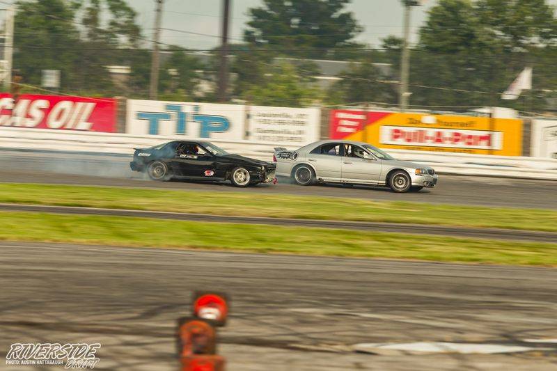

Was able to qualify first and finish 2nd at the next riverside round! I ended up loosing an oil line and catching on fire for the battle for first, but got some killer footage. Check it out.

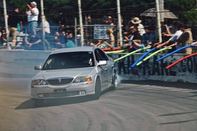

Drove 4 competition events this year and Podiumed on 3. Finished third at those three events.
Installed a wings west lip kit, and had some halo lights made (Manual Roman)
First Third Place

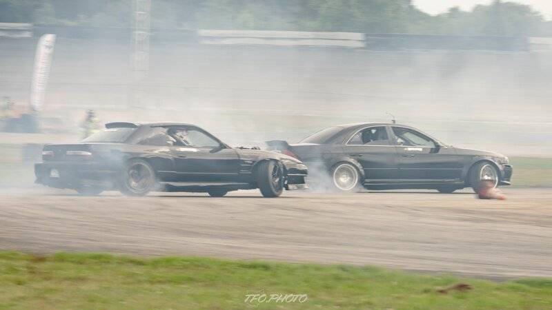

The comp event that I did not win was a very fast street event in kentucky, actually wrecked the car in early morning practice, bent my rear toe arm, my knuckle and my rear subframe. Managed to get it fixed enough to qualify on a bad alignment and make it to top 8 where I was knocked out.
Event made for some killer media though!

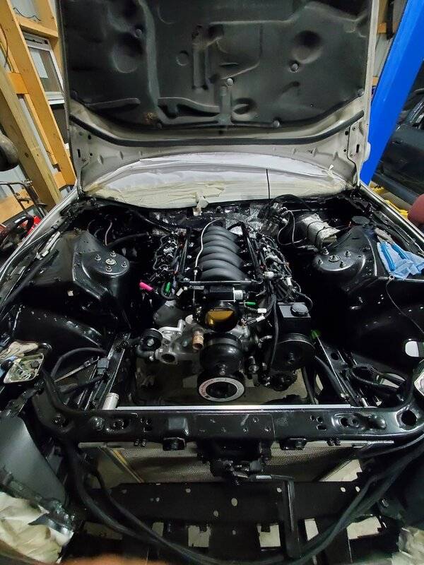

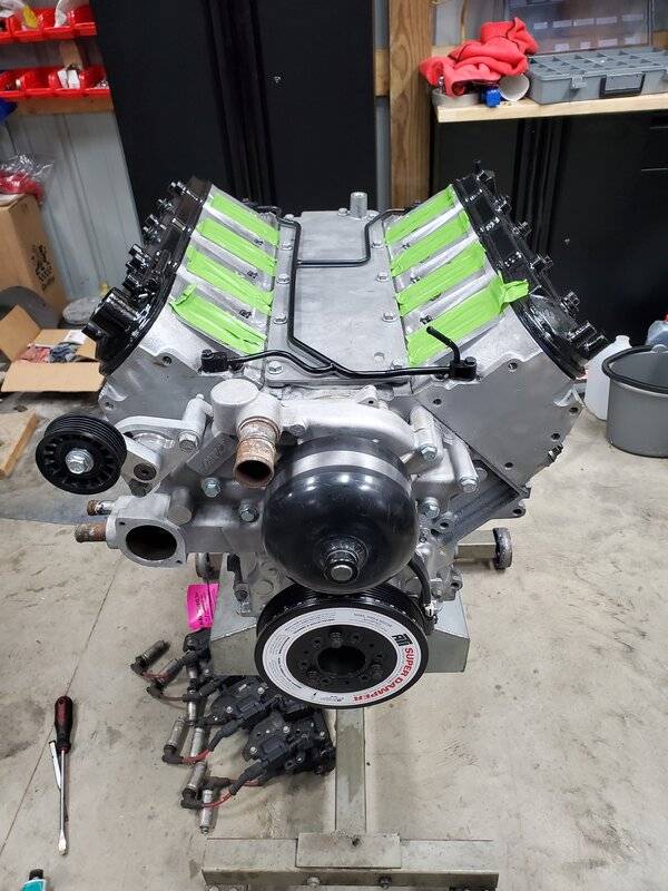

I bought and had an LS3 built (always wanted an ls3 in this car) Target goal was 550HP N/A
Had my sights set on an event in July, a drift event for $50k prize, but I wanted to do a little bit more than just an engine swap. I also wanted to change from HP Tuners over to a full Holley Standalone with a digital dash. Also changed my fuel cell over to a nice fuelsafe system with an in take surge tank.

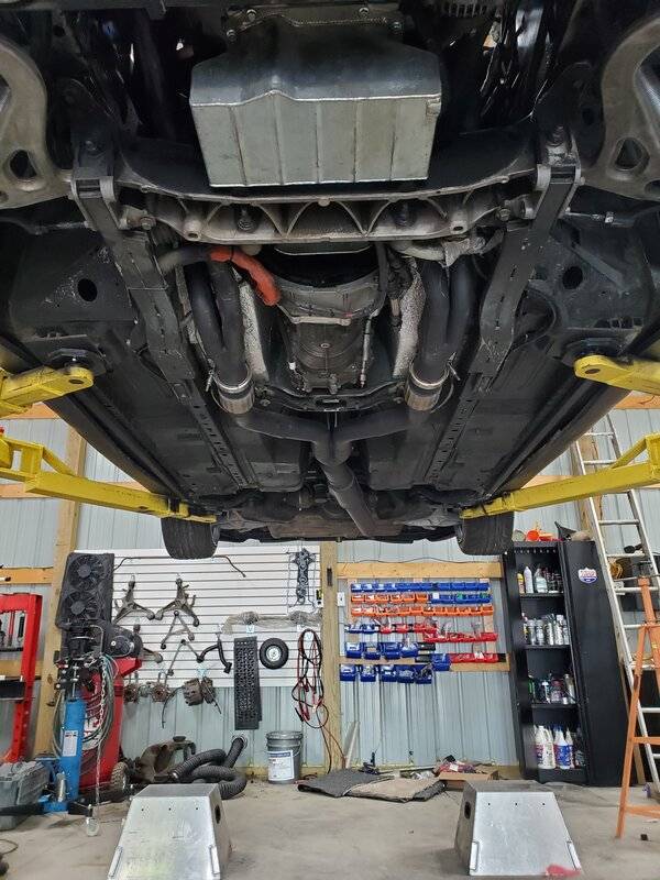

Got the engine in about (3) weeks before the event and Holley wired up, also had to make a new exhaust as this engine flows more and would be restricted by the size pipe I used on the 5.3. I used 1-7/8th headers to 4" pipe with a 4" resonator/muffler *car is still out*.
I had to completely make these headers, bought a foxbody mustang kit and cut every single tube and rewelded them at new angles. It sucked and took about a week each side.

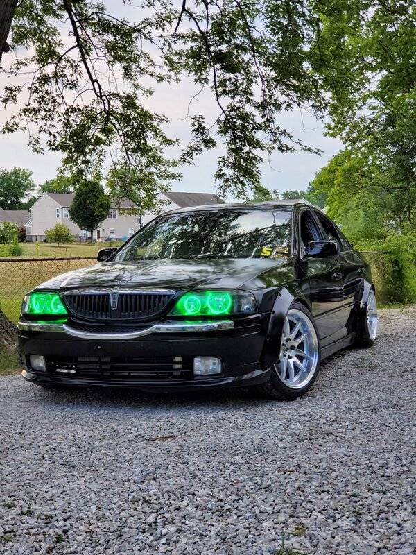

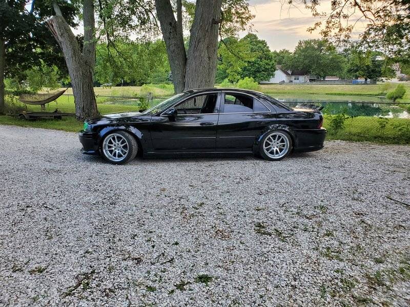

The other big item was the appearance of the car I really wanted to change it up to a more aggressive look and make the car black.
I paid a designer while I was in NC to make some renders of various wheels so that when I got back I could try and make the car come to life.
This is the final design of what I wanted and now it was time to make it come to life!

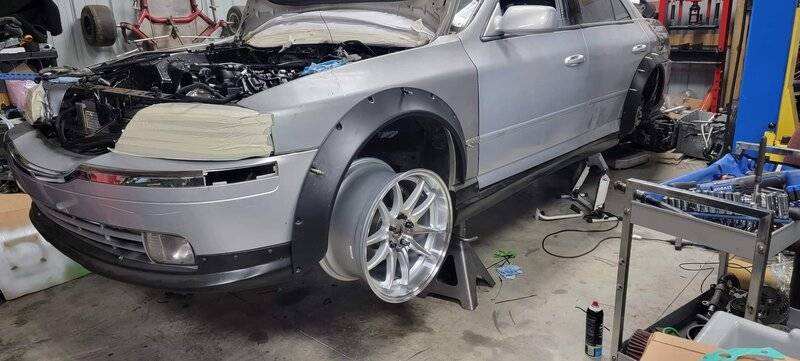

Started by buying the wheels, used (5x114.3 and ran adapters) and found a set of flares I wanted to use from Clinched Flares.
We did all of the bondo sanding and prep work and with 1 week to spare my wife painted the car (and hers) while I was away at a race for my job.
So stoked with how the car ended up and so sick to see a dream come to reality!

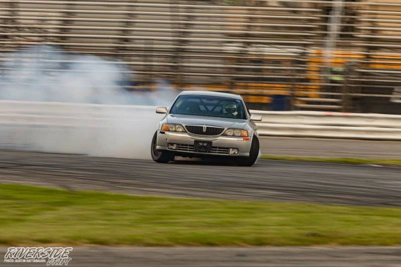

Here are some pics from the event!

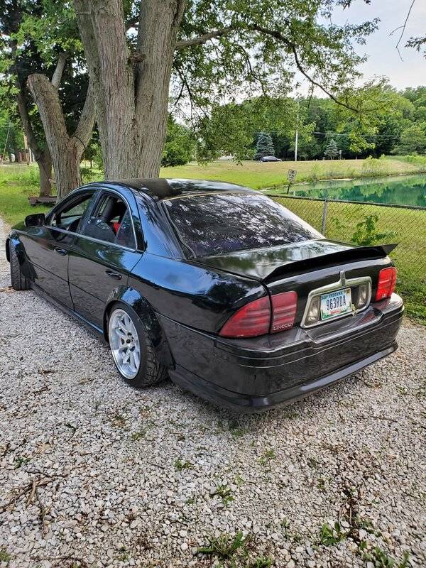

Nice! I was thinking it was a new car, cool to see its the same one. I took a note on the 2018 Charger Police fan being brushless with ~14a startup. Did you cut into the quarter and door to give clearance for the rear wheels?
Yes I had to cut quite a bit.
