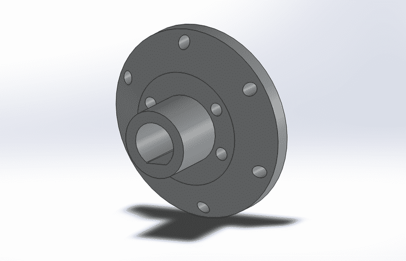

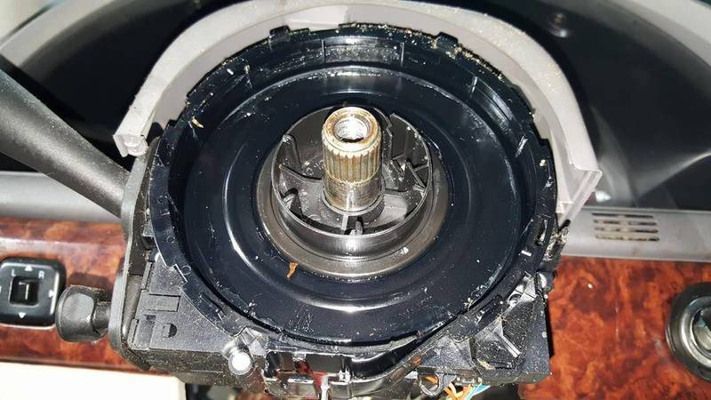

First things first is making this a little bit more "drifty". Will machine a hub that adapts this weird keyed steering shaft spline to the popular NRG quick release steering wheel system.

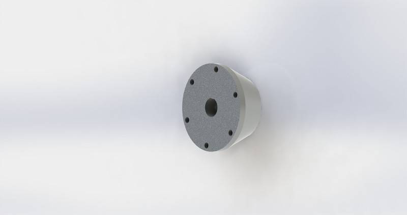

Did some fine tuning to the design and sent it out for a 3d prototype.

If your hub is successful I will buy one for my LS, I am headed down a similar path as you..

the thread will be posted here. I am on my second 3d print model for the hub and am making a few final adjustments before the final metal design. I am moving into my new shop over the new two weekends so after that my time will be mostly dedicated to this and an offroad truck I am building for the TORC series.

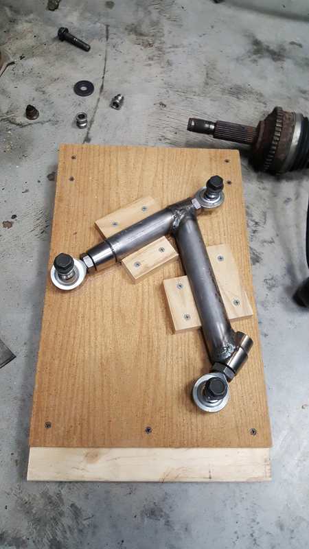

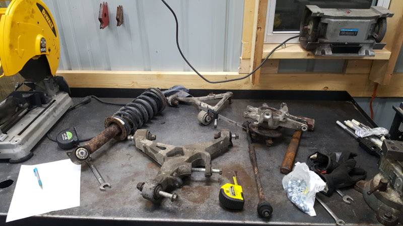

I also started taking apart the rear end control arms to get dimensions to make tubular adjustable replacements.

Finished up the rear control arm prototype and made a template for the otherside.
