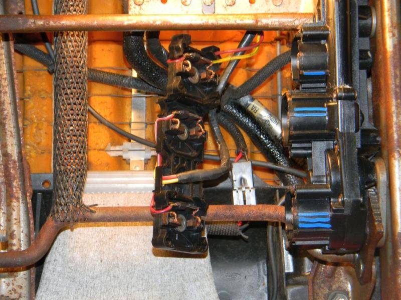

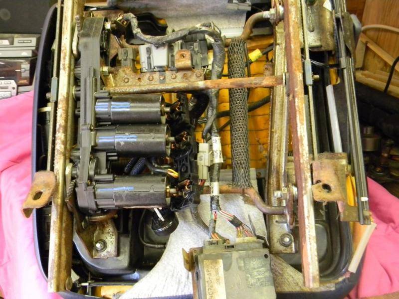

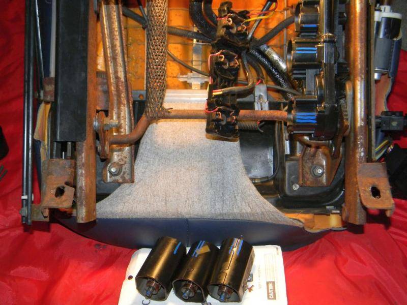

Pulled seat and tried the motor repair. Motor's were real clean when I pulled them apart, but cleaned them as stated above.
This is good information and I will be cleaning the drivers side motors as well. Unfortunately the passenger seat still tries to move but doesn't. Motors and brushes look new. I think it's has to be a track problem. :(
i had the same experience. i ended just replacing the seat track with a NOS track from ebay.
Pulled drivers seat and went through motors just like "Billcu's seat motor rebuild" said and....another failure! Motor's were a little dirtier then passenger side.
The motor rebuild is a must do thing!
This slide works but I can tell something is trying to hold it back, I think the tracks on this side are also too rusty, or maybe weak motors?
hhhhmmm....moving on with interior repair.

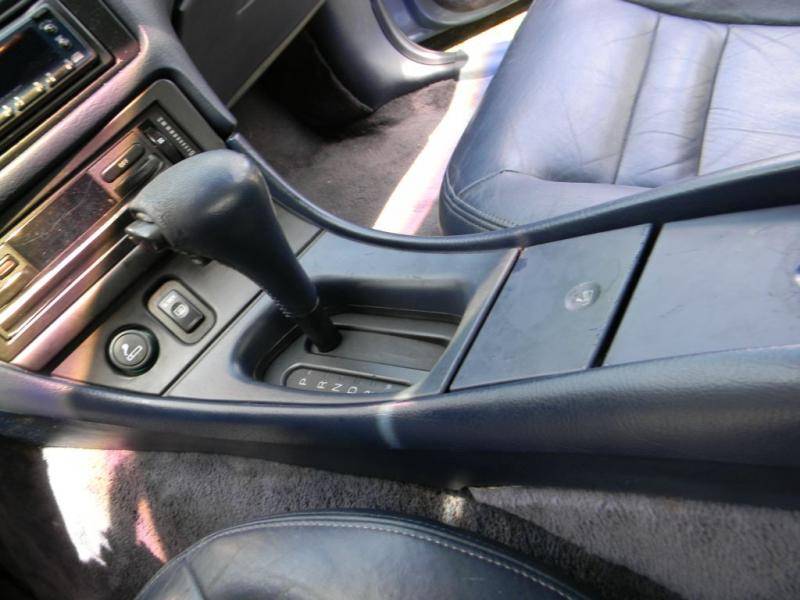

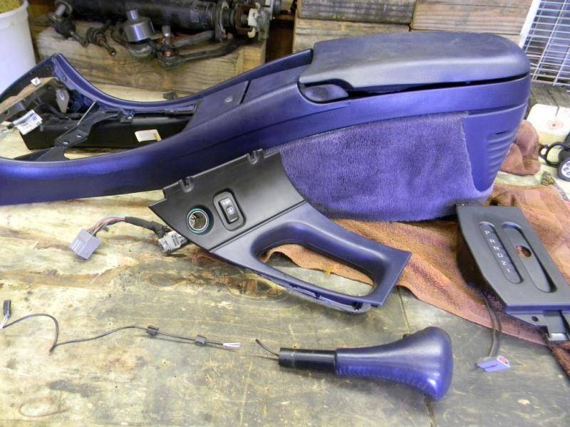

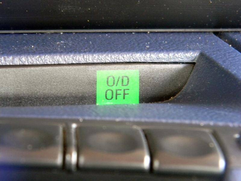

OD button hasn't worked in years. Pulled console and fixed broken wire. Button works now! I thought that would be an easy one.

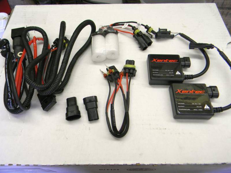

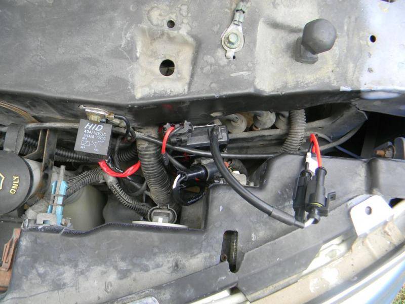

I thought I should check in with the experts 1st! (as I never hooked up HID's before), and they didn't come with directions. Everything look's straight forward and an easy installation.
Correct me if I'm wrong!
1st pic...what I got.
2nd pic...laying everything out to see how everything's gonna fit.
My question is...2nd pic, the black wire coming from the relay. It plugs into the the wiring harness that plugged into my halogens on the drivers side right? So am I correct in assuming that the wiring harness that plugged into the passenger side is obsolete now? Everything runs off the drivers side wiring harness??
With the relay harness, you will have two additional wiring harnesses left hanging because the relay has been added to the mix. Disconnect ground on battery, connect relay first just like it tells you to. Directions are pretty straight forward. Then install one ballast and light at a time and make sure you are connected to the relay harness. The original passengers side light harness will be left unplugged in the end. You will be using the relay harness for your light connection over there.

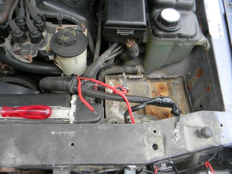

All wires are ran and tied off...only one wire left over...the (black and white) one coming from the relay! Passenger side (wiring harness) is obsolete now...both ground wires are grounded! Battery is out of car! Left over wire is connected to wiring harness on drivers side (black and white)!...only thing left is to connect red wire to positive side of battery!...Is this correct??? If this is correct, I'm ready to light them up!!! oops! lights are the last thing to install! gonna do it now...let me know! pics to come of mounting everything, gonna take pics now!
OK...here we go!...Sorry for the dirtiness under the cover
1st pic...passenger side
2nd pic drivers side
3rd pic battery compartment
1st pic ...taped up wiring harness ...passenger side
2nd pic, you know
3rd pic, you also know
Does this look OK? Am I ready to light them up?
I didn't touch bulbs with anything, not my fingers or nothing!
Red wire goes to positive side right?
Sorry, don't mean to sound stupid about this but...don't want to get it wrong!

All that can really happen is that it won't light up but yes, it looks ready to me. Xentec is an alright ballast but there are worse and there are better but you'll pay for the better. I ran Xentec in the 94 for a long time before it burned but they never gave me one problem. I'm by not saying Xentec is the best kit by any means but a lot of people that were putting them in Gen 1's were doing so without a relay kit too. Not a good mix! Turn them on and your message center should say "check exterior lighting" after about 3 to 5 seconds. Just hit reset and get out and look at them.

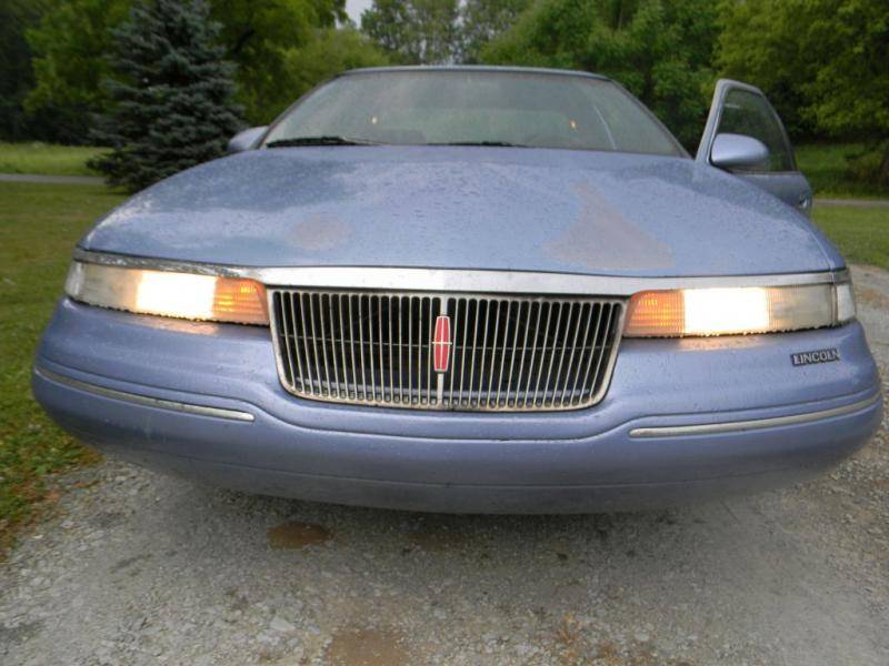

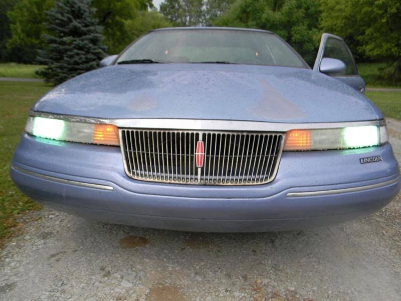

It's night time now and all I can say is.....Holy Sh*t! Those make one hell of a difference! Pics are before dark. I gotta get me some more for the High beams and the wifey's Jeep!

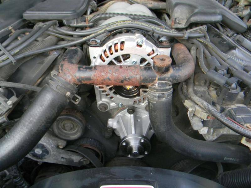

This was not on my games list.
What's the chance of the alternator going bad followed a couple days later by the water pump?
Ya never know with these cars. Make sure to burp the system and it has to be burped at the crossover tube. That cap has to come off and by the looks of yours, you might need to use a pipe wrench but you can try the 1/4" ratchet or w/e that size is. If you don't burp the system COMPLETELY, you will be back on here asking why you're over heating so, let's prevent it before it happens lol. Fill it while it's running and make sure to get ALL air out through that crossover tube and then get the cap back on there.
A month ago or so when I started working on this car I had to use a 12" pipe wrench with a 18" breaker bar, thought I was going to break something, but now it looks bad but comes off pretty easy. That was so I could replace the oil filter housing gasket.

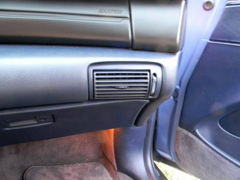

Right on the edge of the vent itself, the part that actually moves, put a flat head on either side and gently pry it out. Takes every bit of 2 seconds.
Came out just like you said! Black part behind vent was off track (fixed that), 2 of the blue fins were broke because of being knee'd. A little super glue and almost good as new...lol..at least it's better the it was! The vent works now!
