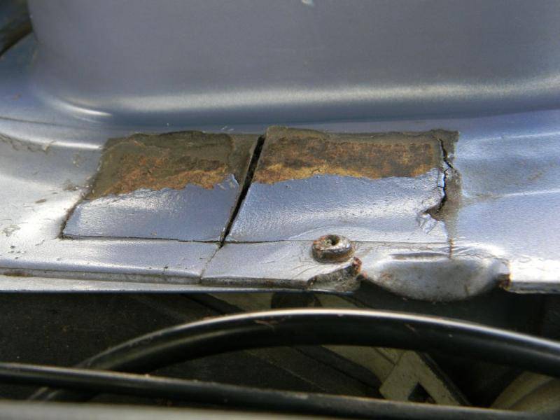

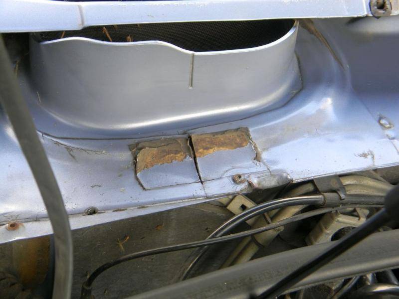

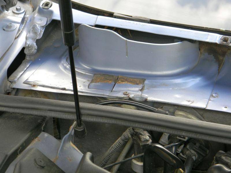

He mentioned a leak into the passenger compartment. I also have this leak so I thought I would see what was going on.
This is what I found. Not sure what that patch is for??
Cleaned everything and with the help of probably too much ATV. I'm sure there is no more leak! (alarm would go off when it rained).

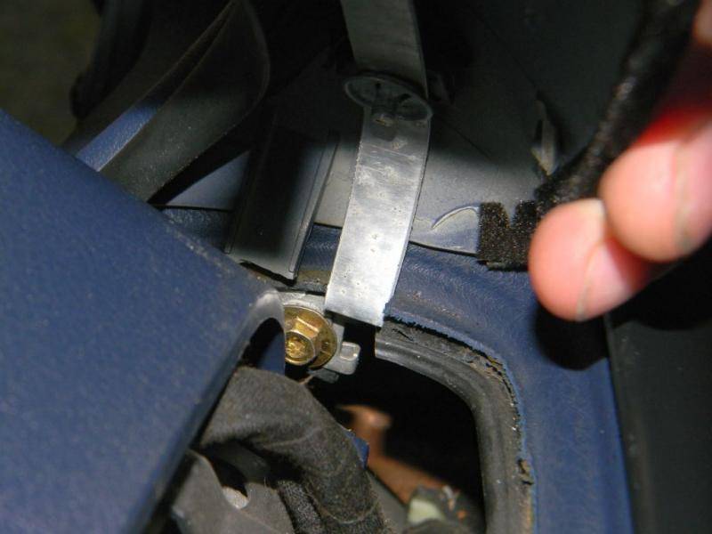

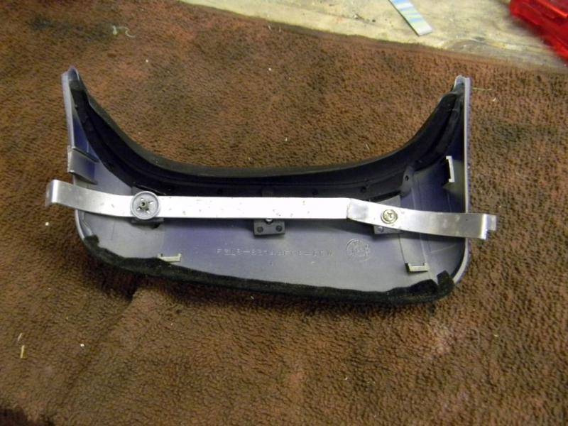

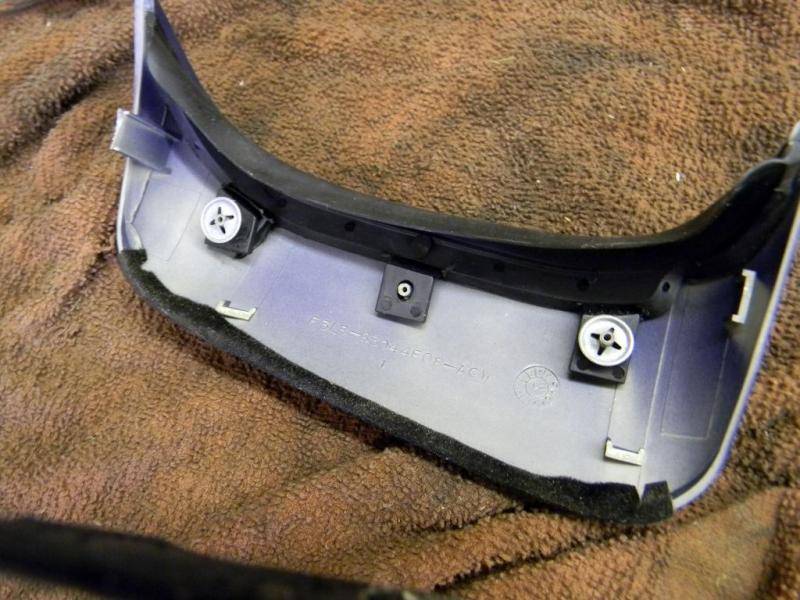

Thought I would add this to the game's list since this isn't my DD, just playing with this car....

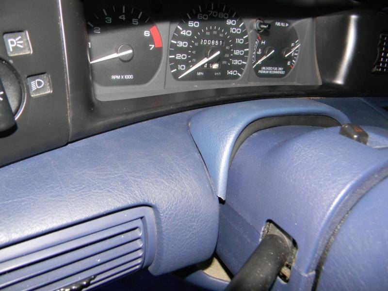

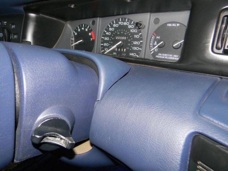

Anyone broke this?
All four tab's and two of the plastic screwy thing's are broke.

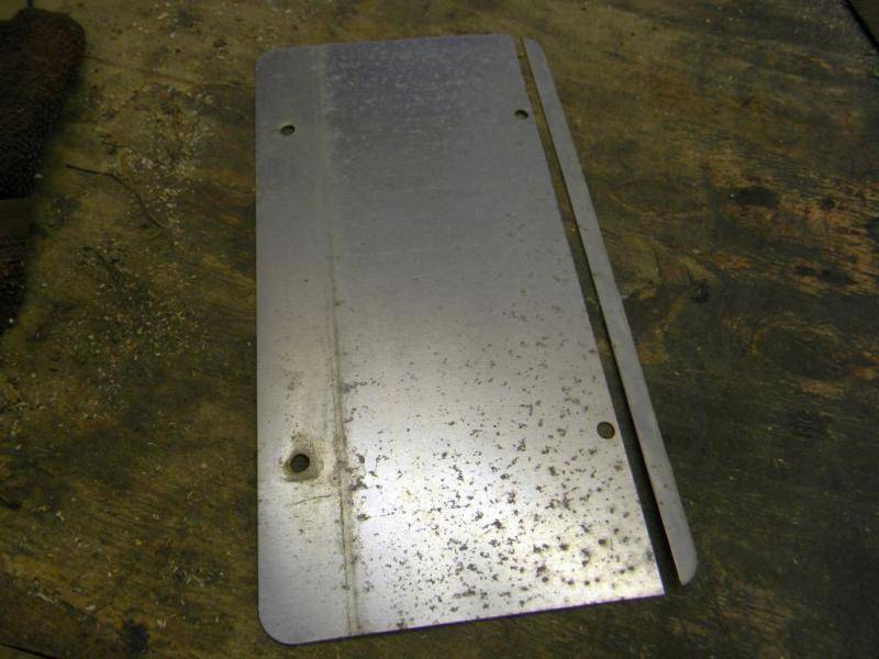

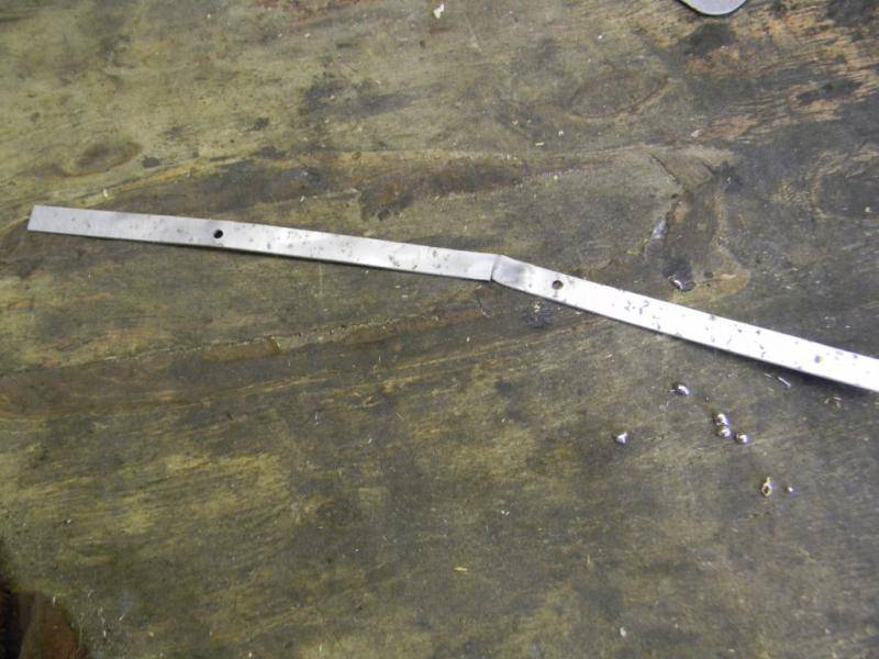

This is my fix....did it years ago and just did it again for a tighter fit.
I used an old aluminum license plate and cut a piece about 3/8" wide and drilled two holes, cut a slit (for a bend) because the mount is offset and molded it to the cover, made bend's in the end for a hook type method to hold it on. Used stock hardware where I could and a screw where I couldn't.
Now, this thing just snap's in place and I can remove it anytime I want!
I've seen this glued on, screwed on and not on at all! There's no sense in that! This work's and is removable if you so desire! And fit's perfectly!

I've had a dozen of these cars and never had this piece broken. Guess i'm lucky....:cool:
Was going to replace it with a piece of spring steel but it's holding good and tight....think I'll just leave it alone! :) And move onto other fixes.

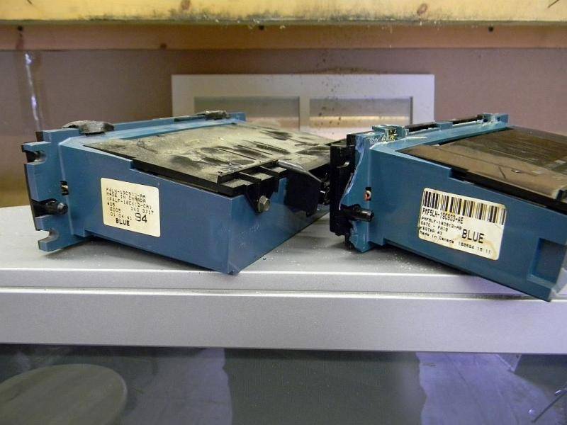

Thought I would add to my games list again.

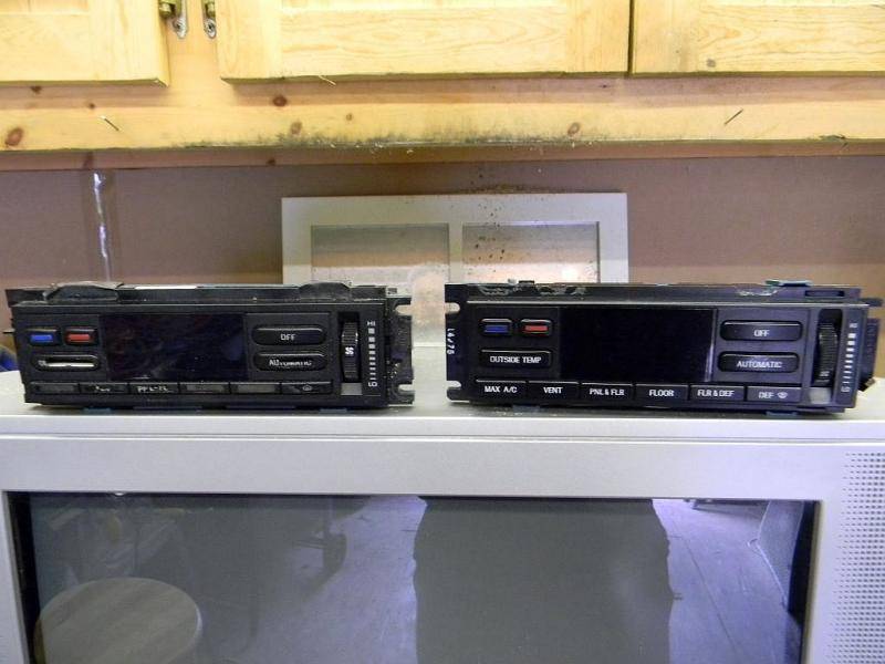

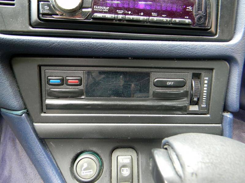

Just received a 95 blue hvac unit in the mail yesterday from dnsherrill with perfect buttons to replace the old crusty 94 broken button one that is in the car now. 95 one need's cleaned up a little. I wounder if I could just swap the face plates instead of pulling the whole unit? I may have to look into this (this weekend's project).
Oh yeah....in case anyone is wondering, it's been 14 months since I repaired the rear seat in post #1 and it still looks just like it did after I repaired it. :)
If I'm not mistaken, you will have to pull the unit to replace the faceplate because the bolts that hold it on go through tabs molded into the faceplate. I've only had mine out once to check the bulbs but I think that's how it's made.
Ok....the new used hvac unit is in. It's not dark yet but are the button's on the 95 unit suppose to light up? I don't think these do. My 94 button's lit up, to good! Had to put tape over the button's to keep from getting blinded at night.

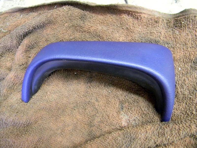

The 95 had some problems with the blue housing (had to do some work on it).
The face plates are not interchangeable. The 94 blue housing is about 1" longer and a little different shape so I couldn't switch housing's either (tried). Anyway It's in and everything works with the exception of the button light's....I think! Will have to check again when it get's dark.

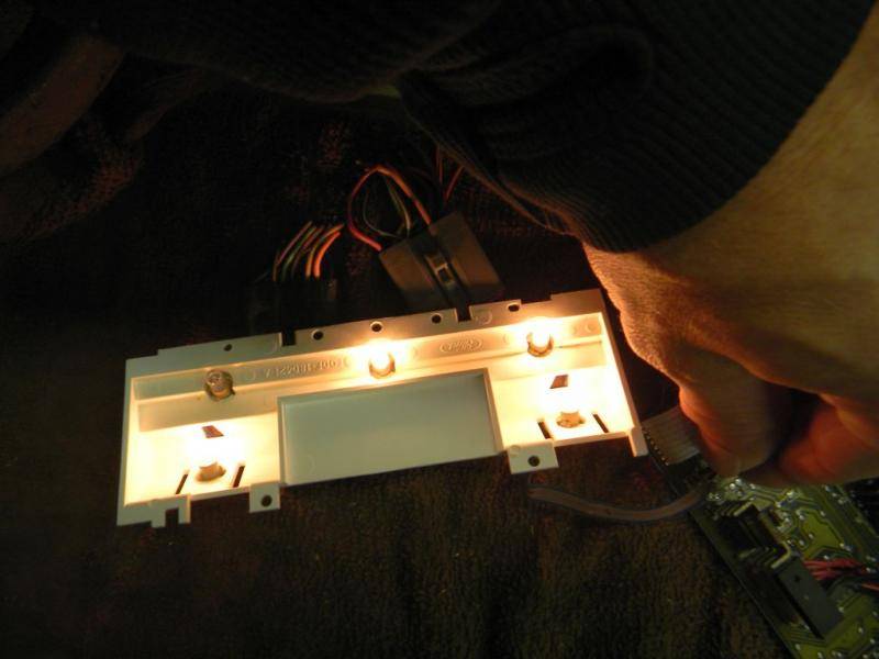

Edit: I can now tell the lights work very dimly in the thumb wheel, max ac and vent but not in anything else. There is 3 or 5 bulbs for the buttons. Anyone know which wires I can hook up to 12v so I can work on this on my work bench to get everything working before I put it back in a second time?

I had a thought...test the bulbs and not the unit.
94 unit has 4 out of 5 bulbs that work. 95 unit has 1 out of 5 bulbs that work. I'll just switch the bulbs out of the 94 into the 95 right? Wrong!
94 unit bulbs have longer bases and a slightly bigger bulb and seem to be a little brighter.
Ok move to plan "B".
Try switching bulbs with the sockets. First let me put on 2 pairs of reading glasses and warm up the soldering iron as I will have to solder the 94 bulbs into the 95 sockets. I'm having troubles holding onto these little guys!
This took a little time but seems to have worked perfectly! All lights seem to be lit. I'll take some night shots tonight.

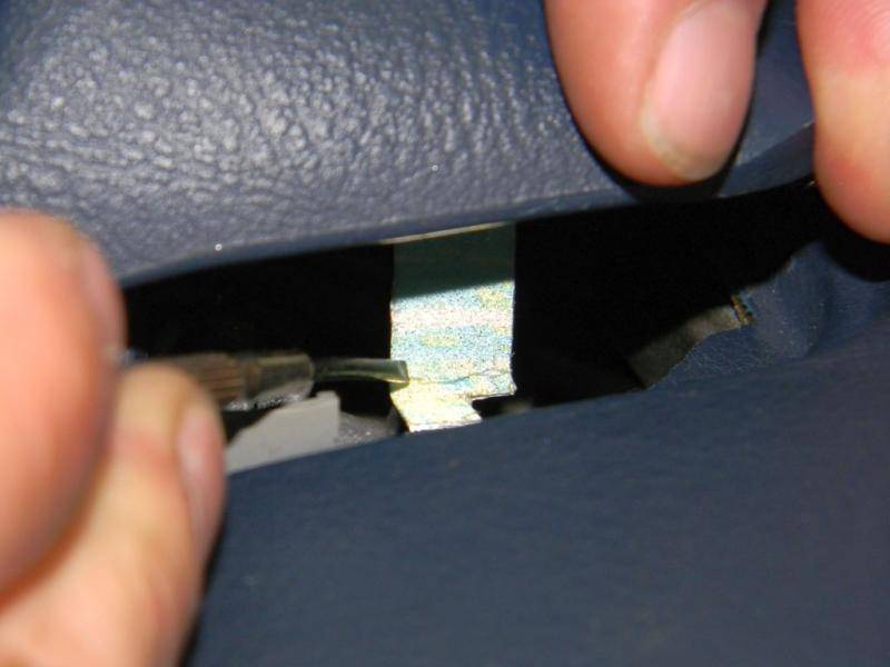

On the down side I broke the latch to the console by leaning on it....F@$%! Fixing this now.

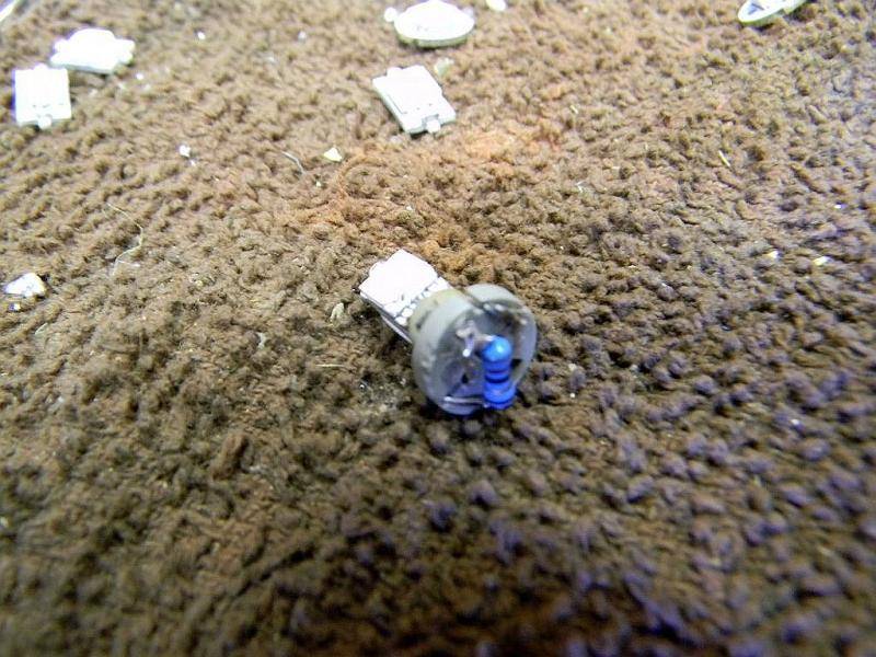

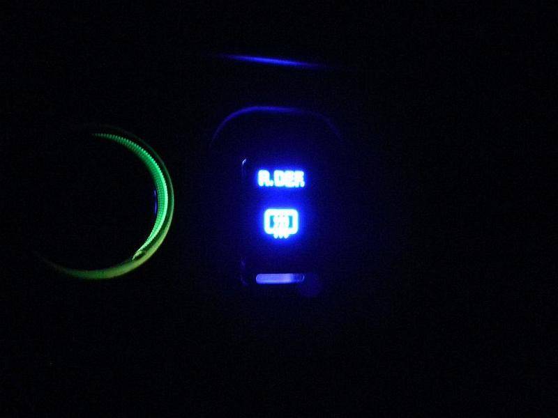

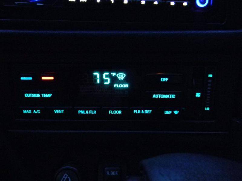

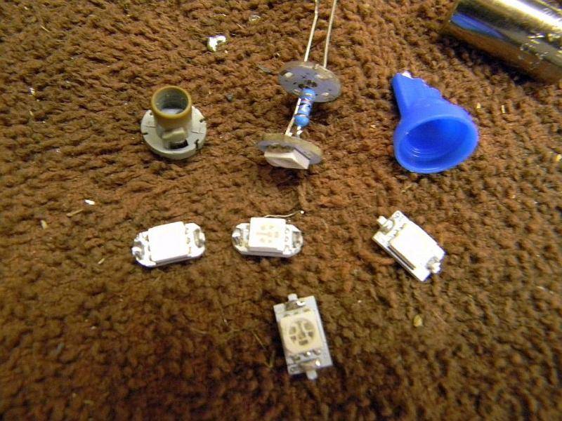

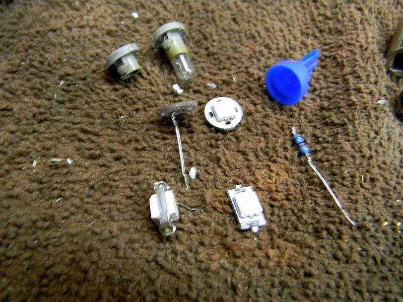

I was board so instead of ordering a light for the defrost switch and waiting for days, I had an extra 5-smd 194 that I thought I would take apart and make a 2-smd T4. Learned this from the guy on the LS site.
The original bulb was blue so I went with a blue led. Had to grind down the housing and the led's just a little, added the resistor and.....
WOW that switch is BLUE now! That looks unbelievable! I'm gonna have to order some more blues to replace all the whites.
I seen pics that others have done in blue but the pics don't do any justice. It looks ever better in real life!
Will add a pic of the switch tonight.

looks really good; did you reuse the teal blue outer housing from your car with the eatc I sent?
those little eatc bulbs are also available in led's..I have some, yet to put them in
Had to stick with the blue housing that came with the one you sent. Mine was about 1" longer and a different shape around the face plate area. Had to do a lot of work just to transfer the bulbs, but everything's working now. Haven't forgot about ya!

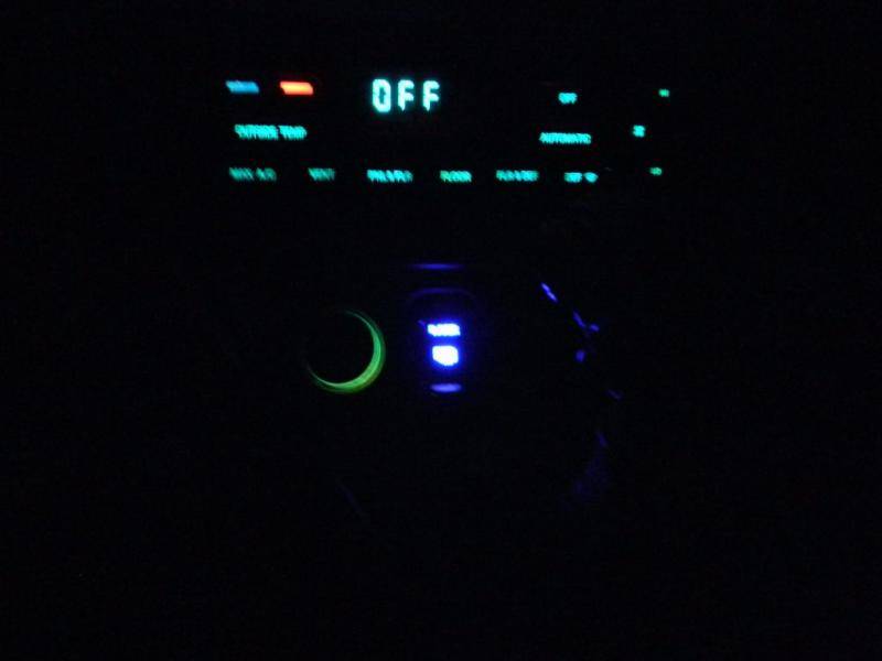

Blue T4 led's for eatc, defrost switch and the one for the message center are on order. The 7 for the warning lights in the message center are T5's I believe. Haven't made up my mind on them yet. Saving the headlight switch area and gauge cluster area for last.

Anyway here's a couple pics of the blue defrost switch, pics aren't that good, will take more when I put the rest in.
