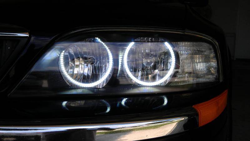

    Connected the brown ground wire to the black/blue wire and connected the white wire with the orange/blue wire. The reason it wasn't working before is because there was some dust or something stuck on one of the little plugs that connects the angel eyes to the box. Sensitive little things I guess. Thanks Alex and Spence for the help. I will post up some pics in my build thread tomorrow.

    When the turn signal is on they kind of have a faint blink to them, but they do constantly stay lit. They don't blink crazily like they were to begin with so I'm not worried about it.

    @Ben's LS Finally I finished my installation of the angel eyes on my Gen1. I wired the angel eyes with a switch button and put the switch inside the car. I will post pics about my installation. It was PITA to ran a wire inside but it's worth it after it was done :)
