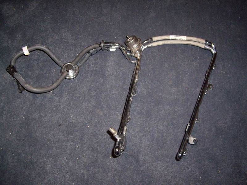

Another small update, got my fuel rail today. Now I have to figure out how to adapt the lines.

just get these and disconnect the rubber lines off that rail and you'll be able to put your lines into that rail.
The Cobra feed lines for the rail might just reach down in the fender well to connect to the fuel filter and return line (although it looks like the return line may be a bit short). I'd check that out if I were you.

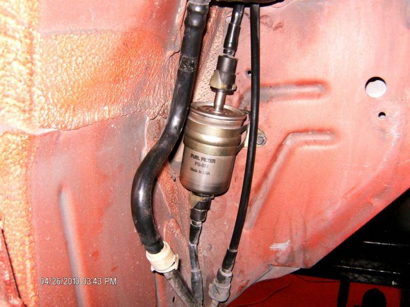

I have those already but the Marks lines wont reach the Cobra rail. Too short and the main feed is metal.
Im with ya, first thing I checked. They are no where near long enough.
Looks like I will have to buy new lines and fittings to run from the wheel well to the new rail. Thats gonna be like $100 for the fittings and 6' of braided hose.
if you unbolt your factory metal lines along the fire wall and get a brake line bending tool you can re-route the lines to make it to that rail there is plenty of fuel line to make a new route for them.

Yeah but wouldnt that be cheesy? The lines would run like halfway behind the motor and then bend back to the passenger side....... meh, maybe it wouldnt be so bad.
Ill ask SVO if he has a bender.
Thanks jamie, will give it a go.

laser, for the fittings at the filter for the feed and return you can pick them up at orileys or almost any parts store in the help section. for the lines braided or regular fuel injection fuel lines. here is what I ordered from summitt for the fuel rail fittins. I ordered the twist tite fitting so I would have a nice barb end to connect to.
FRA-491986 EFI FITTING A Shipped on
4/5/2010 $11.95 1 $11.95
FRA-491987 EFI FITTING A Shipped on
SUM-220701 TWIST-TITE -6 END STRAIGHT A Shipped on
4/5/2010 $3.95 1 $3.95
SUM-220702 TWIST-TITE -8 END STRAIGHT A Shipped on
4/5/2010 $4.95 1 $4.95
