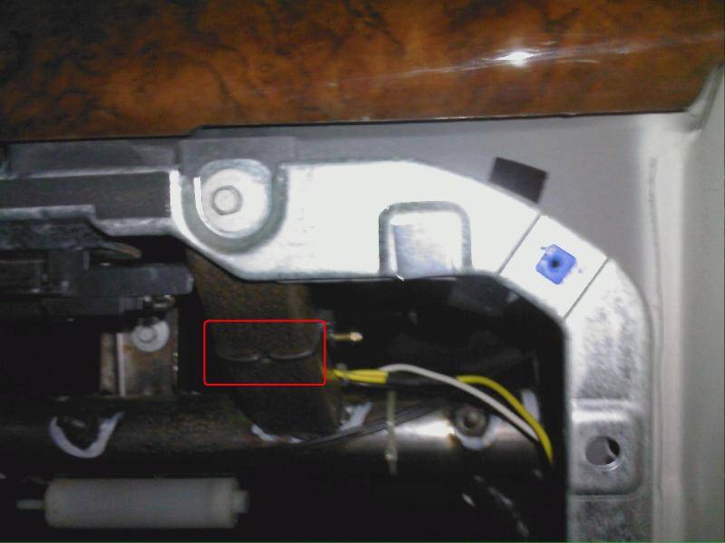

OK, the wire has been run from the stereo dash area, up the passenger A-Pillar and across the headliner and back into the C-Pillar. Thanks for pushing that suggestion.
Now to hook it up to one of the wires in the C-Pillar.
I took off more of the harness wrap to the sunroof.

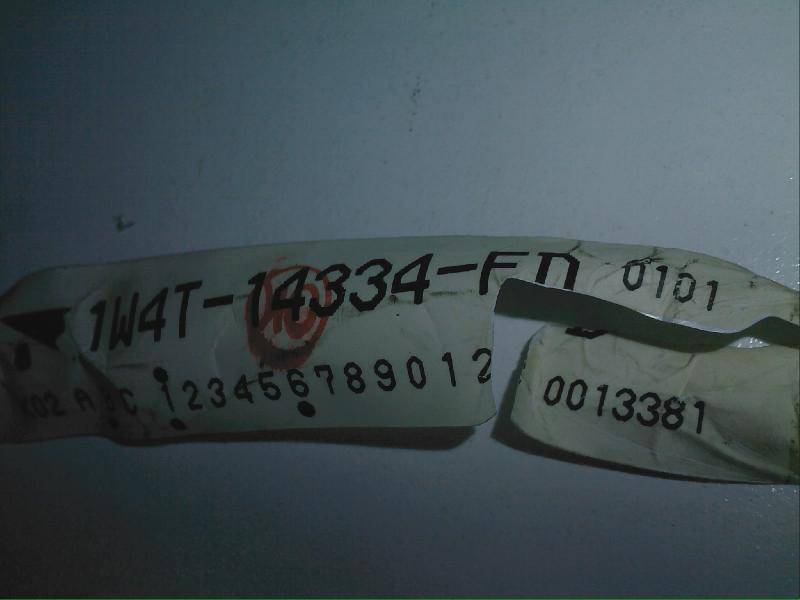

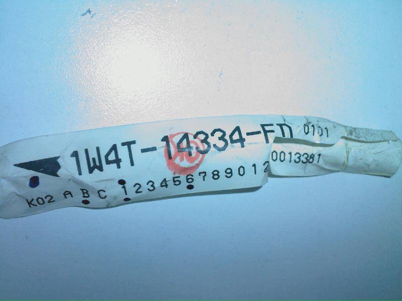

Here's the part number(s) of the label on the sunroof wire harness. I don't know if that would help give someone info on what wires are in that harness or not.
1W4T-14334-FD

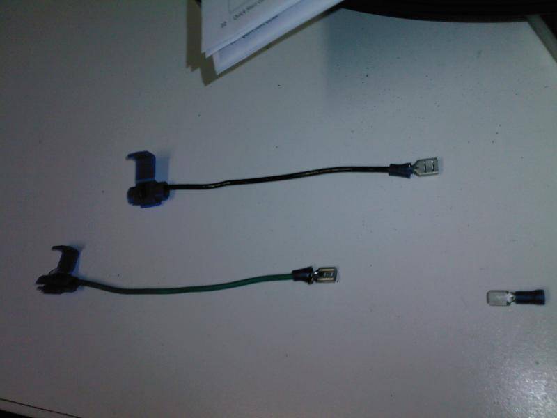

If we are pretty sure it's either the gray/orange wire or the blue/black wire, I will put one of these on one of them and try it. If it doesn't work, I'll tape it or cut it off, and put another one on the other wire and try it.
(I soldered the female ends, not a fan of crimping things, especially the important power wire. I didn't have enough insulated quick-disconnects, so I'll use these and electrical tape).
If it sounds like I am hesitant to cut/splice into a wiring harness and guess at it, I am...

i would never use a "t-tap" because they have a tendency to cut some of the strands of the wire that is tapped into, which can cause major problems (a lot of electrical fires i have seen in cars where due to T taps) the best way is to strip back some of the insulation (side strippers work best but a knife will do) then i take a pick tool and split the strands, then poke the new wire through the hole that the pick tool made, then wrap it around tightly, then solder. if you want to you can leave out the soldering and this will give you the most secure connection you can make.
for the proper way to interface with wires check this page out, about half way down, under tap soldering.
http://www.mmxpress.com/technical/connections.htm
also just a random thought, those test results seem to be the exact opposite of what you need, those circuits could be negative trigger like a lot of other circuits are with this car (instead of the 12+ wire going to the circuit powering on and off, the ground wire does) if this is the case you would need to use a relay to reverse the polarity. hopefully Joe can either confirm or deny this as its been a couple of years since i did this and i know that i had to use a lot of relays because of the same issue when i did the remote start/alarm at the same time.
you can test this if none of the other wires test correctly, by testing with the negative lead of the meter probing the wires, and the positive lead on the positive terminal of the battery.
I don't like t-taps/quick splices either, but it's what I had on hand. This is why I'm not comfortable hacking into this area. I didn't want to get back in there with a hot soldering iron... just not much clearance. Glad I didn't, as still searching for correct wire.
Doing the search method would tell me if it's hot (of which both of these are, until the key is on), but not which is the RAP. I don't feel like stripping wires unless I know which one and what's going on.
I could try and take the t-taps off, strip those back and check for broken strands... fix if needed, add electrical tape (I have Scotch Professional Grade Super 88, and 3M Friction Tape).

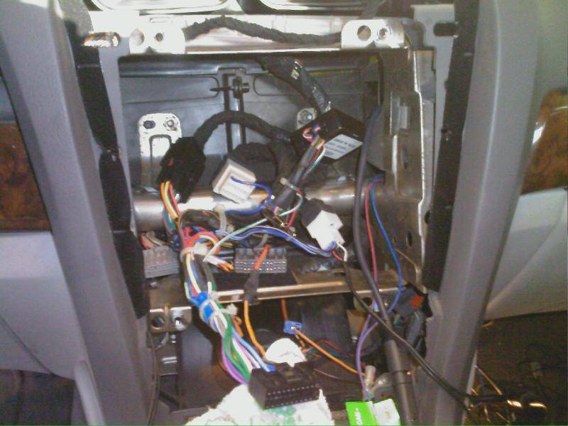

Initial test with only the 1st harness in the 1st picture below is good, it's working. Adjusting bezel position etc for now. Sounds good on HD FM (more stereo seperation than stock HU, which could be because of HD Radio).
Steering Control is not working, though the light says it found the car & radio. Other forums/websites shows some have had to hook up 2 resistors to get this HU working with ASWC Steering (it may think it's a JVC). I guess Kenwood changed something in the newer model HU's... reading about that now.
I am only going to be pulling this thing in and out with the one harness connected, until the Metra ASWC is working right.

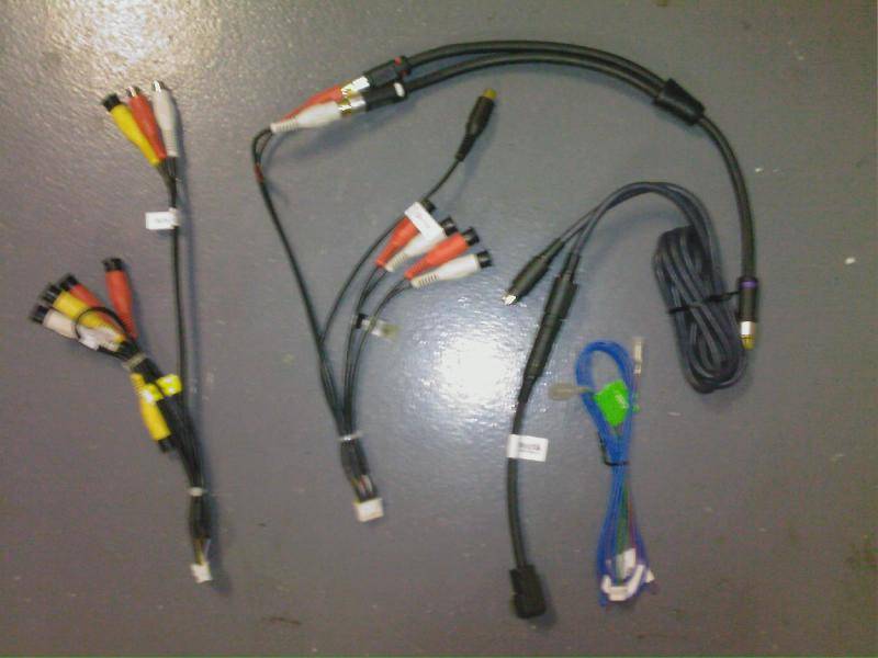

After that is done, I still have to plug in the following plugs: MIC, Voice, iPod audio mini plug, iPod video mini plug, GPS antenna, USB ports, Sirius radio adapter wire, sub/center RCA's.
And... these cables in the last picture go in too.
I don't know that all of this is going to fit! Of course I only want 1 or 2 items off of each cable (but it all has to plug in just to get the 1 or 2 that I want...) otherwise I wouldn't plug in some of these.

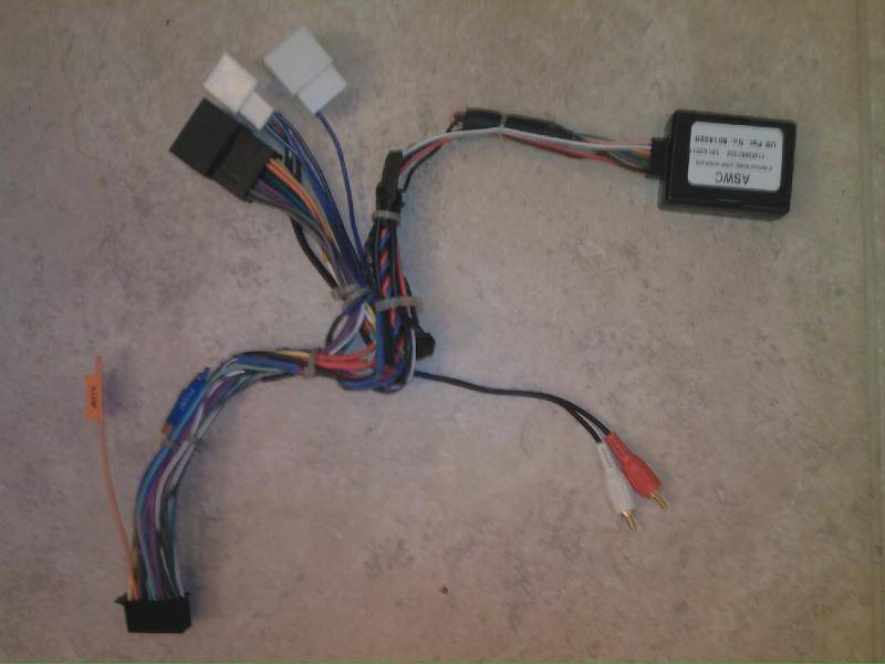

Back to researching the Metra Axxess ASWC...
The Metra Axxess ASWC Steering Wheel Control detects some of the new Kenwood line of HU's as JVC (thus nothing works automatically via auto-detect).
I have read that you put a resistor between the ASWC and Pin14 of the 20-Pin car's harness... in the White/Green wire, then it will auto-detect Kenwoods correctly... then you remove the resistor. I have read that it needs to be a 12,000 Ohm resistor (also read it needs a 10,000 Ohm, and read that it needs 1200 Ohm resistor). Seems like the common agreement is that it needs a 12,000 Ohm (12K) resistor. I went through all my resistors and could only come up with or make: 10,000 or 11,000, or 11,200 or 11,500 or 12,200 or 12,500. I didn't want to take it out and rewire it anyway.
After much reading here is how to manually program the ASWC. I have made this much shorter than the manual. I documented it for a Gen1. You can manually program it for a Gen2, but use the manual. The Gen1's have less buttons on the steering wheel than a Gen2, so the programming will be slightly different.
Metra Axxess ASWC manual programming for Kenwood HU's on a Gen1 Lincoln LS

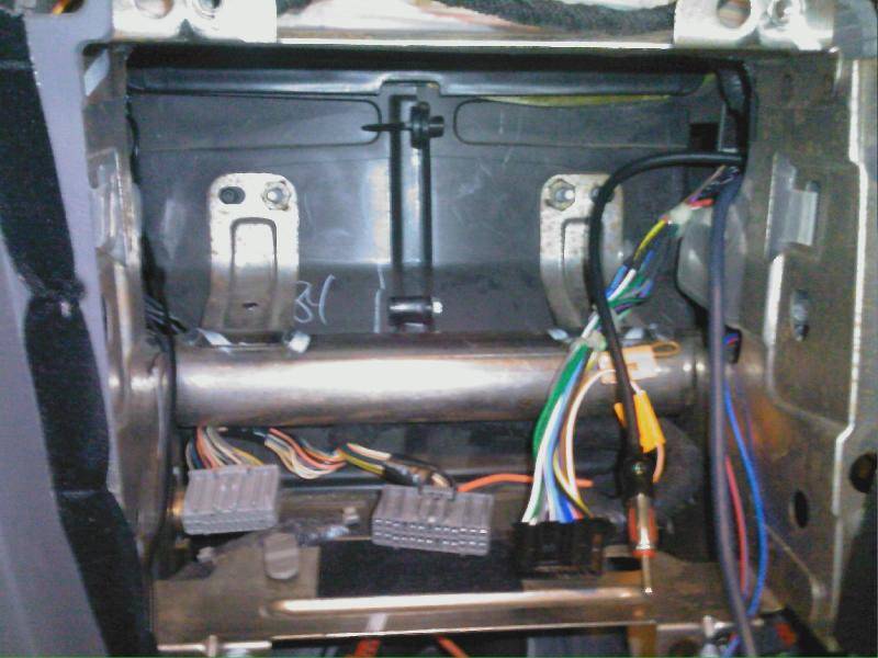

I changed the main HU harness to make things longer, changed the Illumination wire that I did with quickconnects to solder, made the power Run/ACC wire longer and put it behind the glovebox area so I can work on adding the RAP feature later without pulling the HU. I got a Metra 24" Antenna Extension cable (44-EC24) and then I was able to put the 3 main car harnesses, antenna, ASWC, Parking override etc in behind the glovebox area (I am able to pull the HU harness & antenna wire out and push it back in). This allows me to add a different antenna someday without pulling the HU, and it cleaned up the area behind the HU for the other cables I need to run.
Before/After pic below.

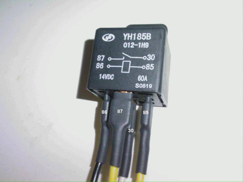

none of them knew how to change the RAP power w/negative trigger via a relay or whatever etc.
switching polarity from neg trigger to positive with a relay
87A - no connection
87 - 12v+ constant input
30 - output to the radio's acc wire
85 - 12v+ constant input
86 - input from neg trigger wire
btw, good job of tucking everything out of the way, getting everything to go back into the dash can be one of the trickiest parts, that should help to make that as painless as can be.
Great work!
Thanks Hite!
87A - no connection
Thanks for the info! I was on the net looking at diagrams and the like and they mentioned those connections. I bought a relay today just in case at Radio Shack... it has 4 connections (no 87A) - YH185B 012-1H9.
http://www.radioshack.com/product/index.jsp?productId=3020762
Something like this then? I just soldered it up... (ran out of proper color wires)
86-My Black at relay from moonroof RAP, 30-My White at relay to Red Kenwood HU ACC
87 - 12v+ constant input (Yellow wire from car's 16-Pin harness)
30 - output to the radio's acc wire (Red "Ignition Wire/ACC" from Kenwood HU)
85 - 12v+ constant input (Yellow wire from car's 16-Pin harness, or jumpered from "87")
86 - input from neg trigger wire (RAP wire from moonroof Gray/Orange or Blue/Black)

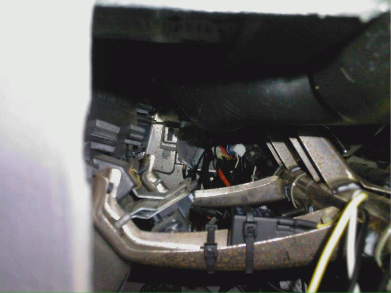

I hooked up the Relay in the car:
86-Relay from Blue/Black wire in C-Pillar Moonroof harness.
30-Relay to HU Run/ACC wire has nothing when the car is off, 12V when the Ignition Key is at ACC or Run, 12V when the Key is off and/or the Key is removed, and no voltage when the door is opened.
Thank you 1LoudLS and Joegr for this help! It's a RAP!

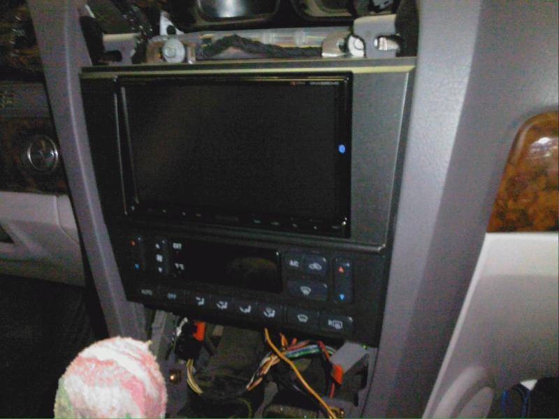

Now to tuck in the cables, install the HU in the dash, button everything up behind the glovebox and put everything back to normal. It's time to actually install the HU!
Your install is coming along nicely. Very good job in the glove compartment! Cant wait to see the finished product.
Install is looking clean so far!
super clean, looking great
Impressive install, LDM - very thorough and quality work so far!
Thanks Guys! Hopefully everything's gonna be all right!
Getting closer. Adjusting cables right now etc. This might go a little faster with another person, but it's getting done (a lot of in and out of the car etc). Found a spot for the Relay. Above the glovebox on the right side there are some metal supporting braces, it has a hollow trough with a hole. There is a mounting hole on the Relay. I put two zip ties through the metal brace hole with each going through the Relay hole, going around the brace from each side. The top edges of those braces are kinda sharp, be sure to add some extra protection on the wires when they come out and over the top of the brace. Here's some pics.

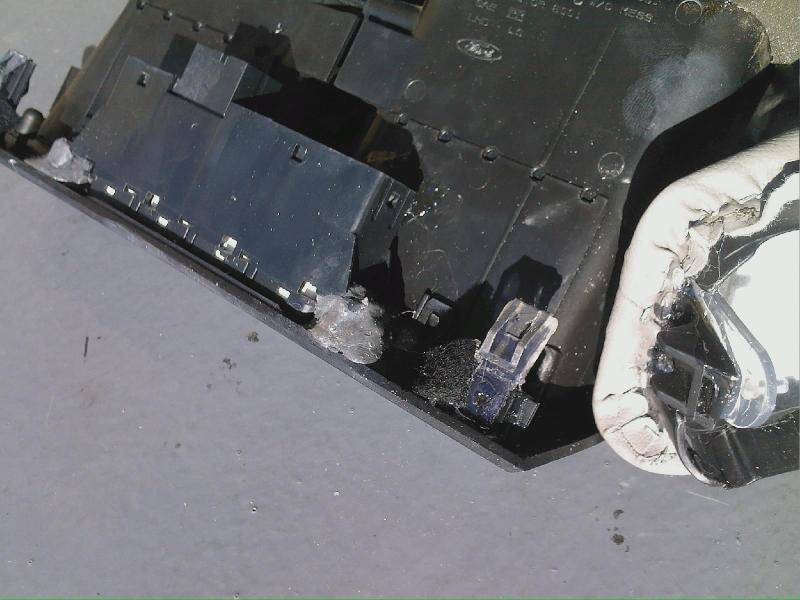

Someone has been in behind the center dash before. One clip is missing/broken off the top vent, and the buttons on that vent where they were screwed on originally have been glued on... that came apart/off too... guess I have some repair work to do on those buttons. Don't know about fixing the one vent plastic latch...
Thats the fix for the buttons is glue.
Try and buy the part from ford and see how much it costs.
A sh!t ton!!!!! Around $240 if I remember right.
