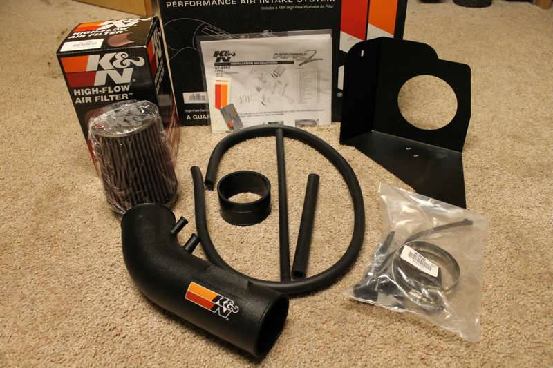

Got mine today, just finished installing it :D Sounds just a bit different from my KKM with custom shield but looks way better.
Couple things that it doesn't say in the instructions that I had to do. I removed my headlight (probably wouldn't need to if you have the right size wrench). The two rubber tubes and the rubber seal need to be cut to length. When I went to install the U shape bracket it didn't have a nut for it. The directions don't show one so I found one that'll fit. Make sure to install the mass air sensor to the tube before installing the tube, if you don't you'll be taking the tube back out ;) Everything else went smooth.

Got mine today and installed it tonight. i too was missing a nut but you will have an extra from the left side of the air silencer so no problem there. It is definetely louder, especially around 2500-3500 RPM where it really growls. After taking it for some spirited driving then checking my hoses i noticed that while the engine bay was hot the tube and the metal on the filter itself was ice cold, showing the cool air intake working like a charm. Very happy with my purchase, thanks again for putting this together!
I just received mine. I thought the heatshield was going to be plastic, like the others I've seen in stores.
