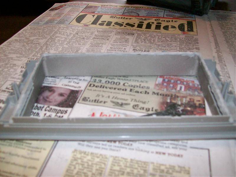

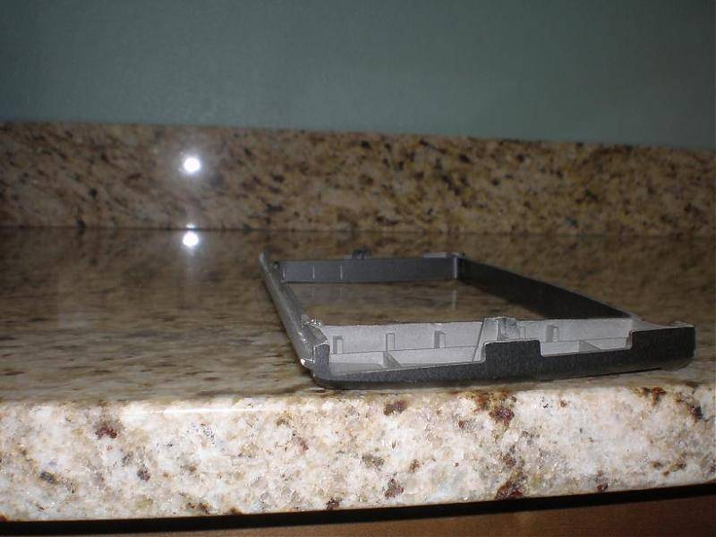

Ok, I dremeled the bezel, but I need to know if the top lip needs to be taken off. As you can see, the Kenwood doesn't quite fit in yet. And I need to be certain not to risk another 80 bucks for another bezel. :p Thanks ahead of time.

I cut slits in the 4 corners of the bezel to get the bezel opening to flex to open more.
Can you slide the kenwood sleeve in through the front of the bezel? That is probably what I would do, but then again it might not work because then it might sit to far back in the dash. I would love a double din but I just traded an iphone for a kvt 815 kenwood DVD and a rear view mirror with a 4'' tv in it. Still haven't put it in waiting on some parts to come and the pioneer deck I have now can push all 6 speakers just fine. I will need an amp for them once I put the kenwood in.

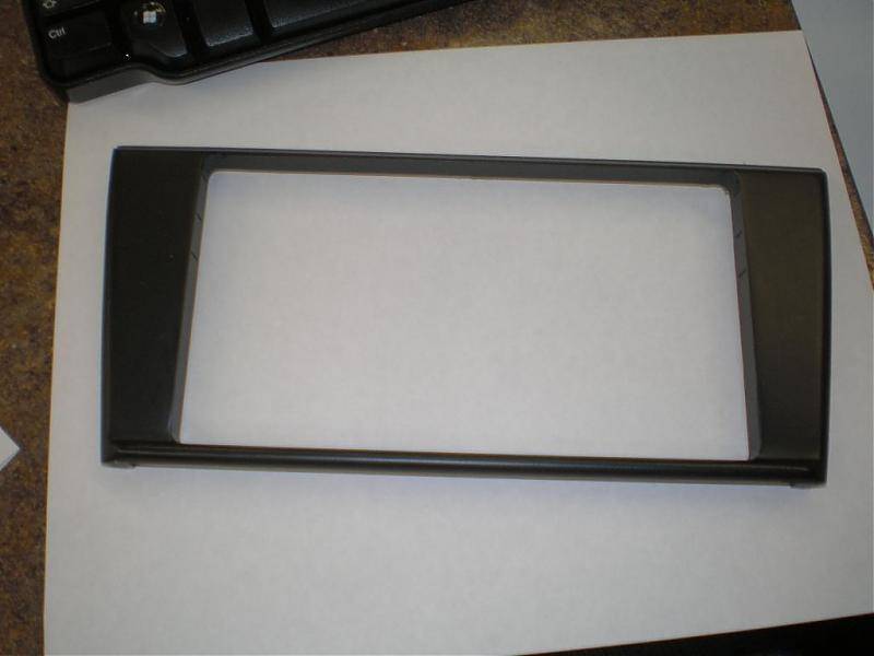

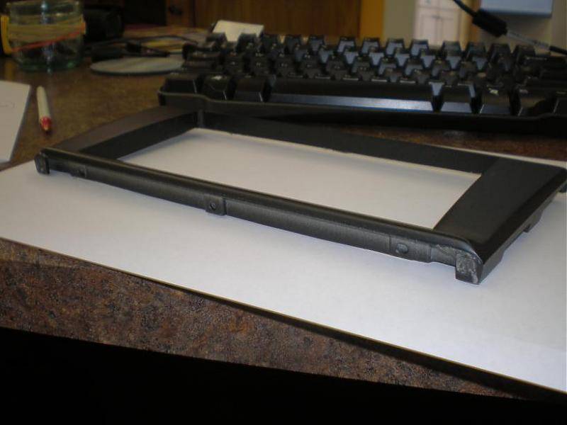

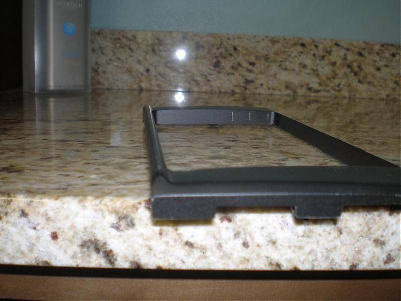

I just went out and took off my bezel. Here's how much material is left on mine. I didn't have to make relief cuts, but the unit I have is slightly smaller in size than the avic d3.
Oh, and I'll add that you won't be able to use the sleeve on your double din. You're going to have to re use the factory brackets off your factory head unit, and probably have to drill new holes into the bracket to line up with some holes on the unit itself.
Try small slits in the corners...then get progressively larger as needed. be careful
he may not need them though. If you do decide to make relief cuts, do them from the back side

Yep. If you check out the bottom of your bezel, you'll see the three holes where it locks into the pegs on top of the climate control. The material is removed almost all the way up to those 3 holes.
I just noticed that it's in the 3rd pic I posted. You can sort of use those 3 holes as a guide for how much material to leave all the way around. Of course, you can leave more if you like, but it's already a tight fit getting the damn thing in there. And I didn't want more crap to get in the way.
