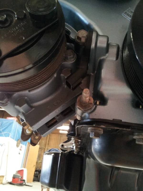

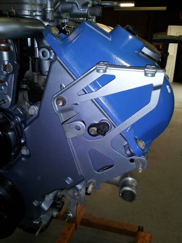

Here's a shot of your sensor, if you haven't done it yet
All 3 can be removed with a 10mm socket and a foot long extention. Turn the wheel to right lock
You don't have to remove the bolts, just back them out about 15 turns, should give you enough room to get a shallow 8mm 1/4 behind the clutch
No haven't done it yet. Bought the part from ford though. Ill be on this tomorrow. Thanks for the pic and link.
