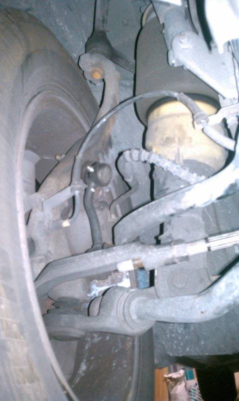

get the car up and take pictures, or tell me where you're located and I can send you to one of my shop for a free visual inspection
