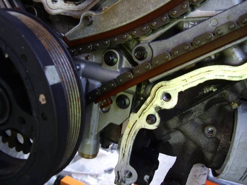

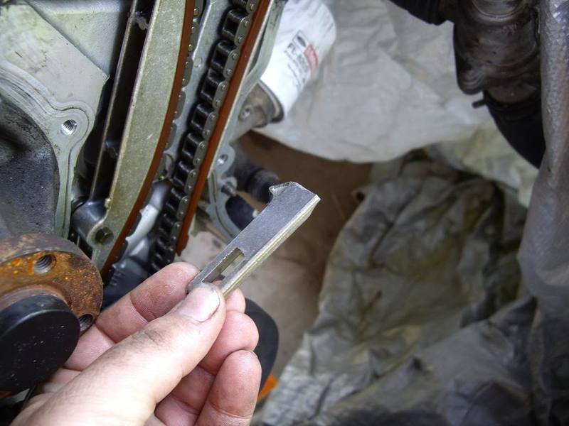

So as I was detailing the parts today I grabbed the oil pan and started to scrub it down. As I turned it upside down I hear a clattering sound...... :( ...... I reach in the hole and find this:
A gawd dam timing chain guide chunk! :mad: I look at the timing chain right where I knew it would be.
Looking in my pictures of when I first cracked it open I see that chunk is missing from before. That was my fuggin noise, engine is just fuggin fine! I am so fuggin pissed!

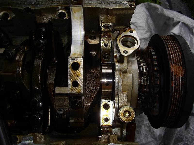

No, not positive but if you saw the inside of my motor then you would know why I am 90% sure. The motor is so clean inside! I took off two connecting rod caps and the bearings are almost perfect! Couple light scratches but cant feel them with your finger. No discoloration at all as well. I kept saying over and over it was timing chain guides but got sidetracked when I saw the broken gear so I neglected to completly go over the guides. I am so sick right now.

I wouldn't be suprised if the plastic tensioner had broken right where the metal part is and you were metal to metal that you could have that noise, but i'm still betting on main bearing...

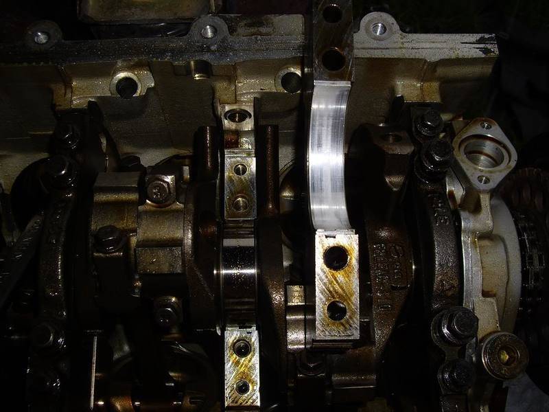

Well only three left to check. It started raining sideways so I had to cover it back up.

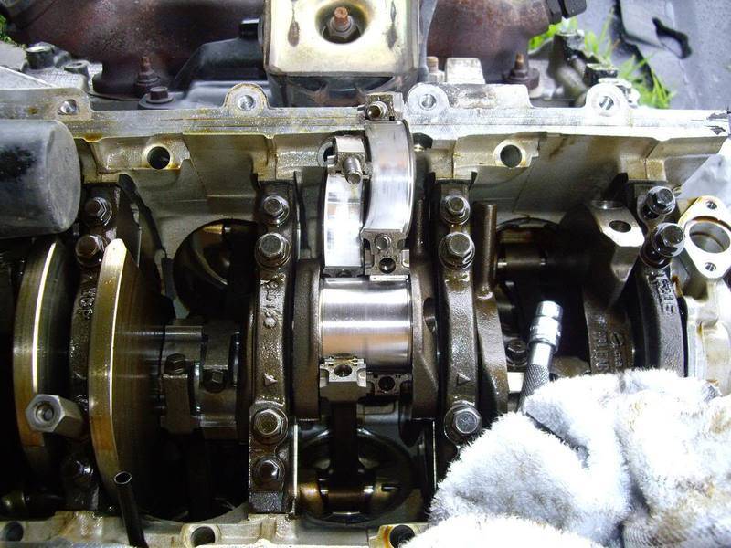

Pulled the front main and the second one. I also pulled rod bearings for pistons 1,2 and 6. I have to spin the motor to pull number 5.
I am by no means an engine guru but it looks pretty good to me so far.
They do look good so far... I just can't believe a tensioner like that making all that noise.
I have to go with Dan on this. All that noise from the tensioner? Does not make sense. I think if you were to fix the tensioner and put it all back together and in it would still make the noise and let go if you drove it. Getting deeper into the motor as you pull it completely apart to build it the true culprit will show.
