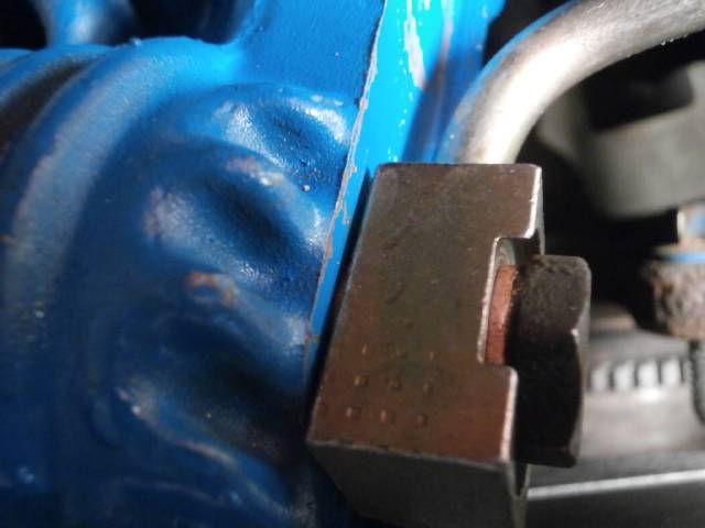

unbolted it from the spindle- nothing obvious, may be leaking from upper piston given the trail down the bracket...looks really dry around the banjo, and the bleeder....whats the max recommended tork on the BB? if it leaks from around the piston, r/r the piston?

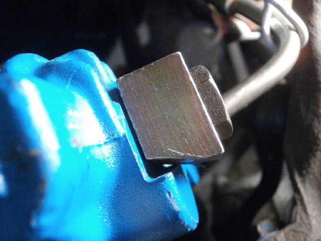

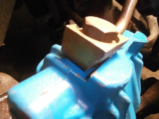

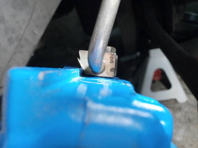

this is the front pass side, where the metal hose end was modified to fit the caliper...may be related
I thought practice was to modify the caliper, not the hose end. You didn't possibly grind a hole thru the brake line flange?

That block on the bottom of the brake line that you ground on. You didn't grind off too much and grind into the fluid cavity, right? That would definitely cause a leak.

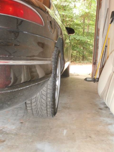

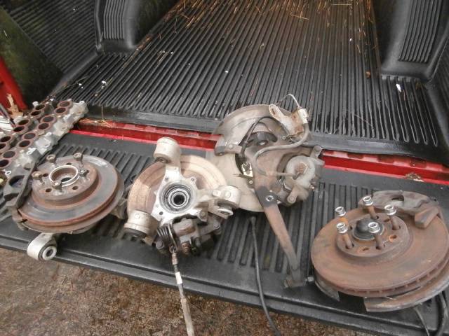

went to get it aligned today and got bad news, the drv side rear LCA camber bolt was maxed out and still needed to go more, they got it to 1.25, it should be 0.0.... pulls real hard to the right; undrivable really
these parts
came from a wrecked mark VIII, a car that got T-boned in the middle of door, totaled....guess which side of the car was hit
:slam
now I gotta pull the old knuckle from the half shaft and do a rear hub mod in earnest....dam
or...just use the already re-drilled hub and bearing from the bent knuckle, and put it in my good (original) knuckle?...easy peasy?
Camber will not cause a pull. Also, if your mark is lowered, it will be hard hit the "green" zone on rear camber. I have done many alignments on marks and tbirds, that is relatively normal. As you lower a mark, the camber goes more and more negative.
What did the other side align to? If that knuckle had been hit, I would think you would have toe issues, but camber isn't going to cause a pull, especially on the rear.
Try rotating the tires front to back, bad tires can cause a pull. Leave that knuckle alone, you have a different problem. What is up with the way that it drives that makes it undrivable?

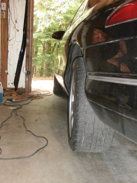

----fwiw, when I first put the new wheel/tire on the rear drv side it looked crooked to the naked eye, but I thought it was an illusion b/c of the different offset

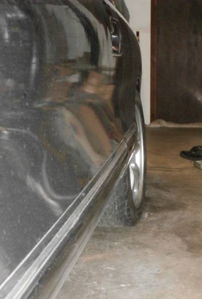

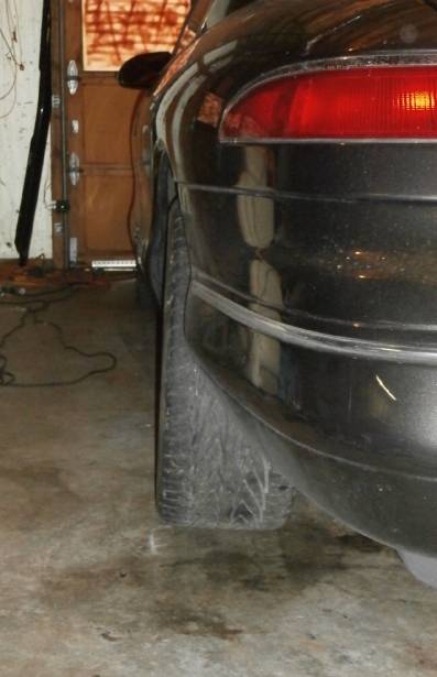

this car, eh...this KNUCKLE, was definitely slammed into on the driver's side (si?)
my GOOD side

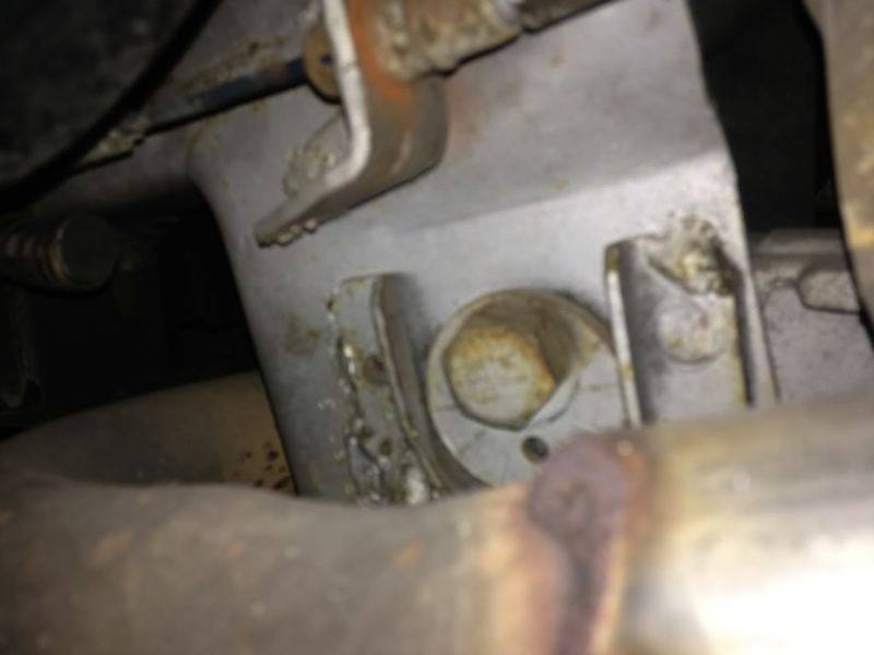

I called another shop, they also claimed the LCA to frame camber is the only adjuster for rear alignment. WTH? what are the adjustment points for rear alignment? UCA bushing? shims?
that is a toe problem, not a camber problem.
adjustment is there. most alignment guys don't even look for it cuz they are lazy or something.
wrecked car= wrecked parts= pulls hard to the right

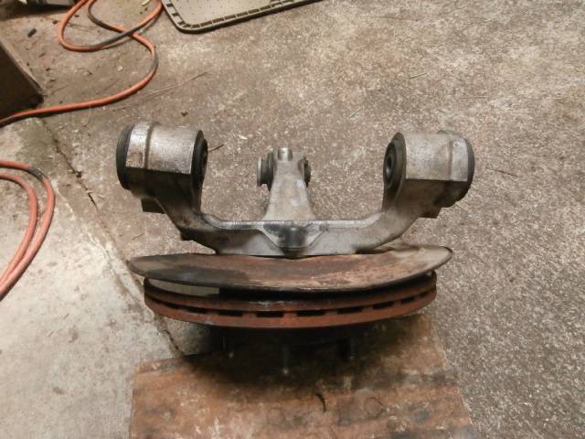

is removing the 4.5'' hub/bearing from this bent knuckle and pressing it into the orig/STRAIGHT knuckle a job I should take on? can that bearing be re-used after removal?

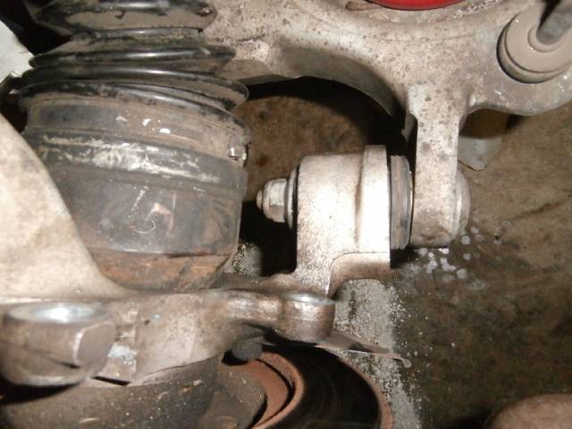

That sure looks visibly bent. :(
If you have a press and proper tooling, it's a straightforward job. Pressing the old one out is pretty simple. You do need to support the knuckle properly to press in the hub correctly and make sure it seats in all the way.
That is the rear toe eccentric. It butts up against the rear exhaust pipes.
That does look really out of whack. Did you see any of the pictures of the car they came off of? Did you verify that the collision really didn't hit the wheel. I would think if the wheel was hit hard enough to bend the knuckle that the wheel would be damaged too.
Did the bolts go straight thru the bushings or did you have to fight It at all? I would also think if it was bent, you would have had to fight your non-wrecked control arms.
yea, I saw the donor car, I pulled other parts from it and someone else pulled these parts later on.....that car got HAMMERED in the collision, right in the middle of the drv door, the front and rear fenders on that side were not visibly affected ...the lady Mark VIII driver walked away unhurt which surprised me...
when I was putting that knuckle back on I kinda thought something looked screwy and not straight, but I just wanted to keep moving fwd.
was it a 'struggle' to get it together? haha...yea, most car repair tasks I take on seem like a struggle and getting the lower bolts around the outboard end is def a 3-handed chore...I'm not a real mechanic! :shifty:
And again you don't have to pull the bearings. Just push out both your hubs ONLY and put the 4.500 hub in your old good knuckle.
right about now the tech is prolly still pissed...thus far he hasn't been able press that shaft thru the knuckle.He's in a fully equipped shop with a (20 ton?) hydraulic press...
they sell tires- so they will get the cv shaft out, then do the switcheroo with hubs/knuckles (HUBS ONLY), then I'll put it back on the car...
