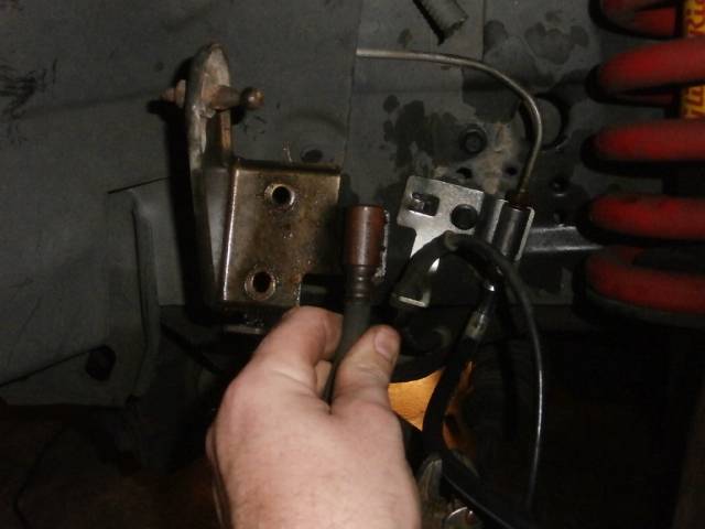

saved a few $ on new hoses: bought t-birds instead of Marks; rears are fine, front brackets are different

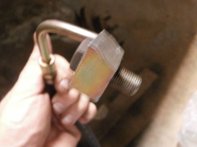

pass side brake hose end must be reduced to accommodate PBR/Cobra caliper

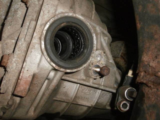

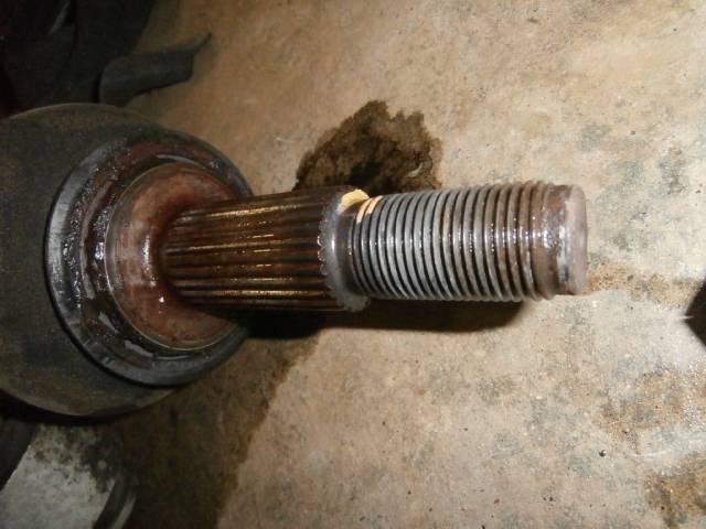

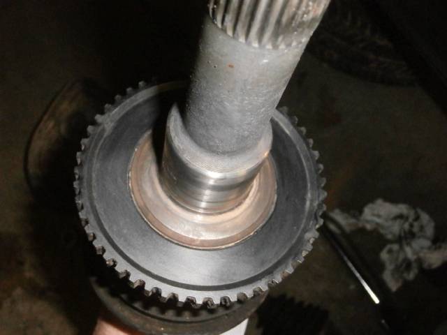

pulled the half shafts out...how do I remove this (lip?) bearing seal?
pass side

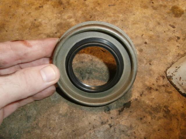

here's the replacement part from Advance Auto: 'National' #100357... I don't think it's the right part, don't see how it will work
You can use a seal puller. Or a large flat head screwdriver to lever them out. I don't know if you can cross ref but I use National seal # 714569.

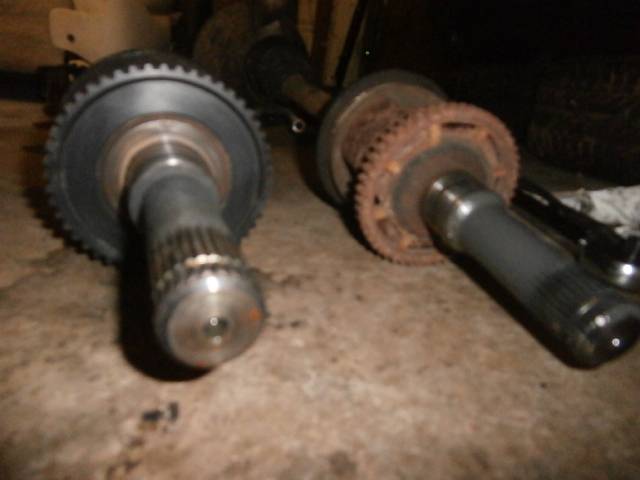

---95 southern on left, 96 northern on right
yep, the seal I have (100357 is for F-150's) :slam

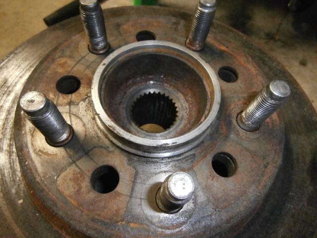

Here's the 4.25" knuckle removed

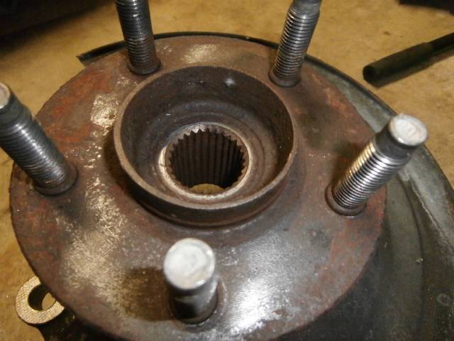

and the 4.5'' knuckles i bought used, with old Mark VIII rotor still on it

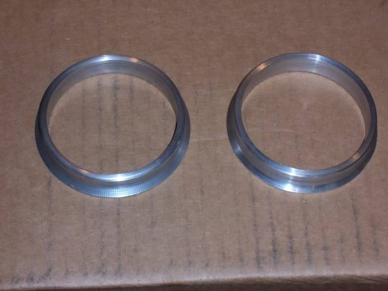

I wonder why the prev owner put the larger ring atop the rotor? it's bigger thean the Mark VIII hub by about 5/16''...every time rotors are changed the ring has to be popped off then pressed back on?
Those are HUB CENTRIC rings. The rims the previous owner had on those hubs had the OD of the rings as the ID of HIS rims. Meaning those rings fit snug in the rims he had on those hubs.

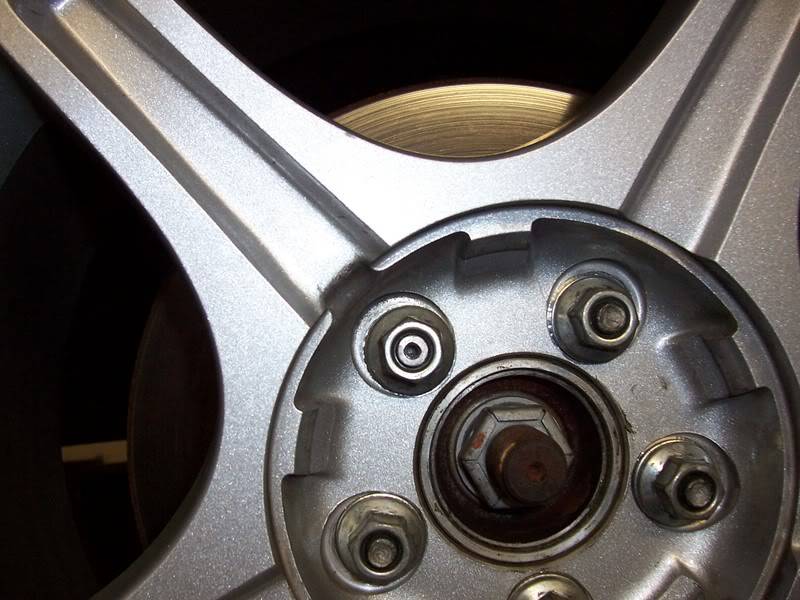

Here you can see the ones I made to use with 99 Mustang rims I put on my car.
Here you can see them on just like yours.
i ended up using a 3' crow bar to get behind the seals and lever them out....any reason I should't r/r the bearing just inside there? I think I have the part from a barely used locking carrier I bought recently...
eh, now that I think about it, I also have 3.73 gears I'm hoping to use...so NOW is probably the time to do that mod as well? ....
Well, if the shafts are out already, then yes it will be cake town to r/r the diff.

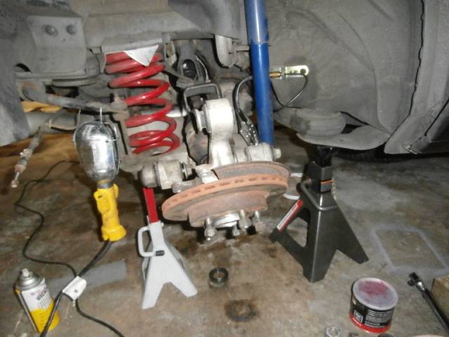

in reattachng the knuckles (@94-138 ft/lbs) to avoid bushing wind up, should I remove this stand under the subframe and load the suspension before torking the 2 LCA-knuckle bolts?
I found a 93 tbird diff, but its a 3.08, quoted 500 to rebuild my diff, labor only...so not doing that now
finally looked to the fact serv manual for reinstalling half shafts and knuckles.....
-hoist just from the frame, so i moved my stands to the side rails further up fwd on the car
-LCA carriage style bolt heads (T-50 pan heads) should ALL be to the trunk side of car per bushing design..torked to about 110-130 on unloaded rear susp.
-put front bolt in the LCA knuckle first, then rear bolt; metal washers between LCA and knuck ; i used a flat bar to lift-pry the outboard end of the half axle and get it tied together, def could have used a 3rd hand here

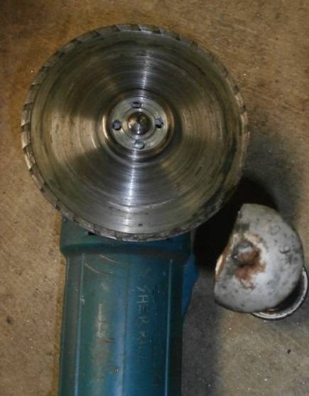

FWIW your 4 1/2 grinder will work better with a abrasive wheel that is made to cut steel.
