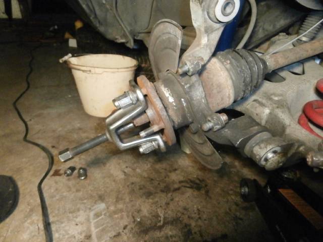

ready to dive into it, got the tool as a rental from Advance
just push the axle in little-by-little until the bolt clears the underside of the axle?
no need to loosen any bolts at the dif end of the axle?
can't free the half shaft from the hub, 'bout ready to crop the bolt head :mad:

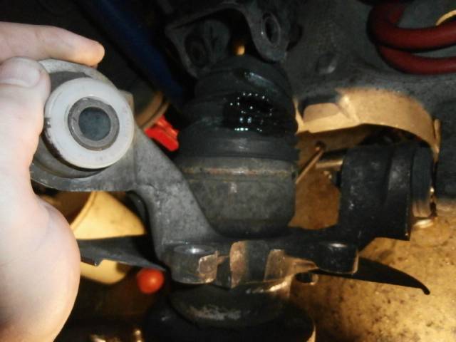

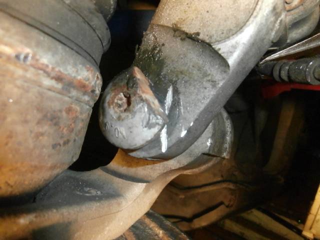

well that went pretty bad:
cranked on the hub puller press with probably at least 150 ft/lbs but the half axle never moved back out of the hub,
so I used my angle grinder to clip the bolt head, but not enough to remove the bolt, it's still in there
also f'd up and cut the grease boot at the end of the half axle
now what? I think the hub-axle are rusted solid? take the half axle off at the diff
right now I'm just about ready to give up on this :bsflag:
