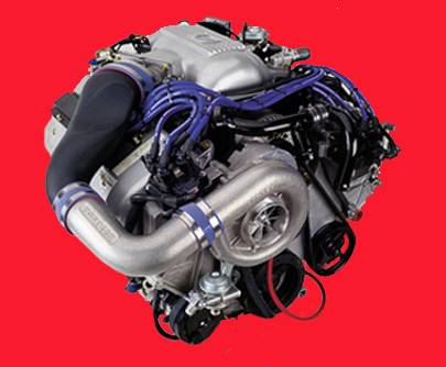

I feel silly asking this but what exactly is a centrifugal?
it is a turbo style supercharger that builds boost at higher rpms,instead of having lots of boost down low it needs to "spool up" to build boost, like a turbo.
vortech, pro charger...a belt driven turbo....snail, a different type of s/c all together. I don't see you getting s/c'd for 5k, but i might be wrong. The other thing to remember is that even after the s/c your going to need a stronger trans and a better driveshaft along with all the little things needed to make it work pushing your budget even farther. That being said, if your motor runs fine see my earlier post. updated tranny-4:10's- track lock -driveshaft-good tune. Then if there is money or you want more get a cobra intake and a centifical s/c. Or get a c-head motor to drop in with a different gear set(3.55-3:73) then get a roots blower if you have the money. Either way make the motor decision then build the rest.
ok well i know i dont want a centrifugal thingy majigy...
laser will that be the look yours will have when completed?
no, a kb looks like his sig pic or mine. a twin screw sits on top of the engine and replaces the intake.
