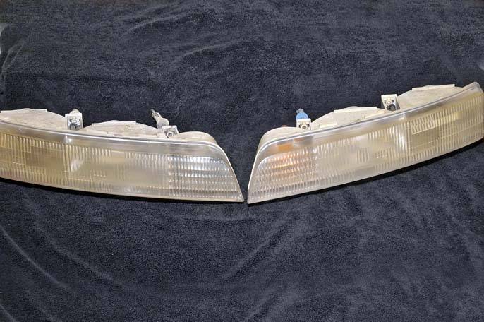

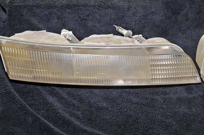

It's worth the $100 to just send them to Jamie. There are a lot of pieces that have to be cut, not to mention the whole front of the housing and then getting it sealed back without any condensation ever building up. I have a set that have never been done. They came off the 93 and one is in pretty good shape and really doesn't have to be done but the other has slight chrome peel on the bottom of the low beam area. I'll get some pics up of them later but I'm selling them. $100.00 and free shipping in the US.

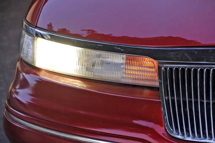

I have done a few sets too and it is just time consuming, not difficult-I used a holesaw (like what you'd use to do a keylock hole) in the bottom of the housings and 'rechromed' the insides with trimbright-the piece I cut out was then taped back into place with duct tape, and then I used 2000 grit sand paper, then polishing compound to polish the lenses-they look like new, just need to polish them occasionally to keep them nice. Not rocket science.:D
i dont understand how anyone could rechrome the insides of a housing by using a holesaw and going through there, it cant look that good! cutting off the lense is the way to do it if you want the rechrome the entire inside.
worked for me, didn't take hours to do, they look perfect, no condensation and if I ever need to fix them up, they are easy to open up, you cannot see the disk I cut out (it is still there, just held in place with tape). Unless you remove the headlight and flip it upside down, you'd never know it was done that way.-and they didn't cost me $100 plus shipping and down time.

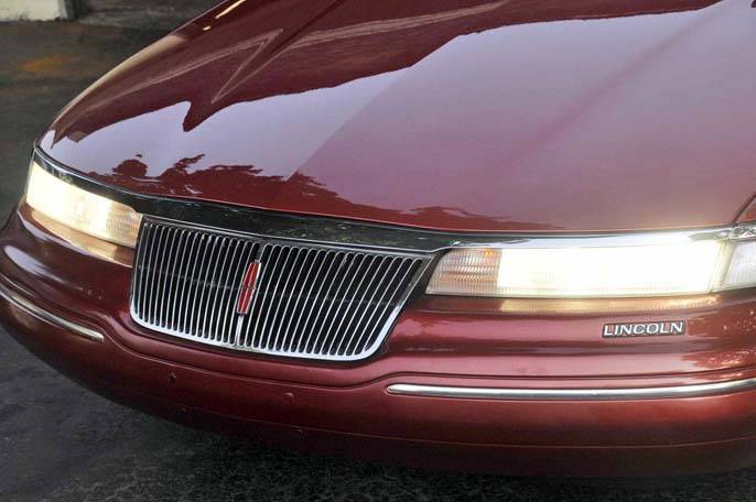

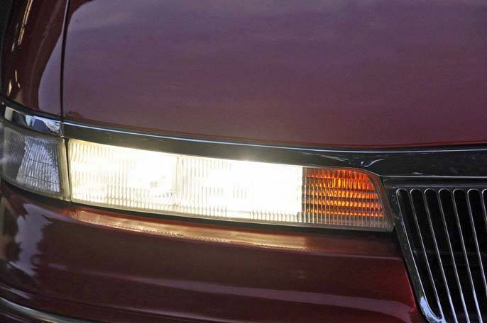

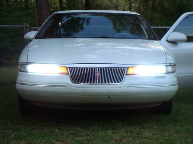

befrore and after, 5000k hid's, high and low's...now die:D
I personally wouldn't call those "perfect", but they don't look too bad.

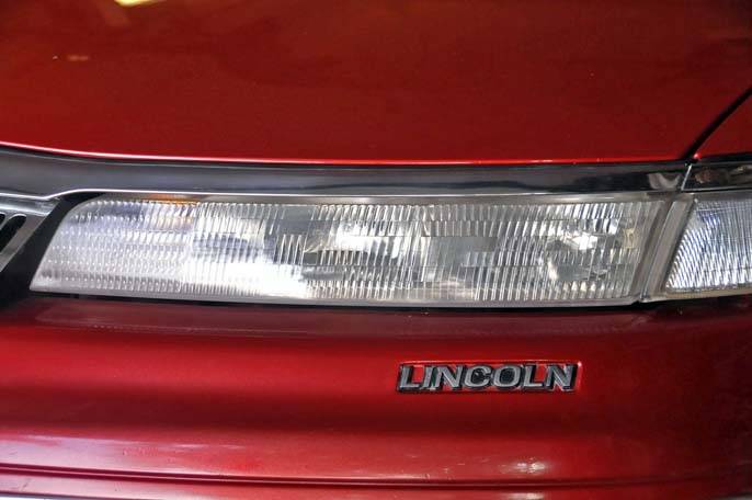

I sanded mine with 500 to get rid of the old clear, then 1500 and 3000. I cleared them with SEM 21013 UV clear. They look pretty good, i didnt do the inner chrome though.
The clear should keep them from fading again for a while.
These are new housings with 8000K in the low beams and 6000K in the high beams but now I have 10K in the lows.
Those in the pic on the red car sure are looking like some halogens to me.

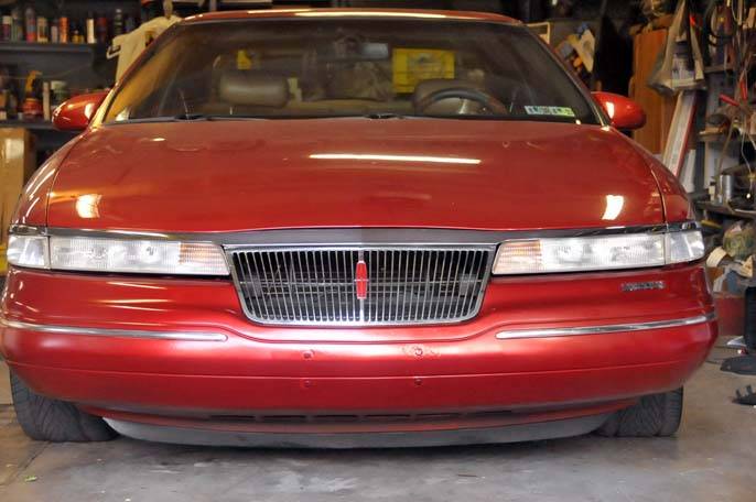

And by the way, as you said, "reading comprehension"..... I bought new housings. NIB, not cut up :q:q:q:q or rechromed by anyone. Yours still look like halogens with a buffed lens. Yes, I paid $166 each to have new and have another new set and another set that will be going to Jamie soon. Seriously, if you want to cut holes in the bottom of your housings, I could care less but a point I have to make is that they don't look as good as they would coming from Jamie. Has nothing to do with sticking together, it's just the :q:q:q:qin truth.
