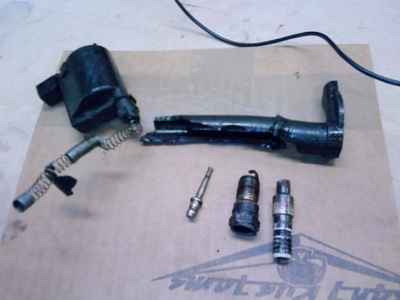

wtf???????? few weeks ago, our navigator started running like it had a weak or dead cylinder, then it fixed itself. little while later it started doing it again, then the sevice engine light came on. pete had autojoke scan it, said #2 misifre, so last night i changed it, didnt fix it. last week the truck had what i thought was a lifter tick, a low oil sound, but that went away too, well i was getting pissed so i pulled the coil cover off the pass side valve cover. if you havent worked on a 5.4 dohc in a navigator do not try it. holy :q:q:q:q what an engineering marvel. so, i got the coil cover off and instantly i see what appears to be 3/4's of a coil boot on top of the coil, wtf? i pull the #4 cylinder coil out and omfg lolololololol this is what was waiting for me inside the hole.
so i went and grabbed a new plug, luckily the plug failed , but the threads didnt rip out of the head, the bottom of the plug was still threaded in. i put a new plug in and new coil and the truck is running way better, but it still has a sputter, i'm thinking i should have checked all 4 coils on that side, i think it might have another dead coil, it does have 218k on it and all the coils were original. what a piece this truck is, i hate the thing.
.......hmmmmmmm bosch plug? looks like it to me, very common problem with bosch. i cant stress this enough

i had t he same thing happen to my 97 lsc i had diamond fire e3s in and about 4 months later the wife was in des moines when the car acted up, she took it to a service station and the number 5 cylinder was missfiring they pulled cover off and sure enough it had blown plug out of hole and shattered coil pack and spark plug lucky nothing got in hole or stripped it out i ended up changing out all the e3s and put it autolites becuase 4 out of 8 were loose and i tightened them checked them a couple months later AND the same ones were loose again , i think the e3s are great when then were first put in but i would never put them in my Lincoln again !!!!
I love the E3's. They work great. The problem is with the COPs themselves. The need to be changed out along with the plugs. If the COP's don't have a nice tight grip on the top of the plugs. In my last Mark, (Gen II) cylinder 7 blew out like a ballistic missle. The COP was obliterated, and I needed to sleeve the cylinder. My mechanic told me I needed new COPs. So a phone call to Max was placed. Definatel worth replacing when buying these cars used.
KK what you dont understand is the navi is my father in laws, and because i married his daughter, and can fix cars, i have to fix his pile of :q:q:q:q for free, but i told him i was not doing the front end, i was too busy to work for free, i have paying jobs in the shop. i let my buddy jake do it, and told pete he had to pay jake. and chicken that blown plug is an motorcraft, looked original, i cant be sure but it looked it. the number 2 coil is still coming up as a misfire, i changed the coil next to it, the one that broke, so tomorrow i have to turn into gumby again and get back in there and take off the #2 coil and see if its dead, it better fix this thing because all it took was a few hours on this thing and my hands are all cut and ripped up, i can work on marks all day long and not get even a scratch. and for ever said you'll take it off our hands, we'll gladly sell it to you, thats why he wanted it all fixed he wants to sell it.

Plus, if it's original then it was in there for far, far too long!

IF I may add, what people with cop cars need to do is monitor the cop boots, for condition. This is what causes the misfire, and will eventually lead to coil pack failure. You can buy them individually from any autoparts store. Even comes with a new spring to boot.
never seen a motorcraft blow out, if its original it will have a paint dot on the top of the plug
