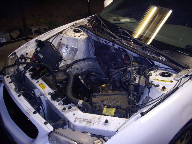

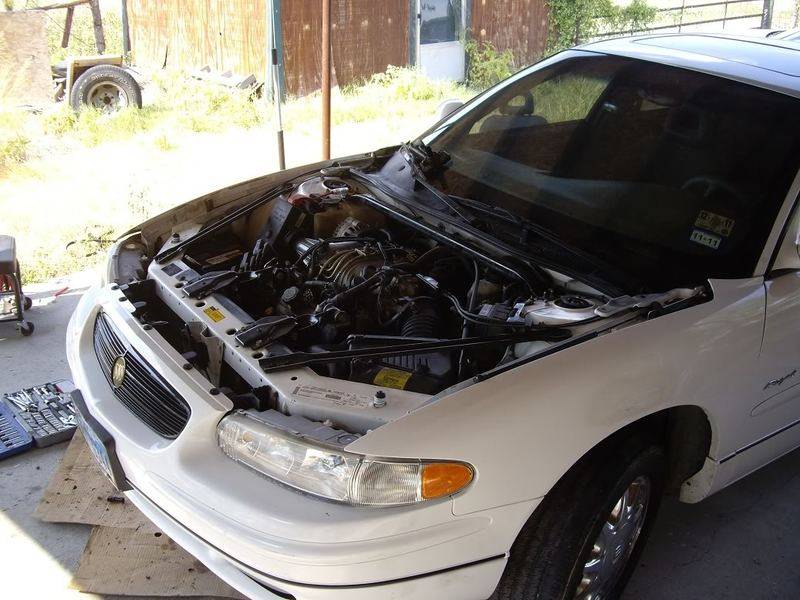

Well hell. Thought I was ready to pull the motor but after wiggling it around I realized there must be a hidden bolt. The damn bolt under the rear manifold is the one thats kickin my arse. I need another 18-24" of extension so cant do crap till my buddy can bring his extensions out. :( Other then that bolt the motor is just kinda sitting there. Oh well, there is ALWAYS one thats a PITA to get too.

About 2 minutes. I kinda cheated though. The Regal forum has a real time chat window at the top of their page and as I was navigating I saw someone say something about a hidden bolt and someone else say it was under the manifold coupling. As soon as I saw "manifold coupling" I figured they were talking about a trans bolt. When I removed all the bolts I could see and the motor and trans were still together I figured that was what they were talking about.

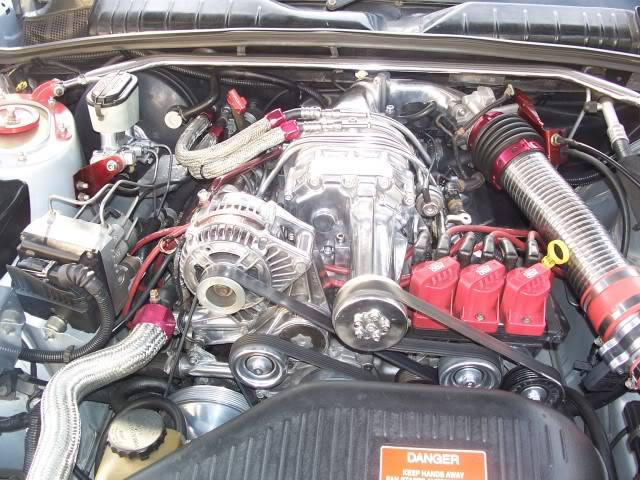

Power per dollar in modding potential, to save money on repairs and depend on the reliability, or to just have a solid brick of an engine for a beater, any day over, almost any platform, I'd take a 3800 powered car. The 3800 is legendary. To knock it is to knock any stout and dependable engine that still has performance potential while utilizing tough, tried and true (albeit outdated) technology. Just like the ford 4.6 or 302/351w, or 4.3 or 350 chevy, not the best at anything, but good at most things. The 3800 series II and up were very capable at almost all jobs asked. Nothing to sneeze at and surely nothing to mock. My GTP was quicker than any mark viii, stock for stock, got better gas mileage, and needed less maintainance and repairs. I like our Lincolns just as much, but there is nothing but love for the L36/L67 from me. The actual car the engines were dropped in, there were a few at which I scoff, but just as soon as a Mark VIII I'd take a Regal GS, Riviera, Grand Prix GTP, or Park Avenue Ultra.
True they are fairly stout as long as you address the intake gaskets. Repair parts are cheap and performance parts are way cheap.
$125 for a tune, $60 for a pulley and $170 for some headers and they make 50-60 more HP. All easy as heck to bolt on too. The damn computer is in the stock intake box! LMAO!
I finally got her back together! One last part needed though, oil filter housing gasket. Closest store is 21 miles and I have no car so have to wait for a friend to visit. LOL

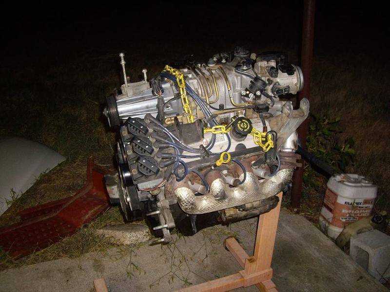

So here is what I found with the old motor. When removing its oil filter housing thick black sludge was on the lower half. Ports were completely clogged. The spring actuated port was rusted closed. I didn't drain the pan but the oil that came out of the housing showed signs of water.
So there we have it. Oil starvation from poor maintenance and a bad lower gasket had killed the motor. Bummer. :(

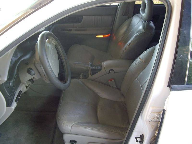

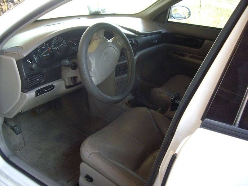

Anywho, after swapping the motor I decided to swap the seats. Drivers seat has a rip in the bolster but the bottom is in nice shape. My old seat bottom was ripped to hell. My old rear seat had a half dozen burn holes in it as did all of my floor mats so I swapped them over too. Decided to do the passenger seat as well cause the 98s leather is much softer then the 99s. Guess nobody ever leather treated it.
Swapped the couple broken dash vents too. After taking the pictures I see I forgot to finish swapping the passenger air bag cover. Still have to remove the three PITA bolts up top. Too hot to screw with now.
