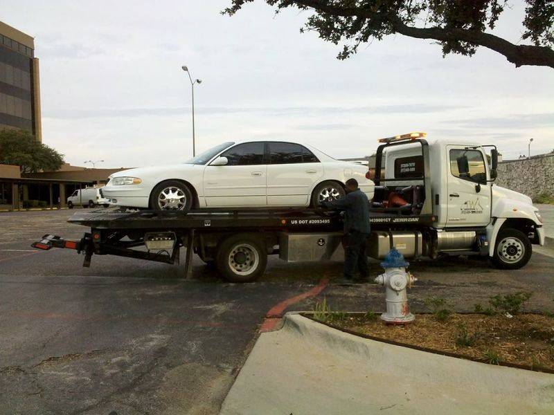

After that another friend who wanted my old wing offered to throw a tune on it. These cars (as most know) have knock issues from running lean up top. We were not doing a performance tune at all, just adding fuel up top. Didn't remove fuel anywhere and didn't add timing. Was just to make the car safer and help the engine live longer. Did a data log and showed everything was perfect. Car was pulling 6* from knock sensors and after his "fix" the car only needed to pull 1* up top. A/F went from almost 14:1 to closer to 12:1. So we go to make a U turn to come back and I hear a sound that curdled my blood. Rod knock. :mad:
I get him home and car is getting louder. As I leave his pad the car stalls and the temp is rising. Thats it, its done. I pull over and call a truck...... 110 miles from home. :( This was around 4:00PM when this started, just got home a few minutes ago.
Don't know what caused it. Oil was full and clean. Car never even hinted it had any issues. Always started faster then any car I ever had. Didn't smoke or make any noises. It just spun a rod bearing..... so I guess anyway. I know rod knock too well and its defiantly rod knock.
