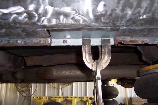

Good progress Mike, that repair area in the wheel well did you tig weld that in or mig weld it.
Mig..... We don't have a tig welder out there at the shop. But that Miller does a fantastic job, so ya can't complain. :)

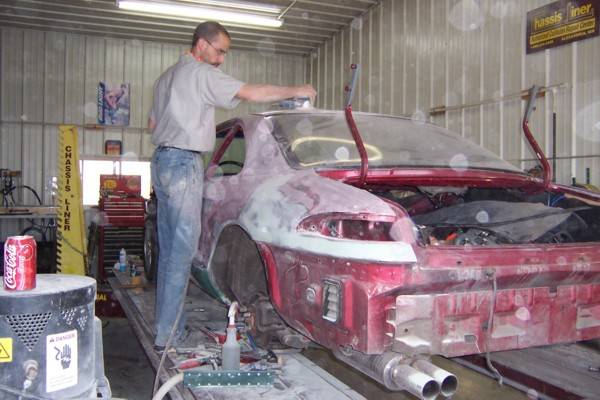

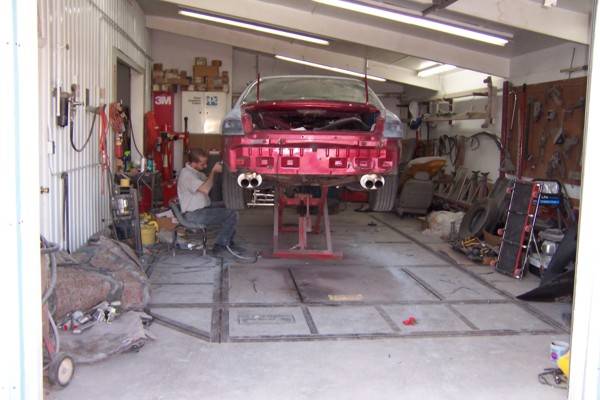

Update 04/22/06
Did alot today.

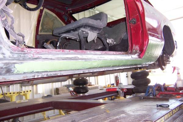

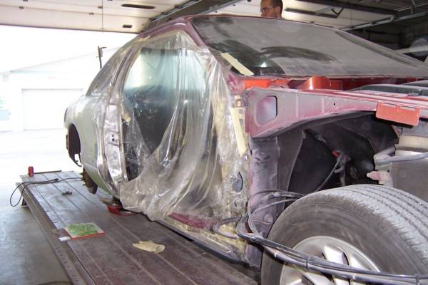

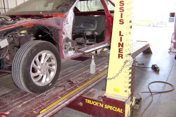

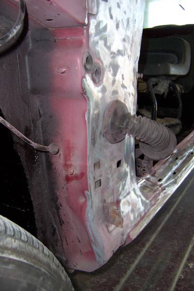

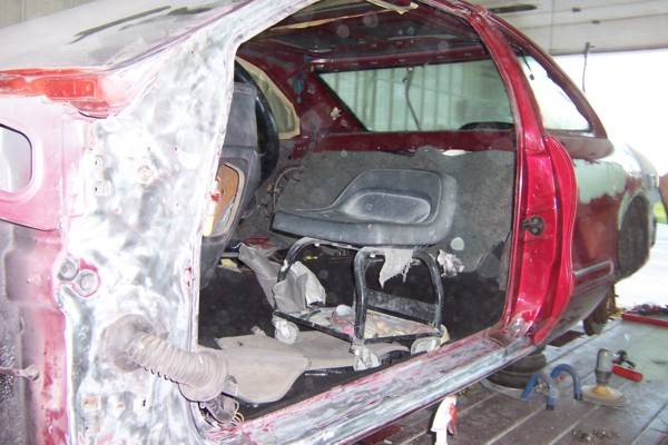

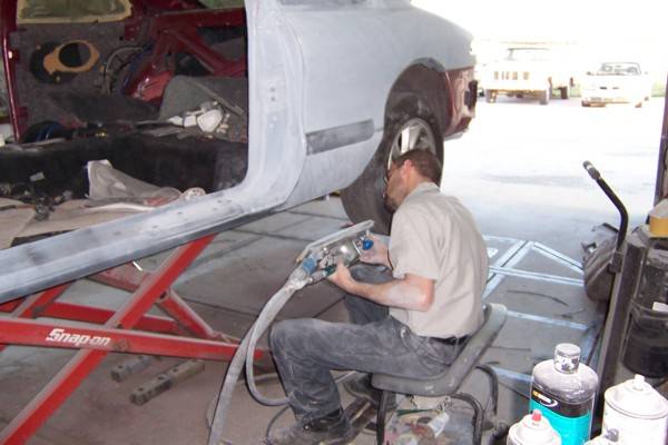

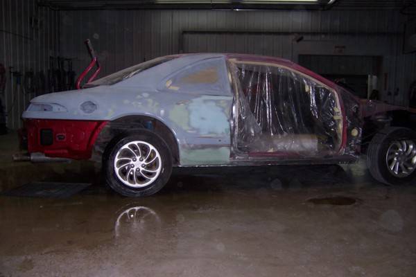

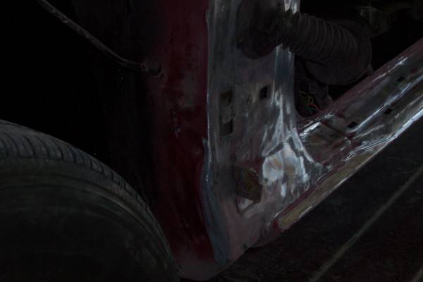

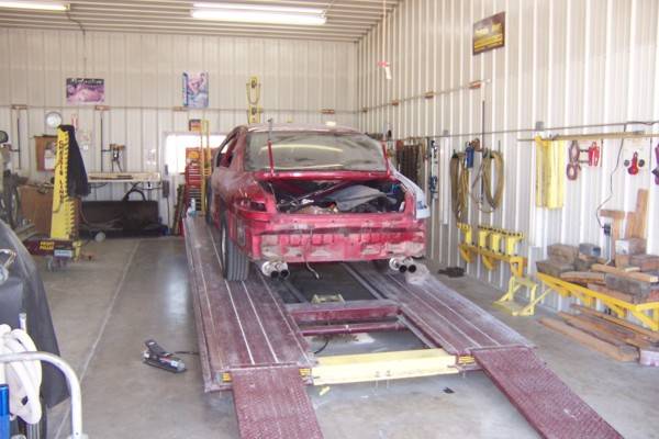

I Got the car up on the frame rack, and got the door pillar pulled back into specs. (the door was installed with washers shimming it out to fit the fender correctly).

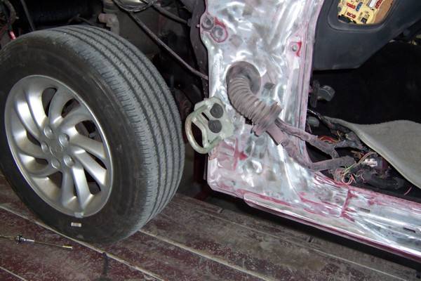

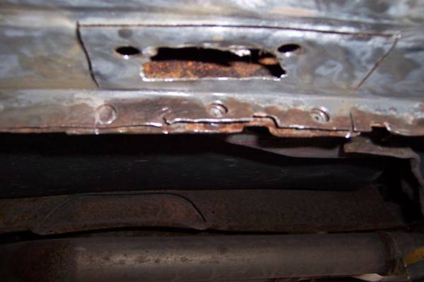

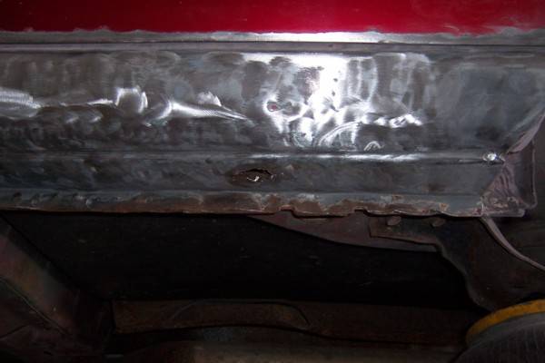

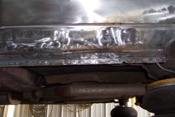

Both of the rocker panels were stripped, which is no easy task with all of the rock gaurd on there. While stripping it off, I uncovered a rust hole thats shown in the pictures. That was a little bit of a suprise to me, but it's no big deal, just a little more time to repair.

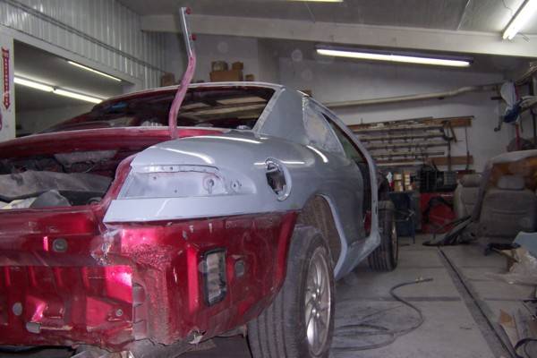

The car is ready to go in to the booth to get it's "final" coats of hi-build primer. I will have to strip the rear section of the 1/4 panels to mold the LMS 3 pc wing in correctly, but this will allow me to get everything else done in the mean time.

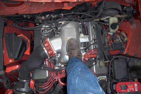

You're stepping on that poor Cobra's face!
Awesome. Keep up the good work. :D
Leg room is no problem.
Head room on the other hand..... :)

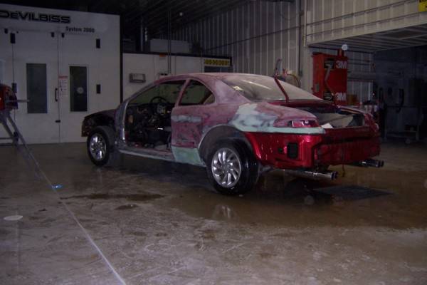

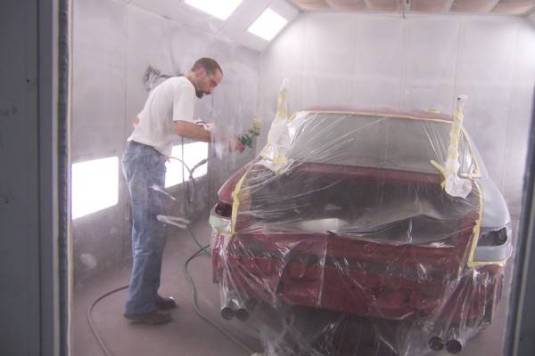

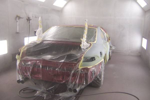

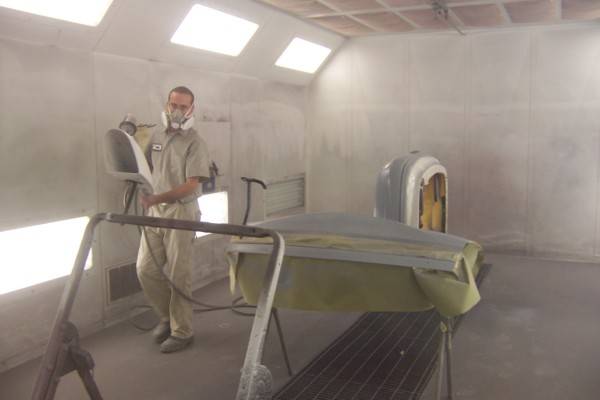

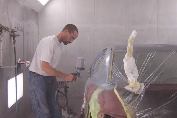

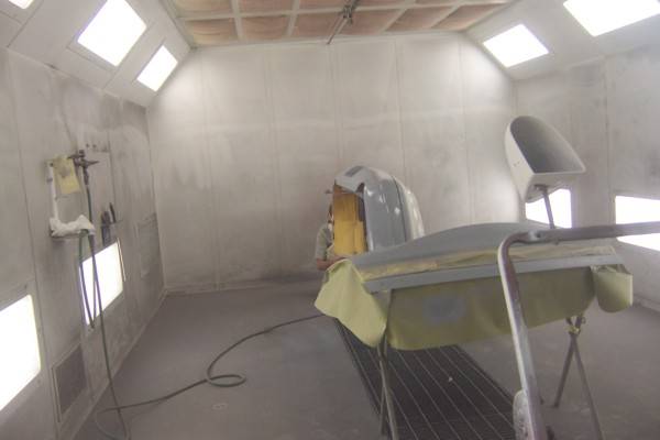

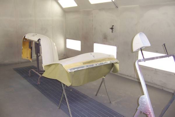

I pulled the car into the booth to spary the primer. Sorry the pics are'nt any better, but the windows are small on the doors.
Mike

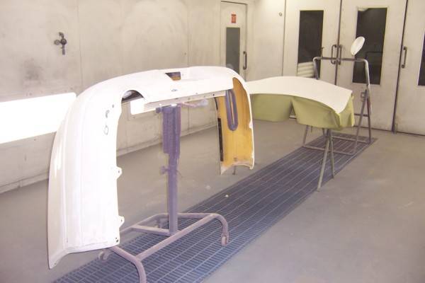

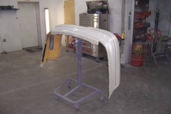

Update 04/29/06
Got quite a bit done today,

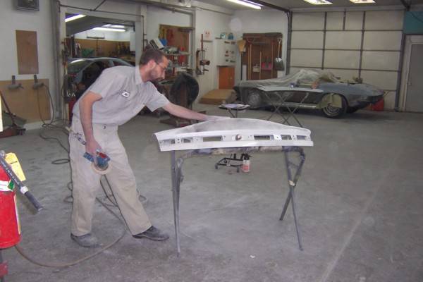

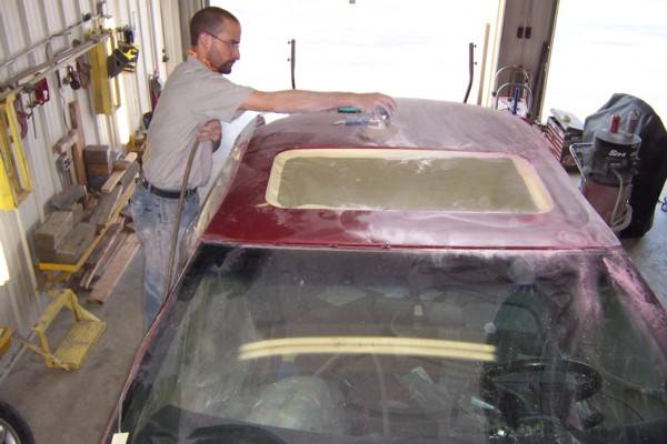

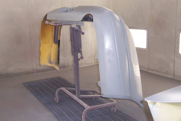

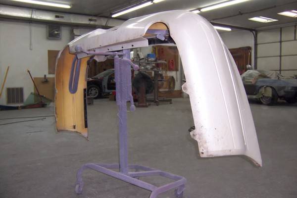

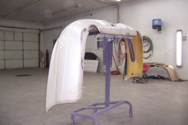

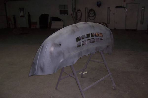

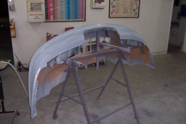

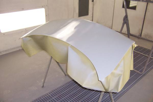

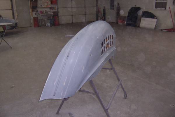

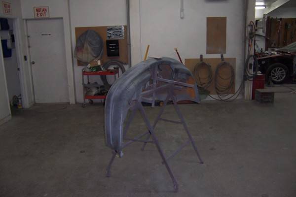

The "shell" of the car is ready for paint, along with....The front bumper cover, mirror housings, and I got the trunk and rear bumber cover in primer. Tomorrow I'll get that sanded Down and ready for paint. If all goes to plan, You guys will be seeing color by the end of the week.
Less than a month to go, so I'm gonna have to start pouring some work into it.
Mike

Mike, what color of primer are you using, it looks like you ar using two different colors.
Well, the reason you see different color is, Because of the guide coat.
After the actual primer is sprayed on, you take an areosol can of something that looks like flat black paint, and spray it over the fresh primer. The reason for this is.....
When you are blocking the primer to make it flat and smooth, the guide coat shows you where your low spots are, because you sand it off of the high spots of the primer leaving a black low spot. (It just helps you get the finish prefectly smooth.)
