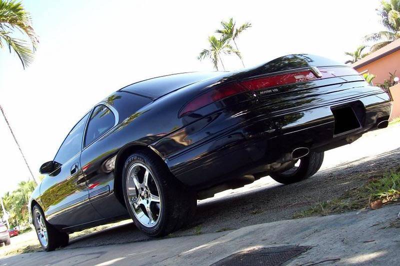

Here you go man...
That's the set up I have on my '93. I have a '97 LSC exhaust that had 2 FlowMasters on it. I swapped the Flow's out for Magna's but it even has the STOCK '97 tips too. Looks pretty good.

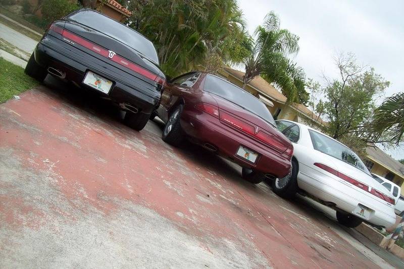

see i think if you were gonna do it on a gen 1 w/o the cutouts you should flip the tips over and swap right to left, so the flat part on the tip goes against the flat bumper
edit looks like ultimateSVT had a panther edition so he has the square cutouts anyway
+1... Flip 'em, they would look nicer. I got lazy & never did anything to the tips, just slapped the entire exhaust on the car & off I went but this gives you an idea!
Yes I have a Panther Edition so that helped out when it came to the exhaust fitting right in. You know, being that my Panther Edition comes with 200hp more & all you know....:D Those cut outs alone add on at least 20 hp each!

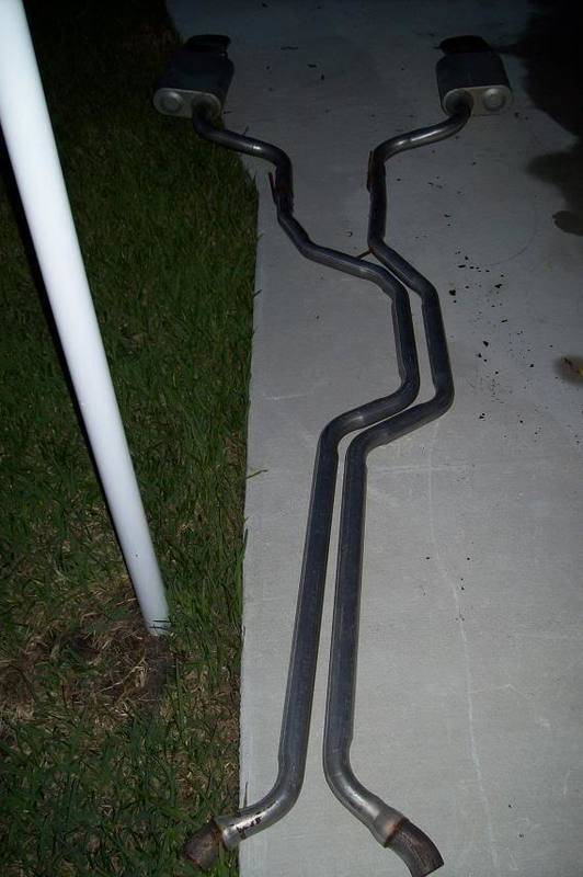

You can see my tips...and hear my exhaust here
YouTube - Sapperfires Exhaust
it's the exhaust from Lasers old 97 LSC, 3rd cat dropped for X pipe and FlowMaster D40 mock mufflers by Raven
yes the mufflers are hung on a hard brace from the normal mounting point, just used a slightly longer hanger bar..they sit about 1/4 inch under the flat bumper..I don't think it looks terrible...but one day before paint I'll be getting a gen1 bumper with the proper cut outs for the tips, im waiting on a Gen1 lsc to hit my salvage yard because I would also like to delete the Base molding all the way around..I've already got the moldings from the 98lsc in the yard :-)

Right...there is about a 2 inch long step down added between my mufflers and tips..nothing special, just a smaller pipe that fit sleeved inside the other
just tell your exhaust shop where you want it to be when it's all welded up, or better yet, have them drop your exhaust..then just hold the tips where you want them, they can make it fit right
