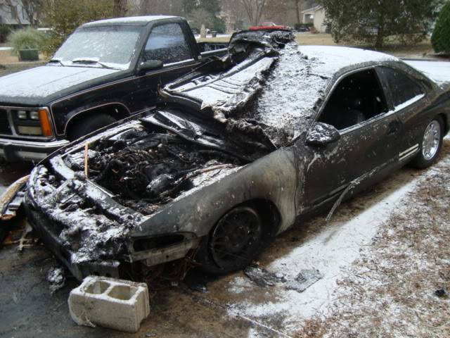

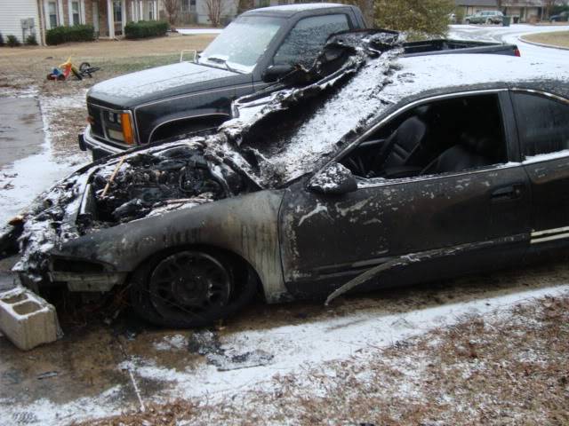

FWIW, don't cheap out on underhood fuel line repairs. This was a result of a leaking injector o-ring but its the same idea/location. This is NoLimit's old car...
That was a result of it not being put together correctly, but yeah, fuel leaks are a bad thing, regardless of location

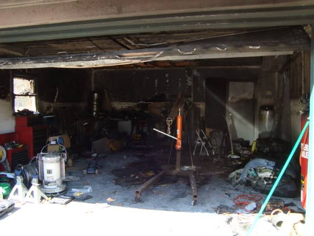

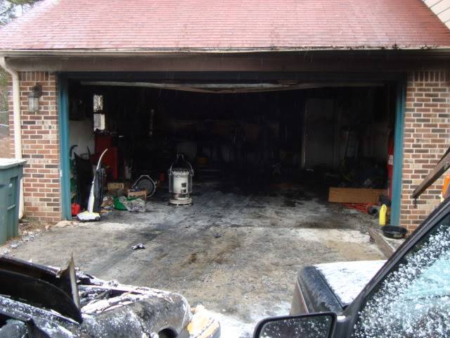

Please let me elaborate on the above pics. Not only was this just a simple fire that started under my hood, this was an explosion, under my hood, inside my garage and I was inside the car and at the same time, the garage door was on it's way down. This was by no means a nice experience. I saw death in a spit second. I got lucky. #1. My windows were up because it was January. #2. The firewall stopped injury to me, although a flame ball or something shot out of my air conditioner vent. The one to the left of the message center. That little flame shot right past the right side of my face and singed my right eyebrow. 10 houses away, this explosion was heard at 11:30 pm. I know this because they got out of bed and come walking down the street. A few told me they heard it. It blew the bottom of my back wall, which was nailed down to a concrete foundation, 8" off the foundation. All windows in the garage were blown out. Garage door windows were blown all the way across the street to the neighbors driveway. If anyone had been inside that garage or standing in a doorway, they would have either died instantly or ended up in a burn unit. I have two metal doors that lead out to the back yard and one goes into the laundry room and then into the kitchen from there. Both doors were twisted and wouldn't shut.
After the initial explosion, which was very loud seeing how I was right in the middle of it, I jumped out as fast as I could gather my thoughts and landed on a concrete floor that still had flames on it from gasoline. I then took a dive out of the garage and landed in the driveway full of glass and out of all that, I ended up with a gash on my leg that I didn't even know I had. I was asked by paramedics if I needed any medical assistance but I said no and the whole time, I really did need stitches in my leg. Blood was running down my leg and my sock was catching it. I never smelled this coming or knew it was coming. It just happened. I can only say, when it comes to fuel lines, rails, injectors, make sure to check for leaks, unlike me. If I had only checked first, I would still own the black on black 94 today. I drove that car 19,000 miles in 5 years and put a lot of money and TIME into it and I watched it burn to what you see above within 3 minutes. It was gone. Not only did I lose my car but I lost a lot of things I had in the garage. A lot of stuff my dad, (which passed away) had in the garage because liability insurance was all I had and believe this or not, my car insurance paid for the house to be fixed and I wasn't even driving it. :confused:
Just be safe when dealing with fuel and never assume that you know it all and never assume that you have something together correctly because you just may not. Luckily for me, Jamie came to the rescue for me and offered me the 95 I have now for $2,000 and I saw potential for it. Low miles but ugly interior. I have fixed all of that + much more.
Now I have renters insurance! I have enough to buy 20 Marks if anything like this happens again. I am now with a local State Farm agent and not some out of state cut rate insurance company. I had a gaping black hole on the end of my house for 6 to 8 months before it was finally fixed and it was because of an insurance company called Omni.
Anyway, I can't stress it enough and I'm glad Dan brought it up. Always check for leaks before starting the car and do not half ass your work when dealing with the fuel. I really can't remember if I left off an o-ring or an o-ring was still left in my intake and then I stuck the injectors in, only on the drivers side. I bolted the fuel rail back down nice and tight and I thought I was set. I shut the hood like a retard and didn't turn the key on and let the pump build pressure to check for leaks. So, now that I think about it, do the job right with the fuel line because it can be a 10 cent part or a 1.00 hose that could possibly end your life or the life of someone else.

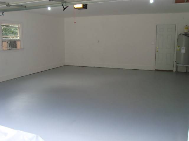

This was just absolutely beautiful to stare at daily for months and months, all because of stupidity over something as simple as an o-ring.
but, in the end, I ended up with this. Yes, I still have all my tools and toolboxes but lost a welder and some other high dollar big tools.
