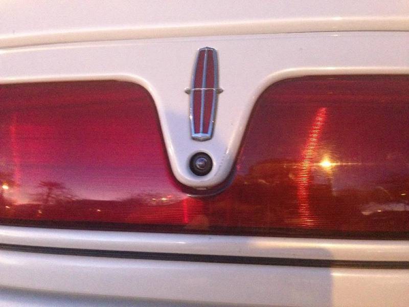

Received the new backup camera today - now, to get it installed! Wiring was run about 75% of the way on Sunday, need to tape the reverse light (power for camera and trigger to the receiver) and get the wiring into the trunk lid. Camera will replace the current trunk key lock. Camera is a bit smaller than expected (why can't any seller give GOOD measurements) but, I'm thinking using a piece of ABS to mount the camera will allow it to work out perfectly!

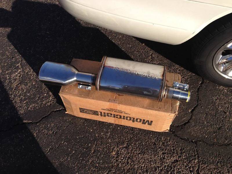

Rest of the parts for new mufflers was ordered - doing the Pypes EVT-29 tips, and the Pypes adjustable hangers - right now, its all going to be clamped in (band clamps) as I'd love to upgrade the rest of the exhaust some day.

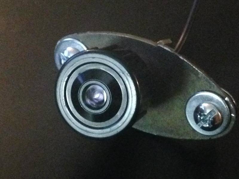

Trunk lock camera idea didn't go 100% as planned - didn't realize the angle and how far out the lock mechanism went. Drilled out the rivets, and then with some very careful work and I was able to actually pop out the mechanism from the inside of the lock (carefully removed the cover and then slid out the mech)
I think I'll be able to glue 3/4" PVC cap over the mechanism, then mount the camera into that. That should mount the camera almost against the neon assembly. Photos to follow at some point!
All-in-all not to bad, want to do a little more reshaping on the cover I made for the lock mechanism(if I thin down the outside a bit, it will fit a bit tighter) but, boy, it turned out looking CLEAN!
Best benefit - everything was cleanly disassembled (the lock cover was a pain to get the tabs holding it on bent out) I could remove it and return to stock easily. The actual metal portion of the lock wasn't touched or changed. The cap itself is a plumbing cap, and just needed a bit of sanding to fit VERY snugly over the factory lock assembly.

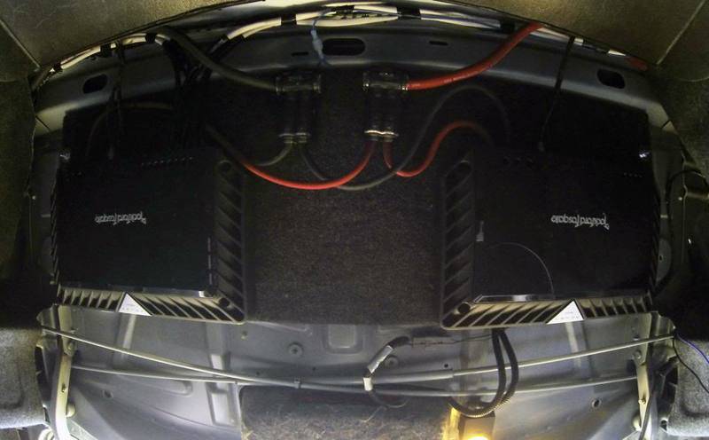

Finished up the stereo install today, not as much overall done - taking it easy. Finished by installing the drivers side speaker and tweeter, and tuning and adjusting everything properly. I can crank it way up with almost zero distortion (in other words - distortion occurs when its way to ungodly loud.) Wiring is completed - and the 0 gauge power wire is fully in the factory wire channels.
Ran into one little issue, so, a call to Rockford Fosgate is in order for Monday (confirmed something I thought I'd heard on the speakers some time back.) Worked around it for now, so that's good!
Started on part of the alarm install - was able to mount the DEI 535T window control module, and start getting some of the wires into that. It does require some cutting of some of the factory wires to the window motors (but, a benefit is it gives one touch up and down for both windows.)
The amps are mounted up very tight against the rear deck. Managed to use the GoPro to get a nice up shot to give an example to show the final fitment. I do have a Rockford 3.sixty processor I might still install, but, not 100% sure yet.
Another project is almost done!! I need to make some adjustments to the position of the right tip, but, all in all, not bad. For the perfect fitment, I need to have a shop make a bent piece of pipe, but, turned out quite well. I used the Pypes tips with the Magnaflow mufflers, but, made my own hangers based on stainless band clamps.

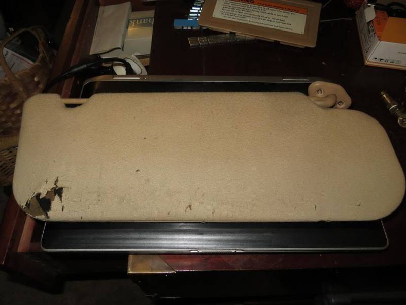

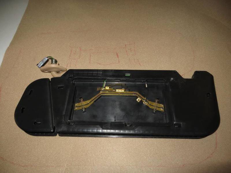

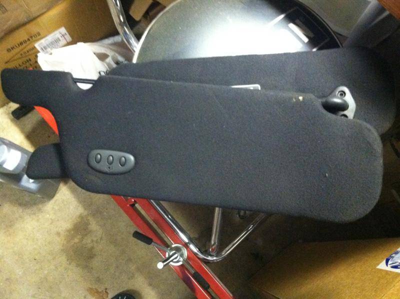

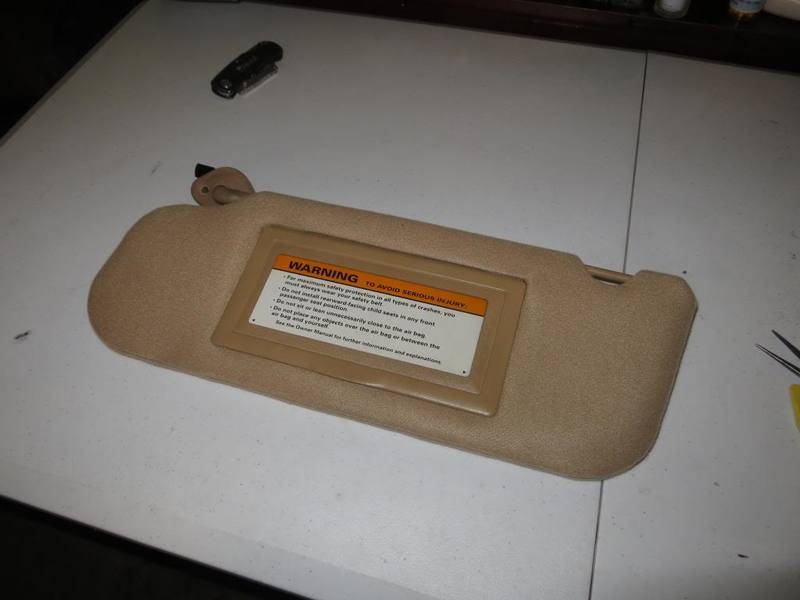

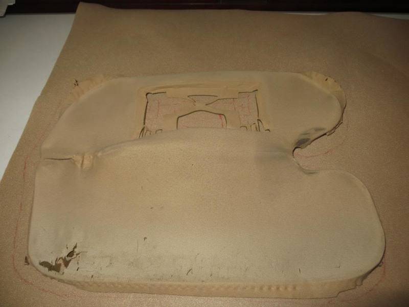

Had a bit of a cold - so - no major work done lately, but, took some time today and finished up recovering the sunvisors. They really are not that hard to do, just a little cutting, trimming and tucking! Quick steaming after done (helps remove any wrinkles) and voila!
Before:
Halfway done:
After:

If its anything like mine - should be a snap together plastic visor - there are teeth inside the edges that hold the material.
I use a set like this to tuck the material into the edges where it can grab the teeth. I also was able to slide the tool in and twist to pop the visor apart and remove the fabric in one piece.
http://www.harborfreight.com/5-piece-auto-trim-and-molding-tool-set-67021.html
I'd grab a junkyard one from a tBird, Crown Vic, etc (pretty much all that have lights) and practice on that. This was my fourth one, and the best one of all of them.
The replacement fabric is simply headliner material.
One more on the factory cover that was removed (first one I've got off in one piece)

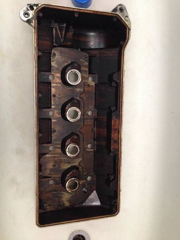

Not much - new valve covers, some spare parts from the local pick n pull. Managed to grab a CCRM, steering column with MFS, rear seat lights and door handle gaskets.

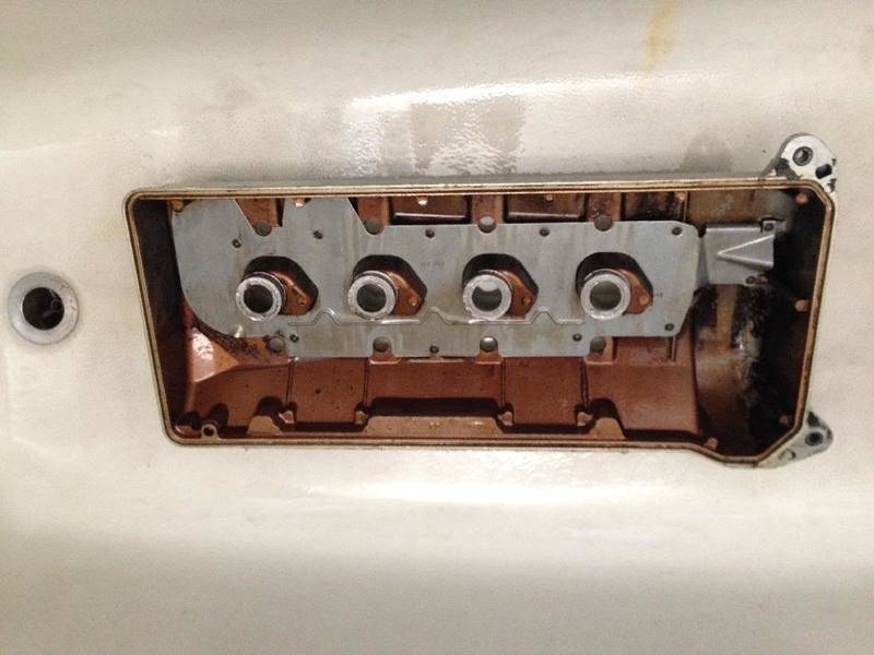

Bought some valve covers, and started cleaning them up.

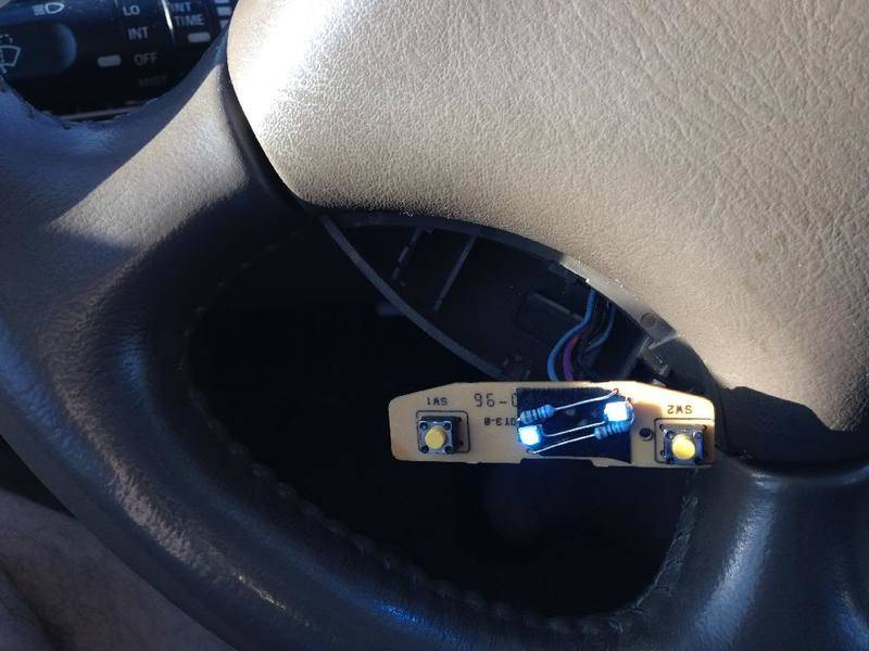

Also working in LED bulbs for the cruise control buttons - first try looks OK, but not in love yet. I'm wondering if full replacement circuit board for LED lamps might be nice (I'd have to have multiples made if folks were interested)
