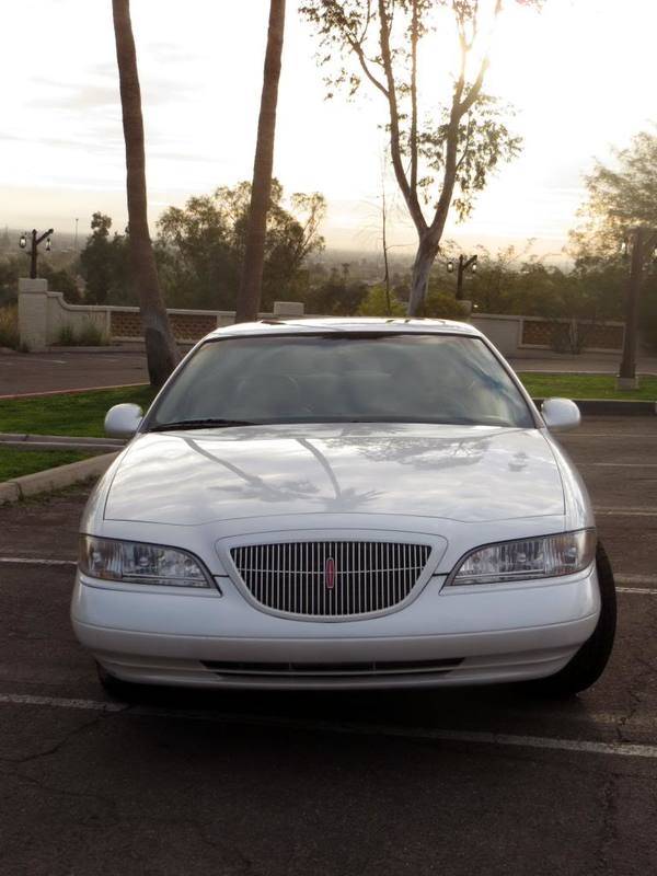

First off, a photo of the car itself. The car is a 1997 Mark VIII LSC (nice rust free Arizona car) that I purchased with 89k miles, and in overall pretty decent shape.
After having owned a 1995 Thunderbird since 1998, I finally decided it was time to get a new car, but, wanted to stay in the two door, and since I was able to find lower mileage Mark VIII's I decided that was the way to go.
The car itself does have few small dings on the body, and a bit of damage above the right rear tire area, but, is I all easily fixable, especially since a full paint job was already planned even before a car had been located.

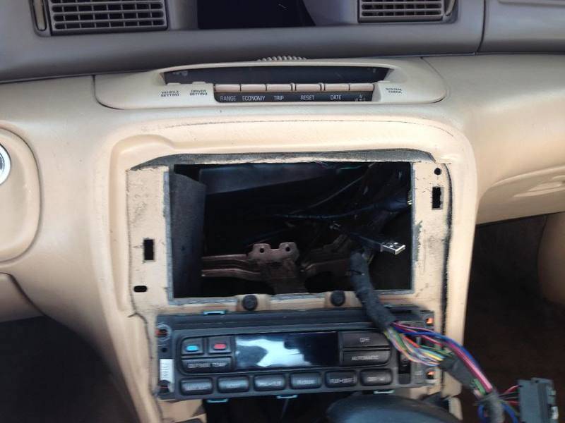

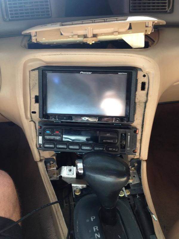

Even before the oil change, I had to get my stereo in. Late last year I had purchased for my Thunderbird a Pioneer AVH-x8500BHS, and knew this was one of the first things to change over. I made it 5 days before the stereo went in, and it wasn't to difficult to get in (and most of which was due to I had a nasty cold at the time)
I did the double DIN install with the Metra 95-5026 install kit, and the Scoshe FDK8B wiring kit. Trimming the mounting tabs off of the Metra kit, and a gentle trimming of the subdash was all it took to get the stereo in. I did use a file to smooth the top corner of the kit to round it nicely to fit the factory wood trim panel.
Stereo is currently driving the factory amp directly since the Scoshe amp bypass cable would not fit.

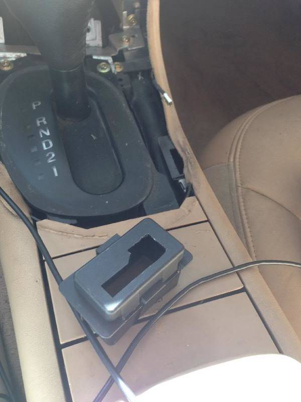

Since the stereo itself features "App Mode" I also needed to run a USB cable and HDMI cable to the center console. There is also a second USB cord that was run to the glove box for a second USB device, and also a microphone that was clipped above the rearview mirror on the headliner for hands free cell phone calling.
I trimmed the old factory cell phone cable connectors from the center console, and used that for my cable runs. Right now the cables run through the mount, but, in the future, I think I want to actually put mounted jacks into the panel for a very factory look.

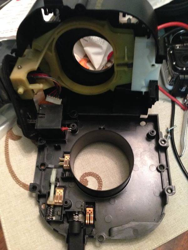

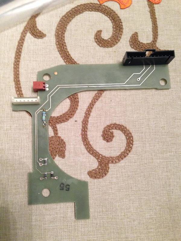

Second order of business was getting the right turn signal working. When the car was purchased, the right turn signal didn't work, and me being the enterprising (cheap) person I am, I decided to tear into the switch to see if I could fix it.
As it turns out, one of the resistors had failed, so I was able to replace and repair the switch myself!

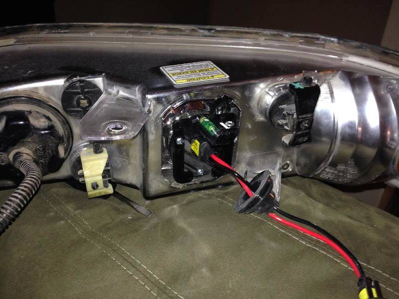

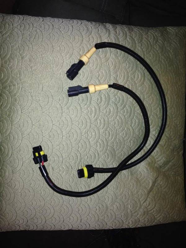

Third order of business: one of the HID headlights was flaking out, so, I knew new ones had to be installed. Went with the 5000k 9006 bulbs, and made my own delrin adapters on a lathe.
9006 bulb installed with my own adapters.
Adapters to interface the ballasts with the factory wiring. I mentioned it elsewhere, but, for anyone doing this hit up your local pick n pull and find cables for ABS sensors - they happen to be a perfect fit (but!!! pay attention to wire color, black isn't always grou

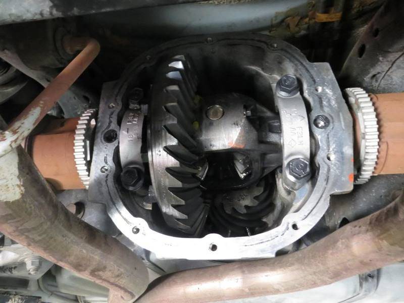

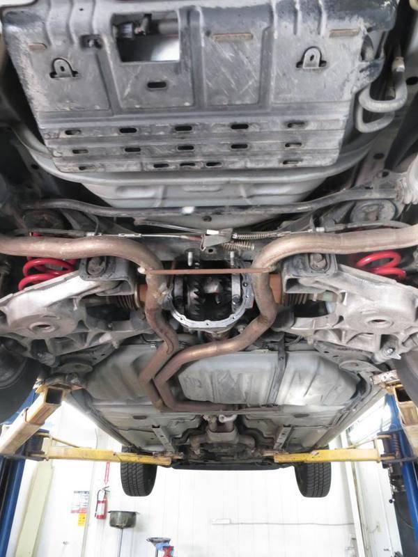

Today, was to replace the rear differential fluid, attempt to install a trailer hitch, and check the car for the presence of the air lines and compressor and test those components to see about returning it to air ride.
Differential was a surprise, I don't think the fluid was more than 10,000 to 15,000 miles old, and there was life left, but, we went ahead and replaced it with Mobile 1 synthetic. All the gears look good, and its in good shape/condition, and minimal metal shavings on the magnet.

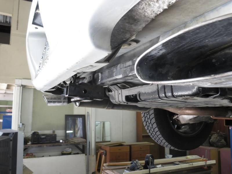

Hitch install didn't go as planned, as there were a couple of unplanned fitment issues. I need to redrill the mounting holes and offset it about 1/8" to get the fit exactly right, and since the back mounts mount in the same place as the exhaust hangers, I'll need to get some longer bolts to mount them properly together.
I have had a roof rack on my tbird for a few years (and it fits the Mark just fine) but decided to move to a hitch bike rack instead to make life a bit simpler.

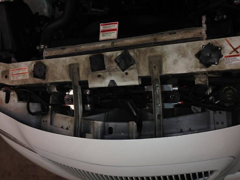

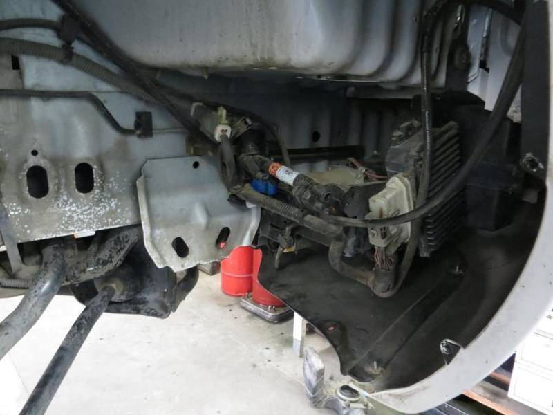

Another one of todays goals was to remove the air silencer, and since I was also wanting to check to make sure the air lines and compressor were still in place, this was a good time to do both, along with replacing the fuel filter.
Thankfully, once the fender was pulled, the compressor is present (prior owner said the front right air shock had failed) and the ride height sensors are still in place, and the connectors for the solenoids and the air lines are all nicely tucked by each wheel! Sadly, I forgot my EEC-IV tester, so, I wasn't able to initiate a self test on the compressor to see if it still works properly.
I am hoping to get the air ride reinstalled next Friday (hopefully I can figure out a way to test the compressor to make sure it pumps)
From what I can tell, it looks like the suspension wasn't replaced to long ago, so I'm hopeful that a reinstall of the air bags and a new air dryer is all I'll need. The wire for the check air-ride I actually cut myself.
