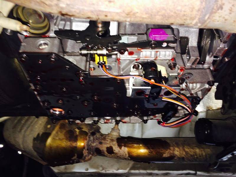

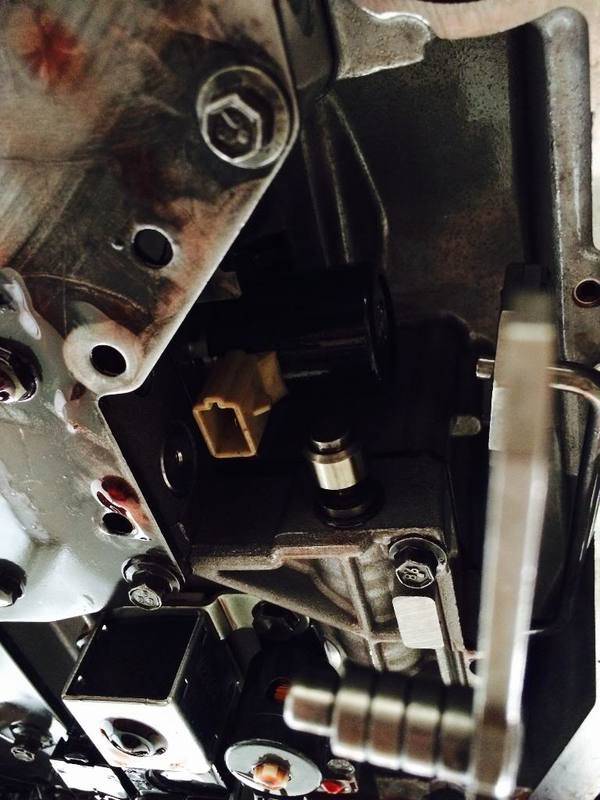

First - trying to dig into an occasional error on the EPC solenoid, and also gives the car fresh transmission fluid.
Its pretty clean in there!
New OEM Ford EPC solenoid (PO had replaced with aftermarket)
Sadly, that "helped" the issue, but, didn't eliminate it - so, time to start checking the wiring. Based on what was done prior (a wire splice) I'm going to replace the transmission internal harness and overharness - and hope that does it.

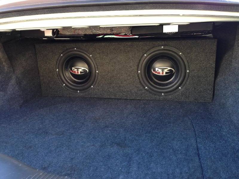

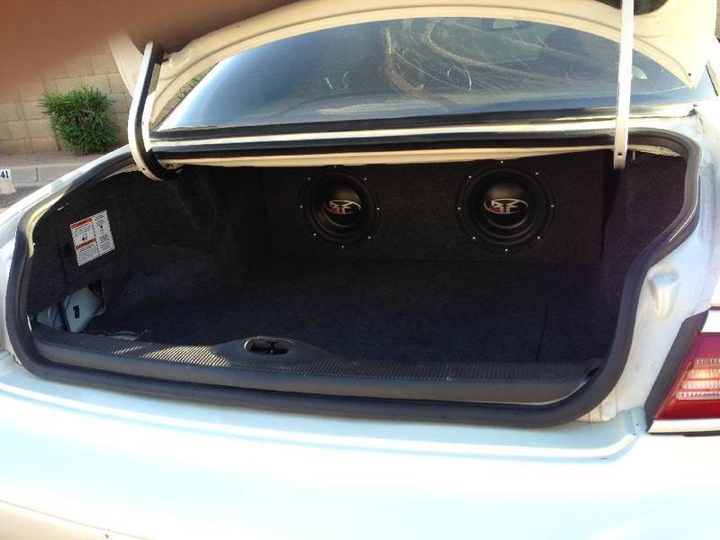

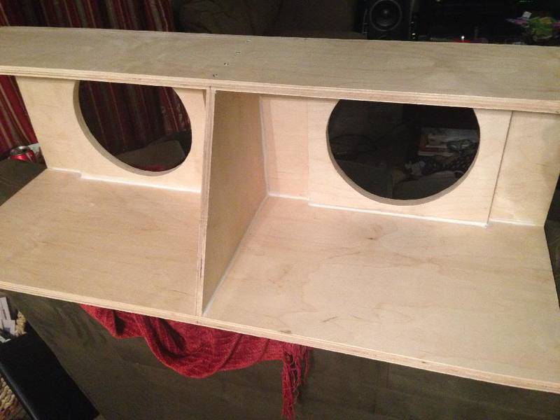

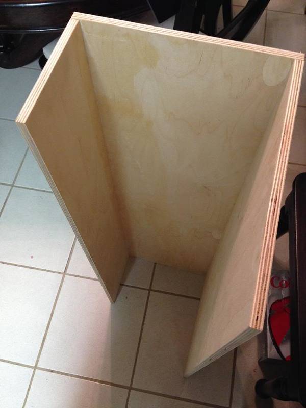

Second on the list, was getting the sub box built + installed. Box is made of Baltic Birch plywood, and is sealed with a 1cf internal space after deducting woofer)

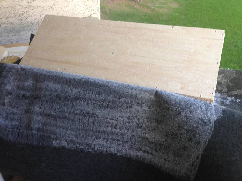

Covering the box with speaker box material.

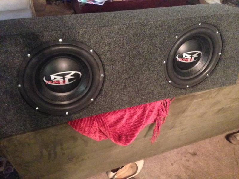

The finished box.

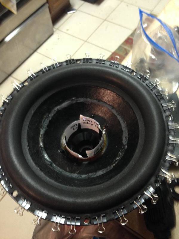

When installing the subs, I ended up smacking one on the ground, and knocked the magnet off. I had to re-epoxy and then remove then reinstall the cone to make sure it was centered. Here's the sub with the foam surround glue clamped to dry.
The box installed. The box ends where the spare tire cover starts to give an idea on size.
It fits like a GLOVE, and that was my goal - a box that met the requirements for my subs, and took up as little space as possible in the back. The slope of the box in the back matches the slope of the back seat. I want to get some foam and velcro to make a couple of small filler pieces for the small gaps on the right and left.
I plan on putting grills over the subs, just not sure which ones to get yet.

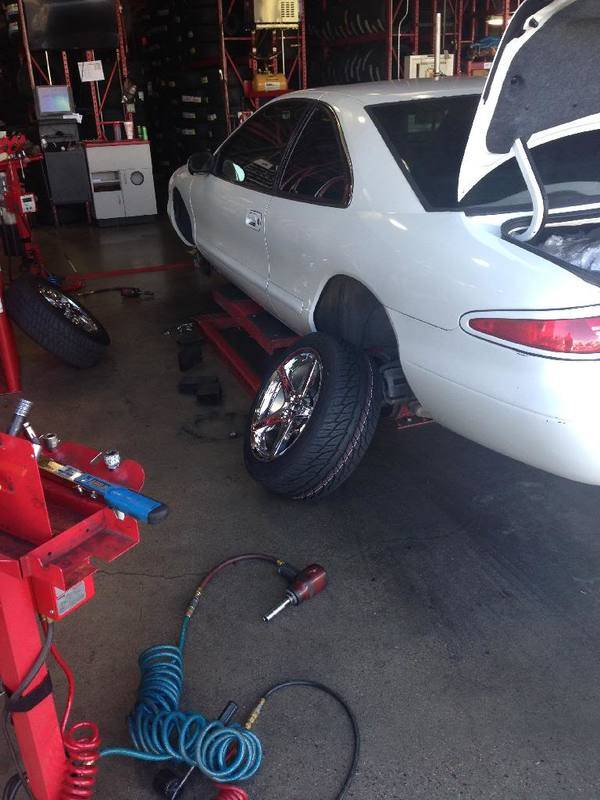

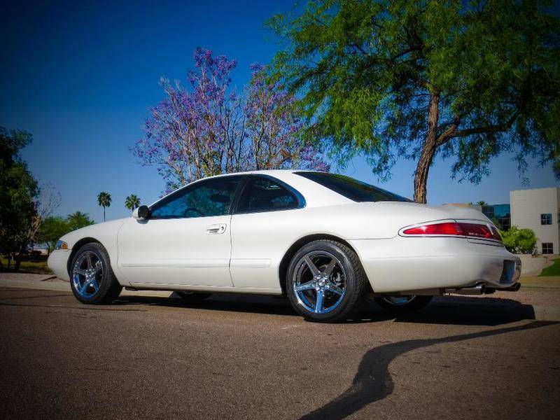

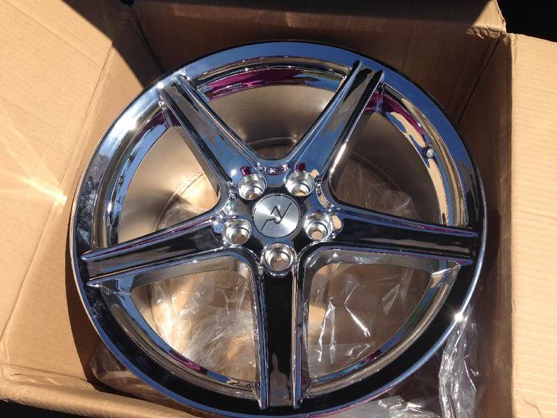

And last but not least - the best part - NEW WHEELS AND TIRES!!!!
18" Saleen Speedstars

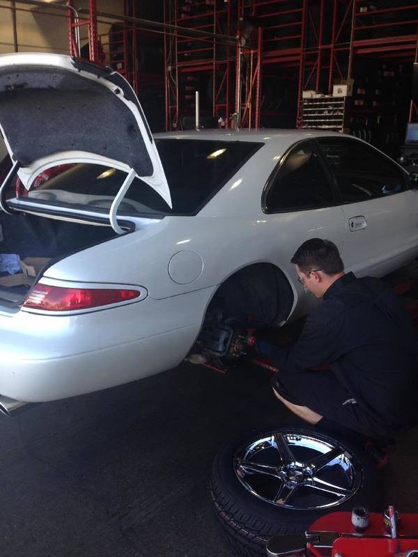

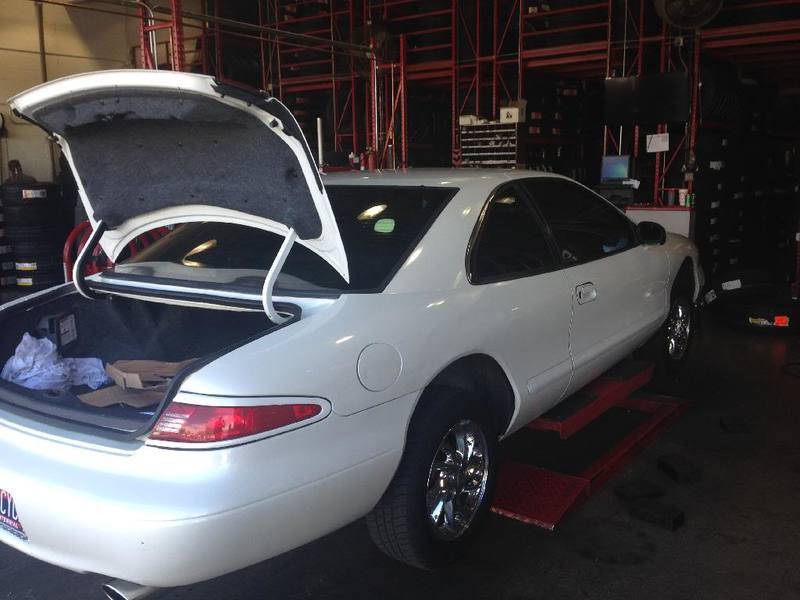

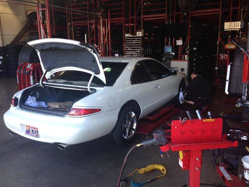

Removing the old

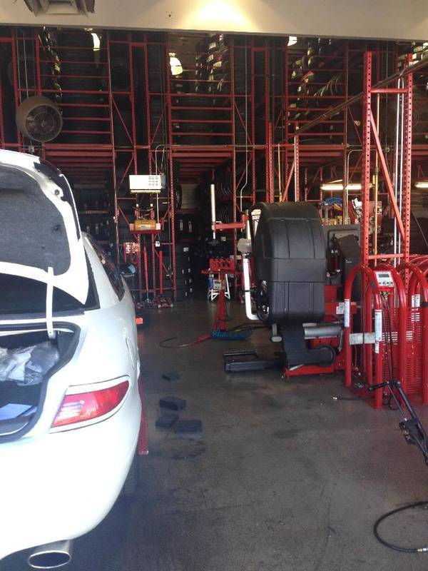

Balancing the new wheels and tires (using a roadforce balancer) - I will say at least to 110-115 the car is as smooth as glass for the ride.
Prepping for the new ones (they hand tightened them)
Cleaning the mounting face!
Wiping down and buffing the new wheels.

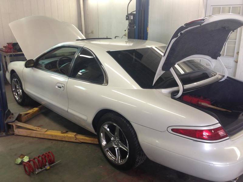

The final result.

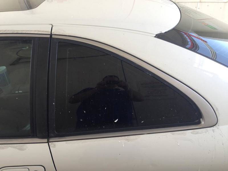

Rear quarter windows were also replaced with a junkyard pair - finally found some that didn't have significant sun damage - installed and re-tinted the new ones (not the greatest tint job, but, adequate until I have the entire car re-tinted)

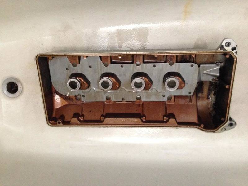

Also picked up a set of valve covers in from the yard - so I'll finally be able to paint and install the painted valve covers into the car!

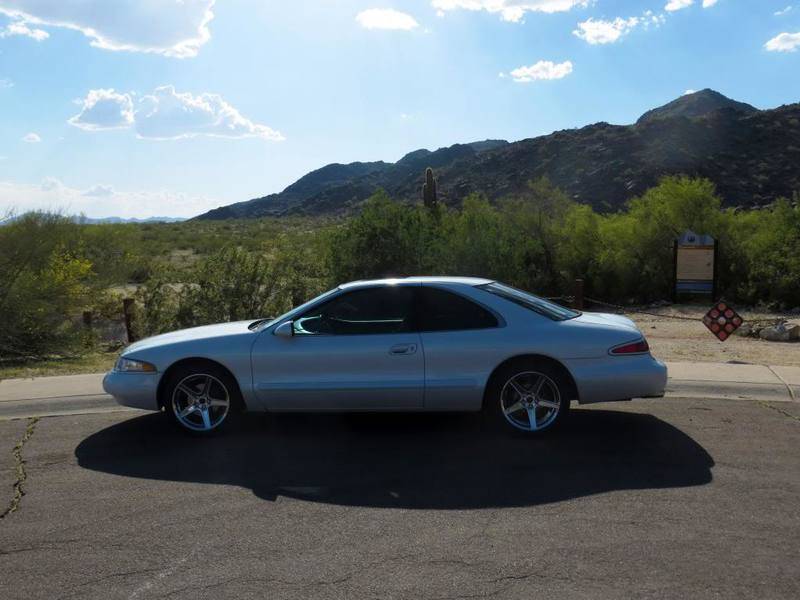

Car sitting on air ride.
Polishing the stainless steel on the car (just prior to a car wash, so I could clean off the residue there) Wetsand at 2500 grit then metal polish - removed all of the fine scratches in the metal.
A nice clean side shot of the car.

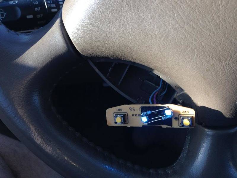

- both cruise control buttons are now LED. I used a slightly revised method on the right set of buttons that I preferred over how I did the left set of buttons.

- paint and install new valve covers. I have the valve covers, just need to prime + paint them.

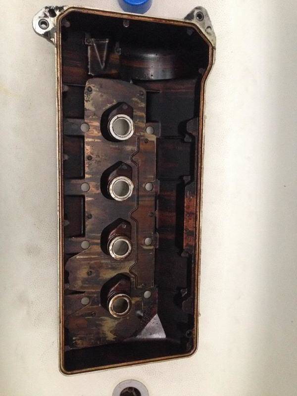

Bought some valve covers, and started cleaning them up.
Also working in LED bulbs for the cruise control buttons - first try looks OK, but not in love yet. I'm wondering if full replacement circuit board for LED lamps might be nice (I'd have to have multiples made if folks were interested)
Frank please reply where did you get the bulbs and did you solder the
On the original circuit board?
