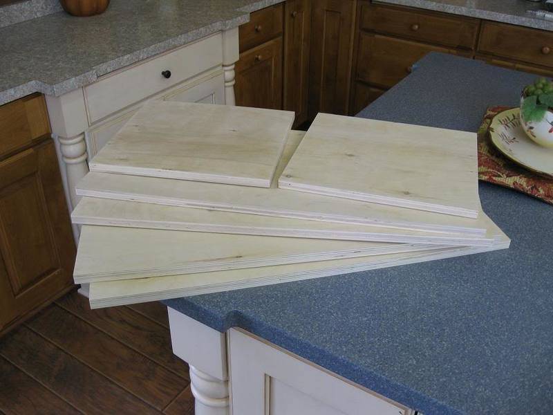

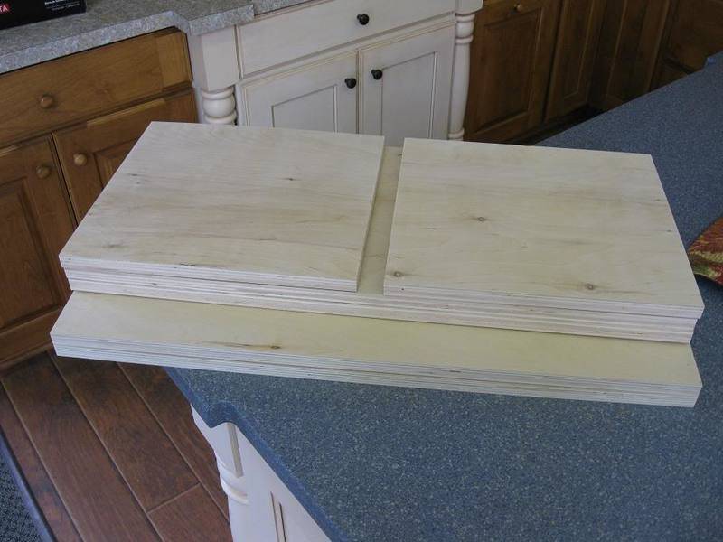

Materials just showed up. I love not having to cut these pieces except for the speaker and port holes :D

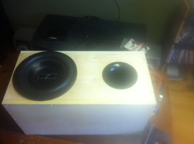

Started assembling last night. A note to those going to do a project like this... it's probably best not to drink before and during lol. I went a little heavy on the glue, and went through a good half roll of paper towels cleaning up the overflow :lol:

Crappy cell phone camera pic. It's actuall not a crappy camera. The lens cover is all scratched up. New back glass on the way right now.
