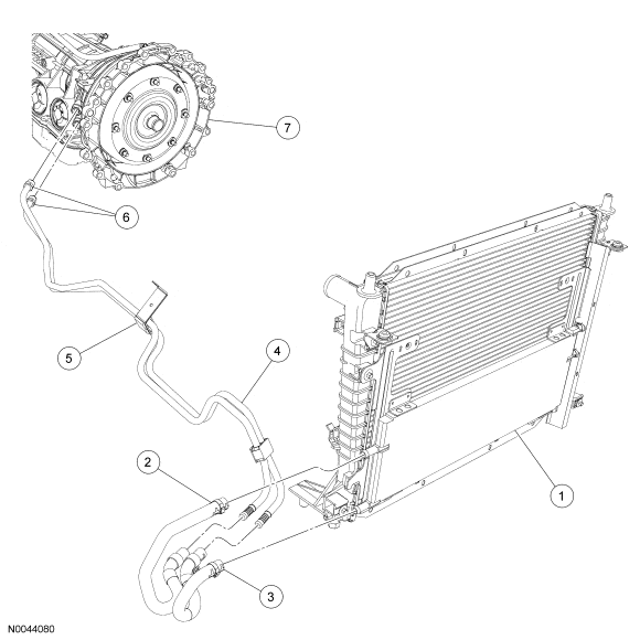

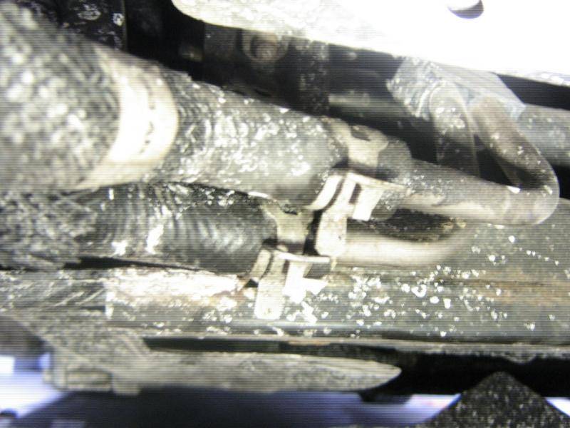

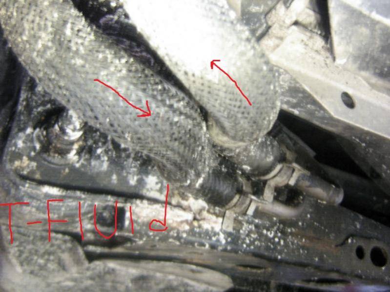

Where #2 attaches to the radiator is difficult to access, so I unplugged mine at the metal line (just below where #2 is pointing).
... my hose clamps were worm gear type.
