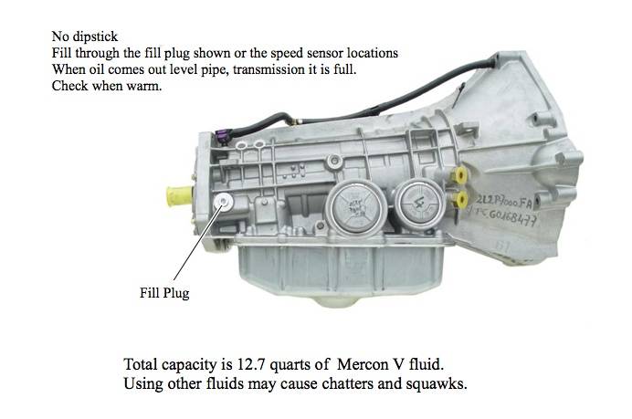

There is a fill plug on the back of the transmission, too.
Ford got rid of that one because people (including dealer techs) were filling the transmission 'til the fluid reached the hole, which put it about a gallon over capacity. I don't know when it was eliminated, but I know that my '06 doesn't have it.
That must be one of the 2006-only updates, as it is there on my 2005. Good information; thanks SoonerLS!

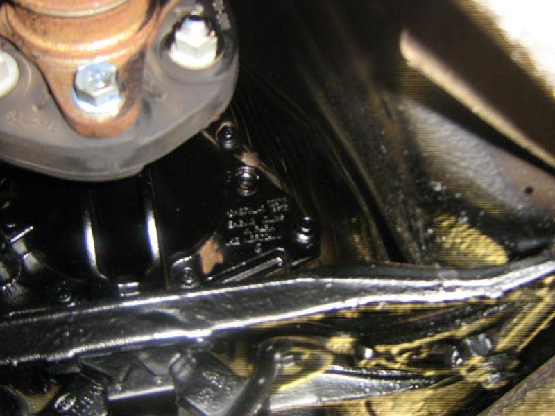

picture of the fill plug
