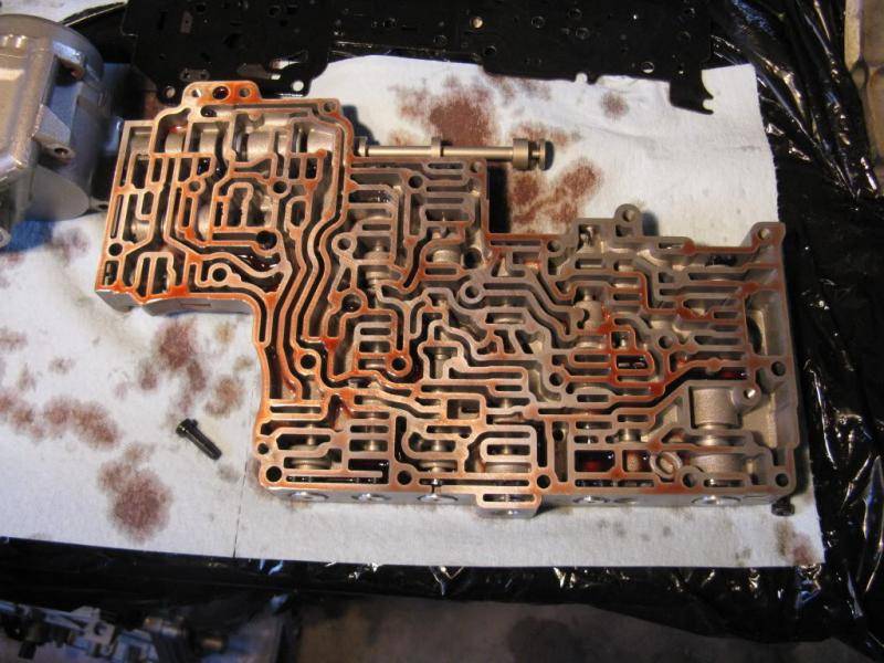

most likely the valve body or PCM...anyone know how much these parts will cost? and where can i buy?
does the valve body on this car have electronics on top of it that can fail? or is it only a metal block?
2004 LS does not have the failing spring in the valve body does it??
if there is no failing spring or electronics then i don't see how this metal block can fail...this narrows down the problem to the PCM
