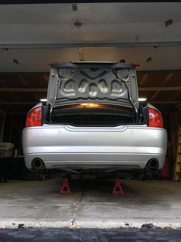

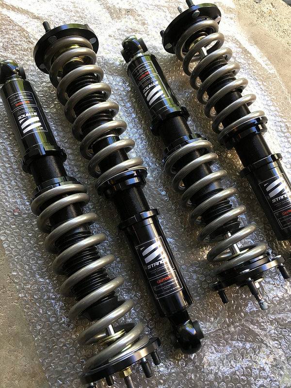

HI all - Ended up ordering a set of Stance's DEW98 Coilovers last week, and got them installed this week. Install process was not too bad (thanks to my friends for helping me out with this!). And overall the I am very satisfied with the coils and the car.
With the weight reduction on my LS, guessing where to set them at first was a challenge, and the car was very very low at first, after spinning them up the car is sitting nicely. In short - the product quality is great, I have worked with several coilovers from other vendors for various makes. From the packaging, to the product - these were a great buy. The ride is fantastic and I have fallen in love with the LS driving experience even more! Going to see if they settle at all for the next few days, and then I will get an alignment.
Dampers set at level 7 right now (on the stiff side middle), and my fend-to-ground (FTG) is set to 25.75" up front and 26.5" in the rear. Even without an alignment the car feels sharp, quick, taught, and agile.
During install -

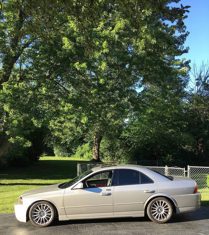

Cell phone post-install shots!
Fun fact - the Stance set weighs 18lbs LESS than the stock setup, and are smaller in overall O.D. allowing for a reduction in weight and more aggressive wheel fitments.
Looking to have a better photoshoot soon.

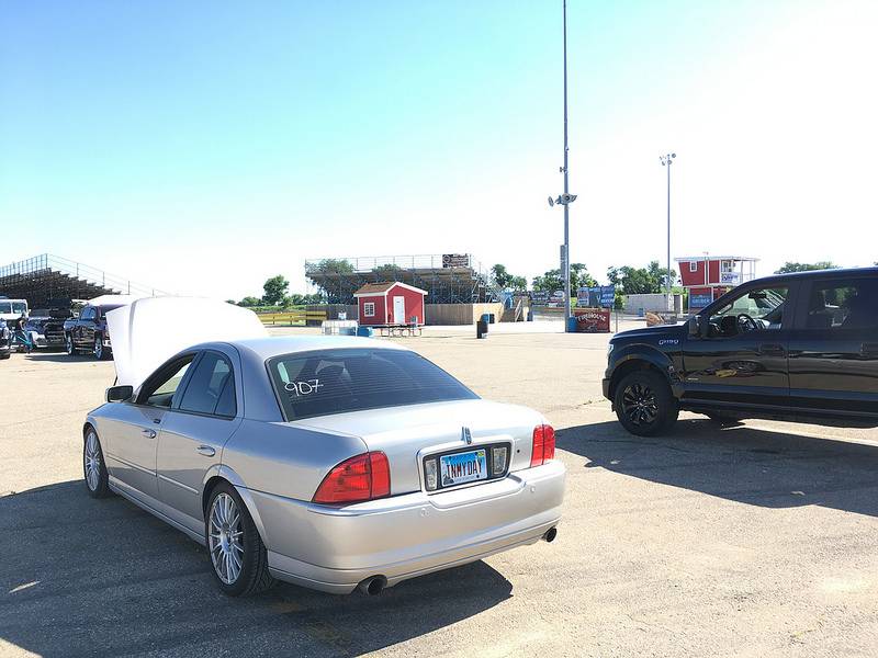

Visited the track today, previous best was 14.3 @ 97mph, 2.2 60ft. (Intake, Torrie Tune, muffler delete, 1/4 tank of fuel)
Today make my new best, and I cracked 13 seconds!!
13.95 @ 99mph, 2.1 60ft. (Intake, X-Pipe & Resonators, Dyno Tune, OZ's, weight reduction ~ 300lbs or so, 1/3 tank of fuel)
Most of my increase was probably due to the weight loss, I wish I could have tested each change I made to the car (mostly the tune), but I am thrilled to have hit 13's before getting my diff build on the car. This gives me a new baseline and some good data to work with. The car is definitely getting faster and a lot more aggressive. A high 13 sec car is nothing ground breaking, but comparing it now to how it was stock is really a pretty crazy change in character.
Couple notes:
1 - My dyno tune did not retain Torrie's trans settings. As a result my shifts are not firm/optimized. The motor is smooth and strong, and it really gets off the line much better on this tune though. But I miss chirping second and slamming 3 & 4. I maxed out the user accessible shift firmness on the SCT X4, still kind of a weak shift.
2 - 14.3 was a cool fall night, today it was 85* and I was in staging lanes constantly. I think the car has a bit more in her honestly, it felt a little sluggish compared to the night before.
3 - Experienced a strange flat spot in each pass today. Shortly after getting into 4th gear the motor hesitates right around 96-97mph. Go figure, right before I trap! Not sure if its a trans thing, tune thing, or a problem. No Cel's or other symptoms.

Can you link me to those Coilovers please? And was it a direct fit?
Thanks
Thank you 112 - here is the manufacture website: Home - STANCE SUSPENSION
I cannot find another pair for sale on ebay right now, but they drop shipped from Stance directly, So contact Stance if you are interested in a set for yourself.
Yes, it was a bolt in affair. It was a very easy install, I spent more time dialing in the height post-install than I did removing/installing the parts.

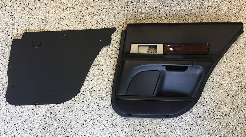

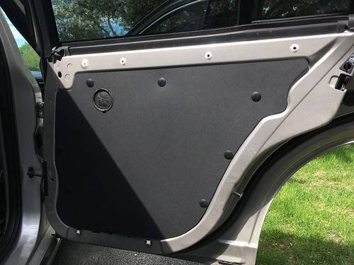

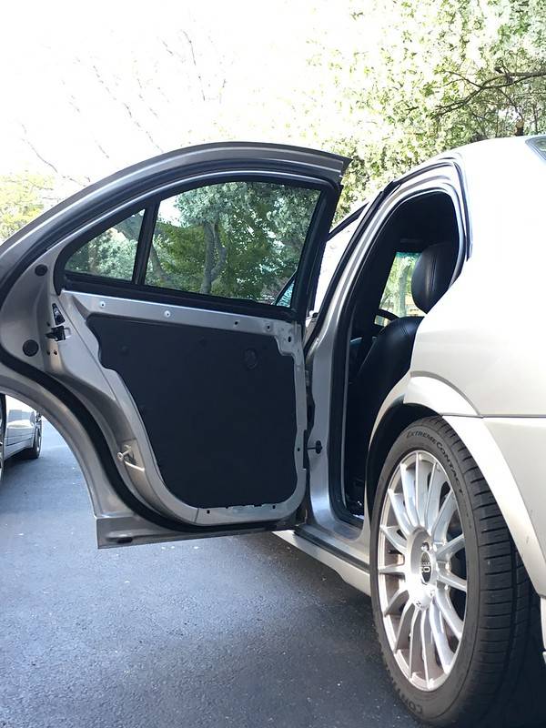

Continuing my quest to make the car lighter and more racecar esque, I did a small weekend project. Custom rear door panels, and rear regulator/wiring deletes. Cost was pretty low, about $50 using some 1/8" thick ABS panels, panel fasteners, aluminum angle brackets, and misc hardware. This is my first time working with this plastic and making a door card, but I am very happy with the result. I may make them out of a different material down the road. Let me know what you think!

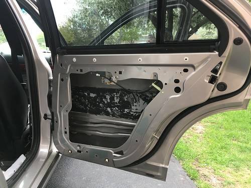

Removed stock stuff (also took this opportunity to removed the sound deadening panels from the interior surface of each rear door)

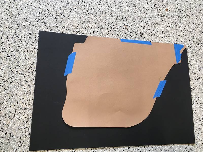

Made a template out of posterboard after determining the shape I wanted, and transferred it to the plastic sheet.
Repeat for other side, mirrored, just trace same template on next sheet. Here you can see the driver door still has the sound panel on it.
Drill holes to align with stock panel clips, and I drilled a 2.5" hole to place a window grommet for accessing the door cable.

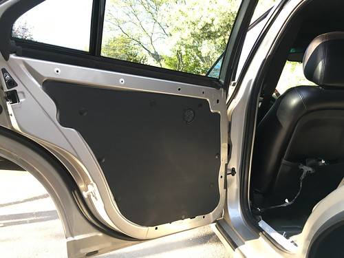

Installed and fastened.
Rears were simple, I want to do something similar for the fronts, but if I want to keep front power windows, that will be a challenge. Also, the DDM is bulky and complex to delete/relocate. I wish there was a less sophisticated version of the LS I could mimic or swap parts from (as in one with no power mirrors, windows, etc.) I will have to get creative. Good news is I dont need the creature comforts, rear window controls, mirror controls, etc. Will have to brainstorm.
Car is getting lighter on its feet and feels great. Hopefully getting back to the track soon to have some fun.
