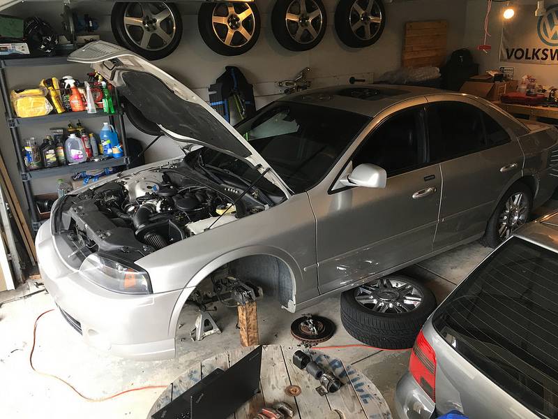

And I have been working on my suspension overhaul -
Car will be receiving:
1 - All new bushings for all 8 control arms
2 - MOOG Front LCA camber kit/cam bolts
3 - Inner and outer Tie Rods (MOOG)
4 - Front and Rear Sway bar bushings (ES and Powerflex, respectively)
5 - Rear Sway Bar links (MOOG)
5 - Front wheel bearings
6 - Front lower Ball joints
** Regarding #1 above, I have confirmed fitment for Powerflex Bushings (Jaguar) on the LS, for everything less sway bar bushings. Full write-up to follow in a few days. Working on editing my write up. But know that the LS now has another option for suspension bushings, instead of Deutsche/RacingGreen/NewOEM arms**

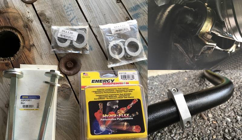

To update my personal timeline, I have installed Powerflex bushings into all 8 control arms on the car. Full write up is here:
http://www.lincolnvscadillac.com/fo...n-LS-Control-Arms&p=2037406085#post2037406085

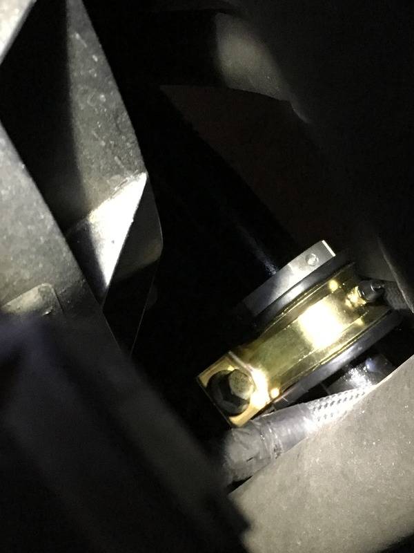

In addition to this, I have also performed the Energy Suspension FSB swap. (thanks Deacon!)
Used 28-30mm locking collars from DSTsuspension.com, worked out perfectly. They are anodized aluminum, so should do a fairly good job of avoiding corrosion.

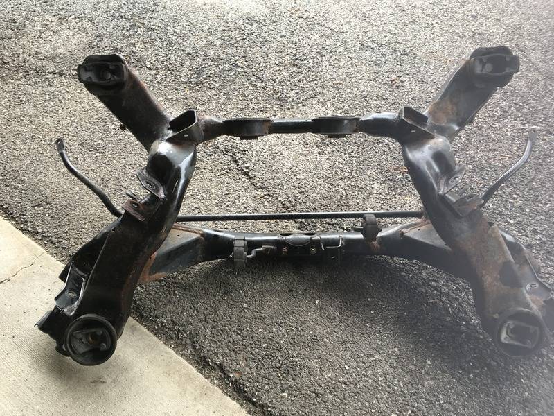

This weekend, while rocking the 2.3ecoboost MKC loaner I managed to find a spare rear cradle from a certain gen2 that once roamed these chicago streets.... A part of his LS will now live on in mine. :) Thanks to a fellow LVC/r we got this thing out on saturday morning, breaking one bolt only. This is a winter project, but let the 8.8" swap plans begin. If anyone has any ideas/resources for custom diff/subframe mounts, please let me know. The diff bushings have some slight cracks, and I am wondering if these are used on other chassis. They look very similar to my friend's MK4 R32 diff mounts. (which upgrades do exist for)
Also, has anyone found weak points of these? I am debating doing some reinforcing when I get the new diff tabs welded on. Since I have a spare to work on, I have time on my side.

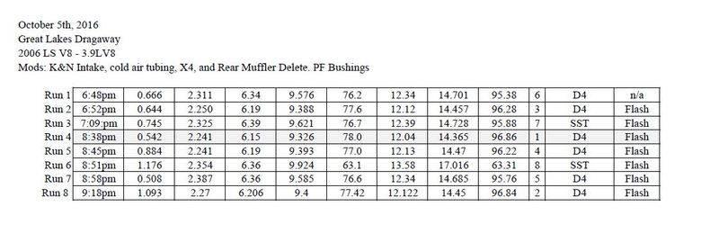

Going back to the track tonight. Mods since last visit are my cold air inlet tube, X4, and bushing swap. Hopefully some better times ahead.
Posted this in the 1/4mi ET database, but will update my thread as well. Pretty happy with where the car ended up after the X4.
Approx. - 65 degrees
1/2 tank
[video=youtube_share;HRUbPO3_y9A]https://youtu.be/HRUbPO3_y9A[/video]
Over winter I would like to get the LSD w/ gears sorted out, and maybe build a more proper exhaust setup.
