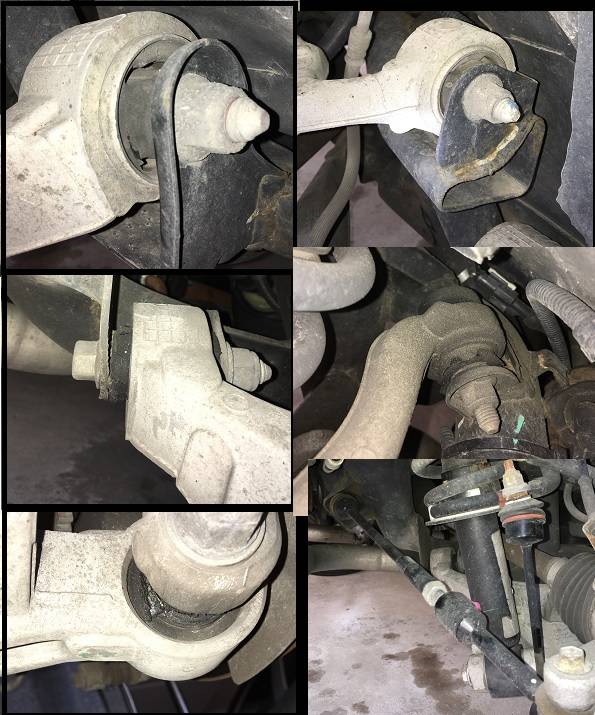

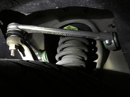

    Car was at the dealer since last Friday until today. Oil change, p/s window regulator, both front UCA's, and rear pinion seal replaced. I also had my door code retrieved from the ecu since the PO did not have it.
    Noticed the d/s UCA has a motorcraft label, and the p/s was marked jaguar. My suspension clunk noise has disappeared! It was making a very subtle yet persistent clunk during acceleration and braking. But not when turning. The UCA's had torn boots and play. Car feels much better overall.

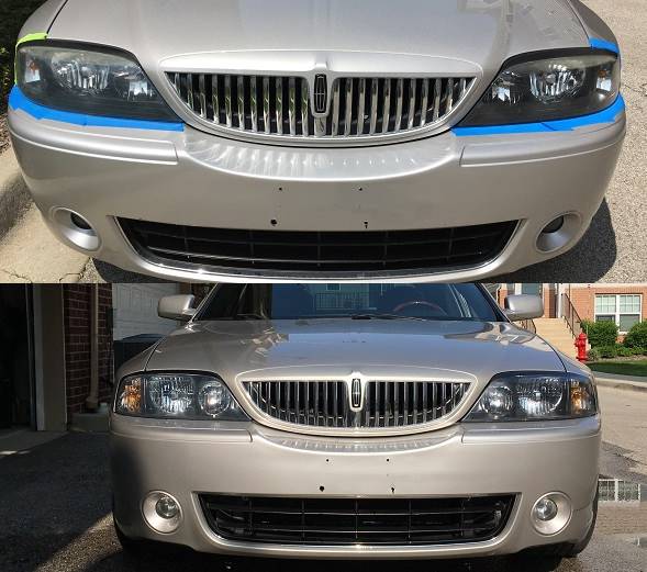

      Quick after pic of the headlights after the restoration. Before and afters will be up shortly.

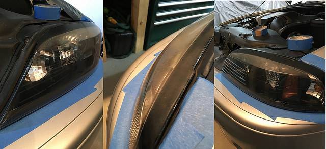

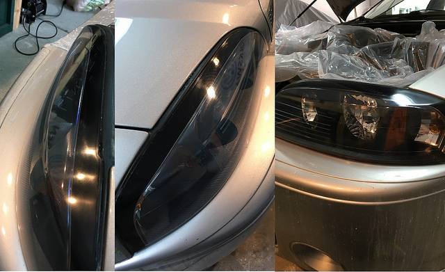

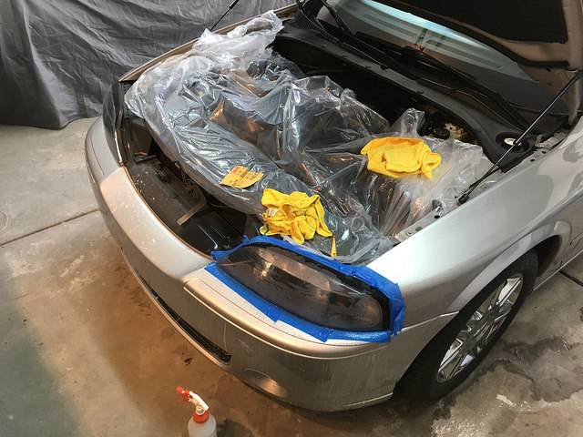

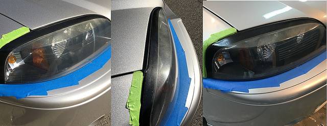

      More LS pics for you all. Some before and afters of the headlights. For the $30 kit and a majority of a Saturday, this turned out well. There is a slight haze/hue to the lights now, but overall - they are much better than before. Years of the Florida sun took a toll on them I suppose. The top sections were in the worst shape. Tried to get as many angles as possible.
      Before:
      During:
      After:
      Comparison:

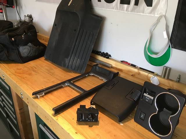

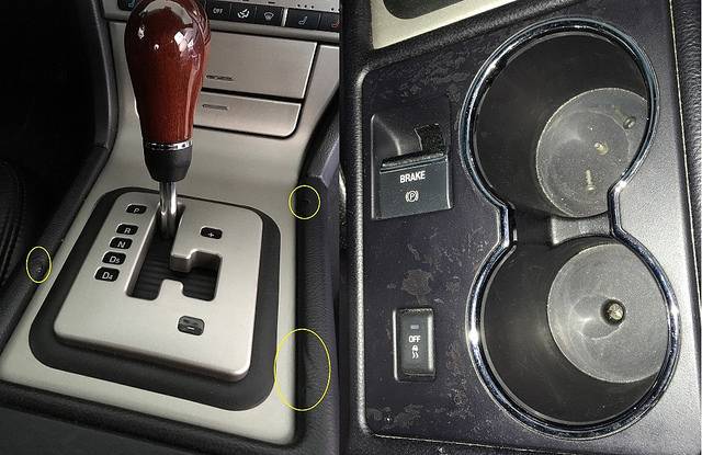

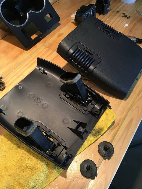

      Next - I found a guy on CL parting an LS. His ad said it was an 02, so I went over to his place prepared to grab axles and a spare diff for my upcomming diff project. Turns out the car is actually a Silver Birch 2006! I decided to pass on the running gear, but instead, got a few things I have been looking for all for only $100!
      Spare engine cover to hack up for the Jag project, spare headlight switch, console rear HVAC panel (my airflow knobs broke off), cupholder with switches, and console trim. I had knicked mine up a bit when removing the stick on trim.
      Console before:
      After (MUCH BETTER!)
      Overall I am happy I went to check out the LS, and it being silver, I may be back there - who knows.

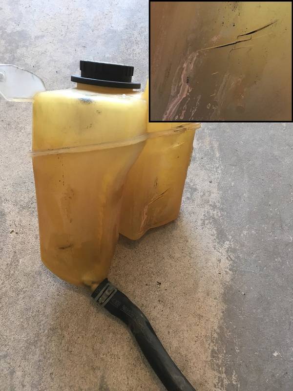

        Small update - Rear LCA bushings are getting noisy. I am working on sourcing replacement bushings as opposed to racinggreen/deutscheparts, and the all expensive pre-pressed arm from Jag/Ford. INteresting to note - my enghbor has a 5.0 Jag XF, and the toe links and rear LCAS look to be identical to the LS. I made this 3x3 picture to show the current state of my rear right suspension. Rear Left looks the same, and the front is still in good shape. Will probably overhaul the rear, then the front.
        Also, this weekend before friday night dinner, noticed some coolant under the driver's side fender. Upon further review - looks like the degas finally gave out.
        Ford dealer wanted $265 for the tank
        Lincoln dealer wanted $335 for the tank
        Got a $13 cap from Ford, and ordered a new tank from an LVC member. Thanks again LVC!

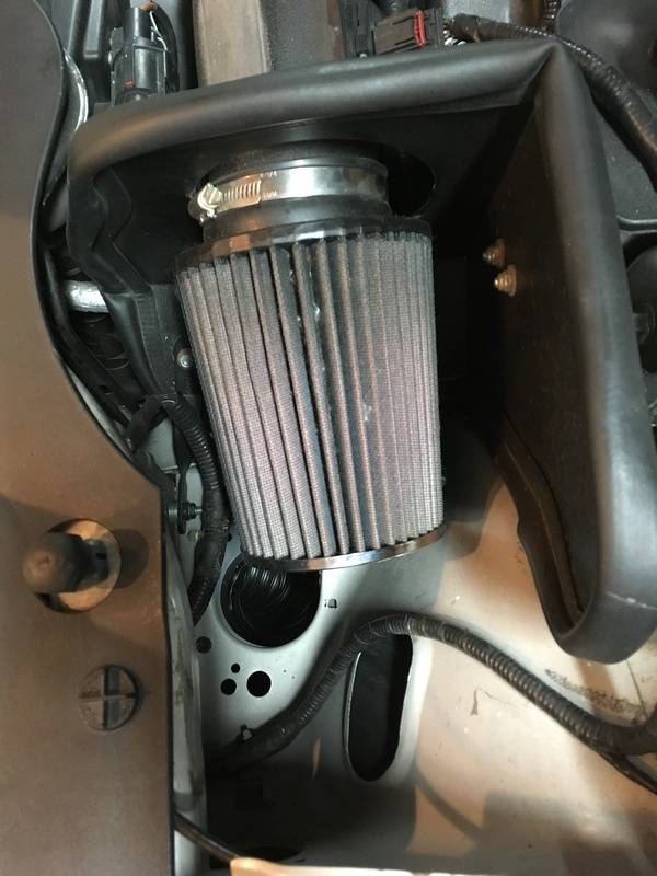

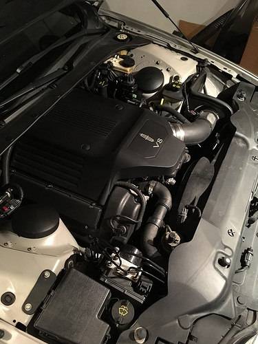

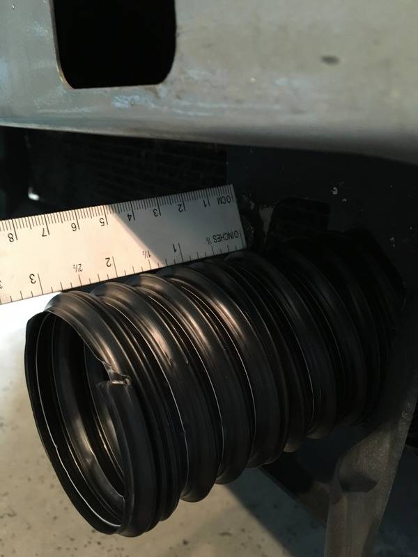

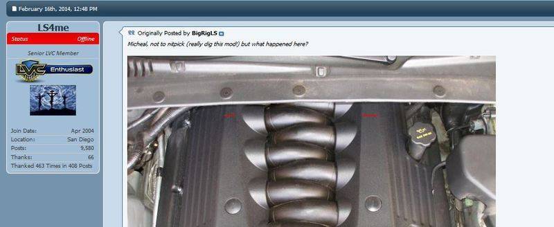

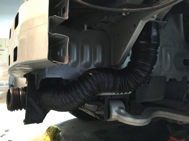

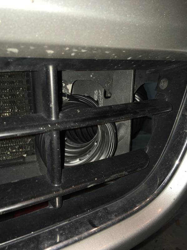

        While I wait for my new tank to come in - Decided to fab up some additional cold air routing to the K&N.
        If anyone wants additional details on it I can share, tube is from "Spectre" at advance auto - surprisingly worked very well. I did something like this on my gen1, and it worked very well.
        Inner edge of the bumper is roughly 2.5" from the mounting tabs on the rebar. I made sure to secure the hose to the rad shroud with this dimension in mind. Zipties around the hose and through the mounting holes on the rebar, along with the tight tolerance of the hole I cut in the shroud - keep the hose in place.
        Once the bumper is on
        Flange mounted under the airbox panel, with two M6x1.0 bolts and nylon washers to keep the flange spaced and secure.
        from above
        Hopefully this will bring some more fresh air to the intake.

        New tank arrived, so I went to fill her up last night after installing it and running a traditional worm clamp on that back hose (what a pain to get to to, btw). Per the fill/bleed instructions, I opened the engine fill and degas, and began filling at the degas, i was so concentrated on watching my pour that I didn't realize coolant was coming out of the engine fill location until it was too late. A good amount of coolant poured all over the front of the motor. Based on the instructions in the repair manual i was anticipating filling up the degas, then moving over to top off the engine fill before turning the car over and letting it warm up.
        Did I miss something?
        I am getting a new belt today, as the old ( 4 months old, ugh) belt got pretty wet with coolant (among other things, but I think the belt is the only item i Need to worry about). I have to wipe down some other parts so I dont mistake them as a future leak. I hate cleaning up coolant.
